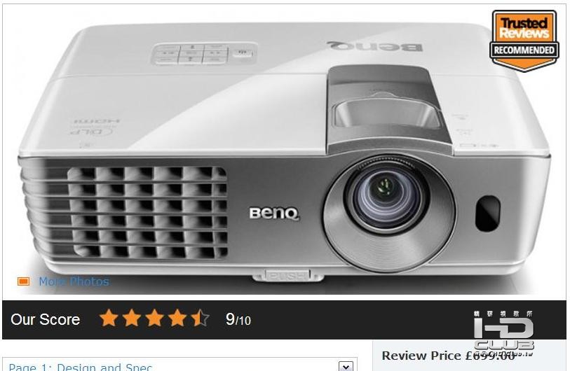

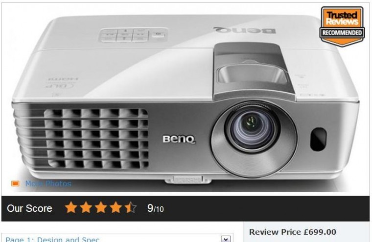

BenQ W1070確實是一台"俗又大碗"的力作,3D效果有DLP強力背書自然不在話下,2D畫質在DC3與玻璃鏡頭加持下也有超越同級機的素質,難怪會被英國專業3C影音網站Trusted Review評為"推薦購買機",整體得分獲得9分(滿分10分), CP值更是爆表的10分!
以下是評論總結:
"we were left with pictures from the BenQ W1070 that comfortably surpassed our expectations, making it just the latest entry on a freakishly long list of 2012 projector bargains. People on the hunt for an exceptionally cheap but still movie-loving projector have never had it so good."
W1070的畫質很輕鬆地超越我們對它的期待,也成為2012年一大堆超值投影機中最新銳的機種。有意購買入手容易但不願在觀賞電影畫質有所犧牲的買家,不能錯過這台超值的投影機!
http://www.trustedreviews.com/be ... w#tr-review-summary
