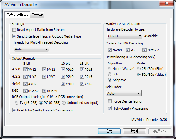

 樓主| 發表於 2011-9-30 15:23:01 | 顯示全部樓層
更新至LAV Filters 0.36
這次的更新算是蠻重要的,所以再來介紹一下~
最重要的是LAV CUVID已經整合在LAV Video Decoder裡面了~
所以以後LAV CUVID不會再單獨發佈,請特別注意~
因為整合在一起,LAV CUVID不再支援DIVX/XVID的解碼(本來效果也不好...)
所以LAV CUVID以後只能解H.264 VC-1 MPEG-2這三種主流的格式而已~
其他的解說就請諸位自行看下面的說明了
LAV Video
- Integrated NVIDIA CUVID Hardware decoder
- Performance enhancements in 10bit decoding
- Support for Flash Screen Video (FSV1)
- Support for Apple ProRes
- Improved MPEG-2 playback
- Improved A/V sync with VC-1 and MPEG4-ASP
It was time to get this out for good. You can only do so much testing yourself, at some point you just gotta get it out there.
The biggest change in this release is obviously the integration of the CUVID decoder. To embed the decoder, LAV Video was basically rewritten to 80-90%, because it was initially not designed to support more then one decoder properly.
A big change like that always has the potential to break stuff, but also to improve things, so we'll see how it goes.
The CUVID decoder supports full software fallback for unsupported H264 profiles (the hardware only supports High Profile, which means 4:2:0 8bit), as well as 4:2:2 MPEG-2. You can however not use another software decoder when CUVID fails, but seriously who would want that?
In addition to porting the existing CUVID functionality, there is a new option called "Force Deinterlacing", which will force the deinterlacer to process all frames, even if marked progressive. This can be used to deinterlace videos that were encoded as progressive but actually are weaved interlaced fields.
Note that LAV CUVID will basically be discontinued now, all its functionality is available through LAV Video. Only missing is MPEG4-ASP decoding through CUVID, but i don't believe the extra effort is really worth it.
Anyway, have fun with this release, and report bugs and regressions!

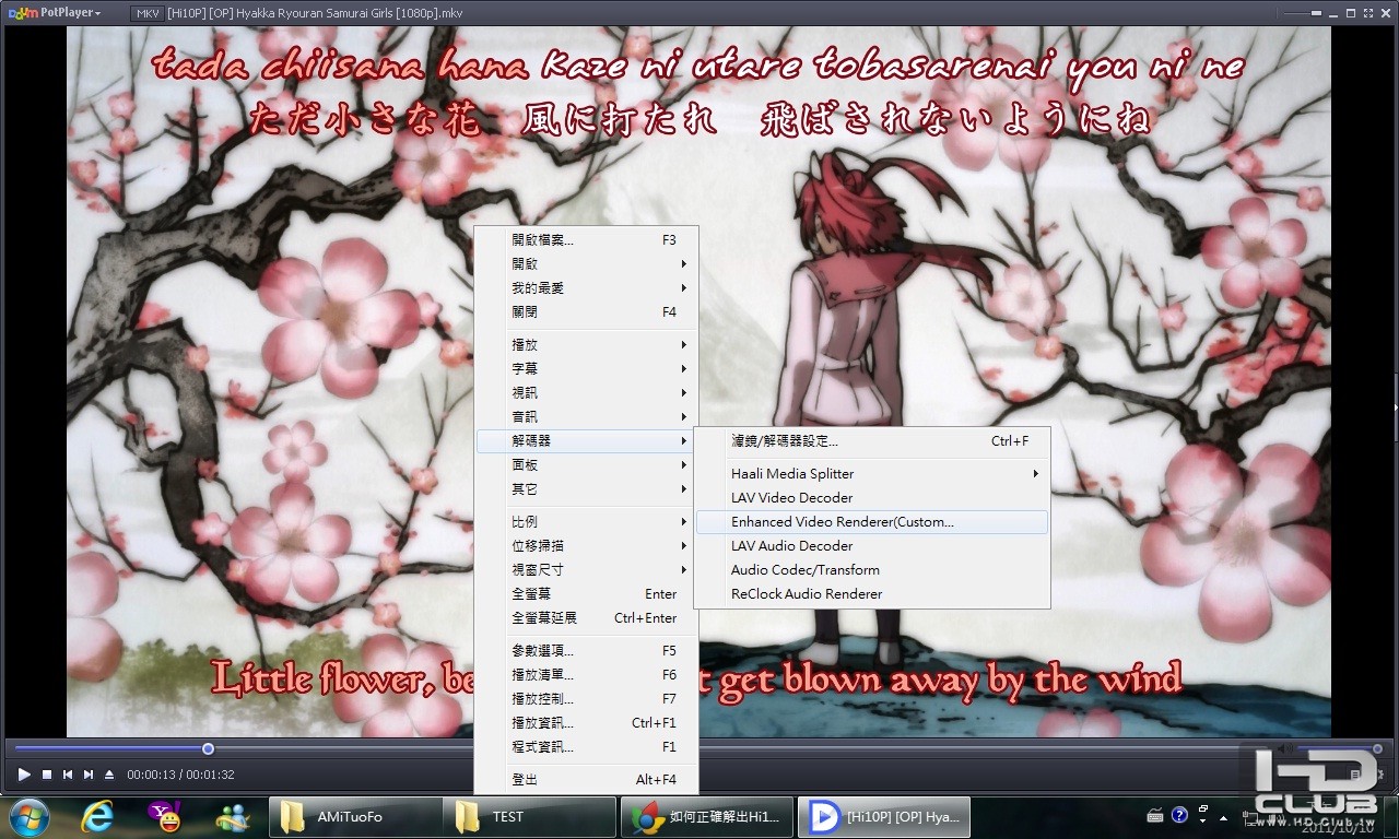

發表於 2011-10-1 18:57:47 | 顯示全部樓層
本文章最後由 lcping 於 2011-10-1 19:09 編輯
我是外行人
看了一頭霧水
照圖試設定 播放看看
可以播~~~

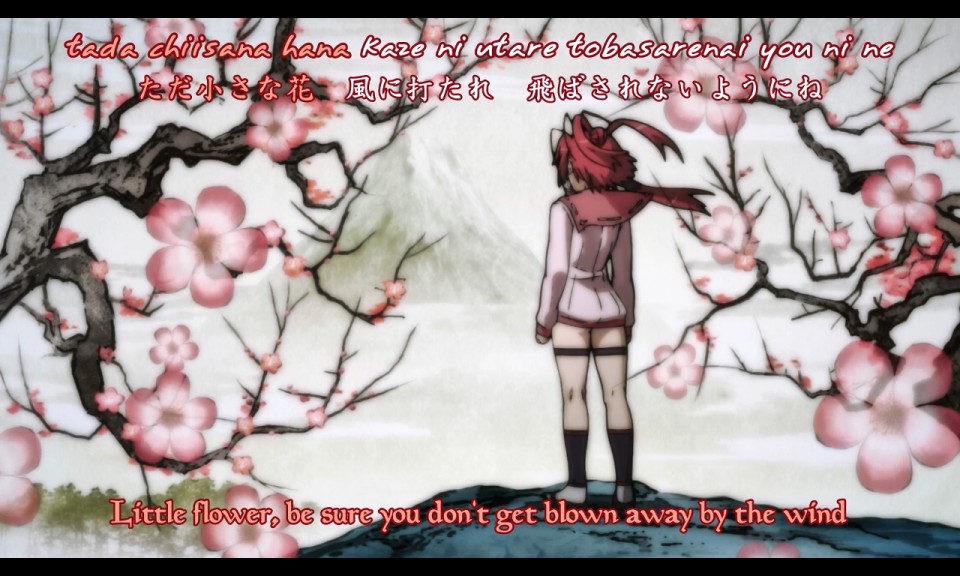

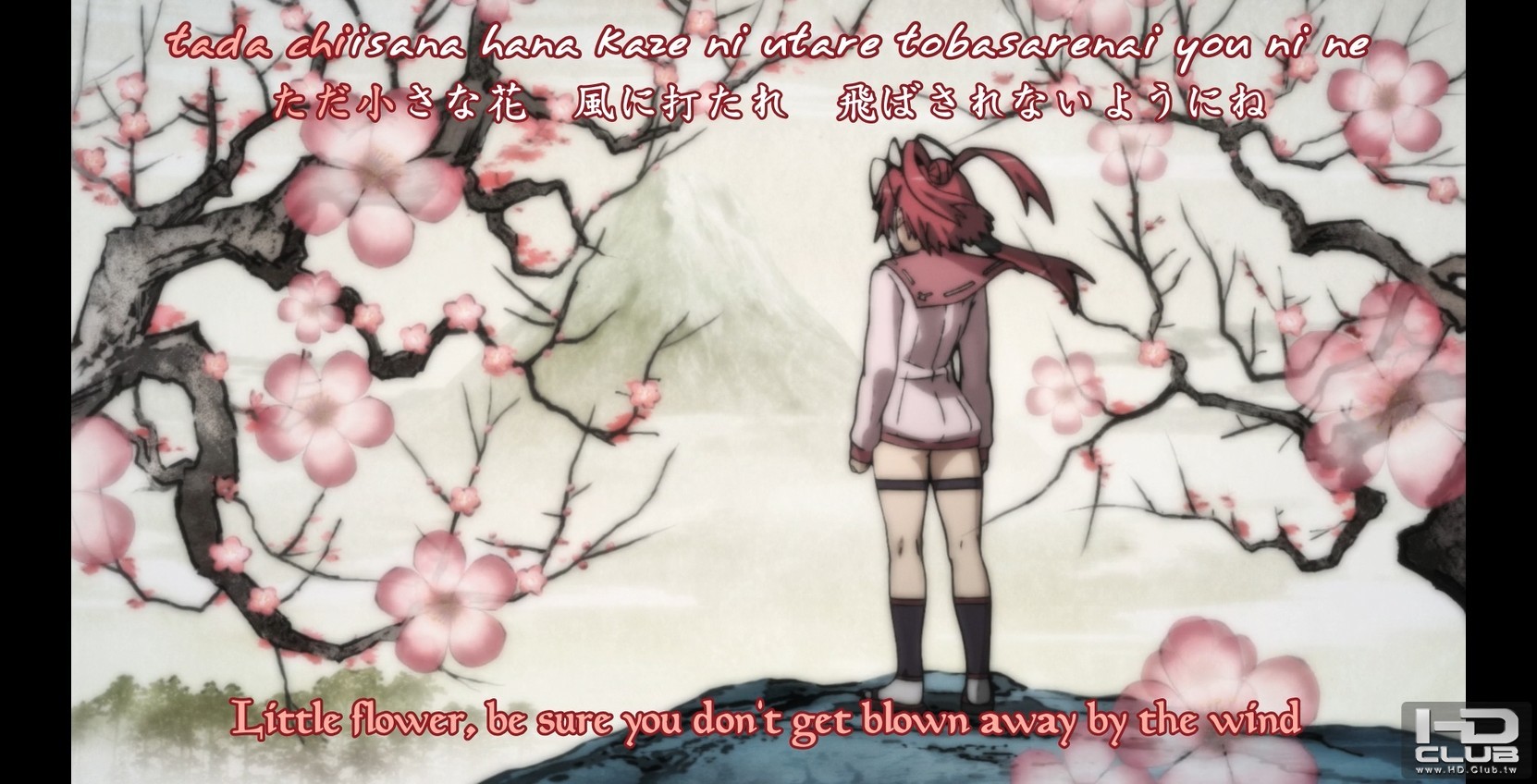

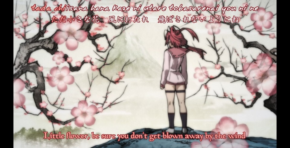

發表於 2011-10-8 09:47:45 | 顯示全部樓層
剛剛也測了版大放上去的測試影片
不過我的顏色和你不一樣  XDD
均使用mpc-hc + Lav 0.37
EVR
EVR
  EVR 自定
MAD
MAD
madvr
結果反而 EVR 自訂比較像版大的預覽圖,顏色也比較鮮豔
madvr 只有直接使用沒有做其他設定

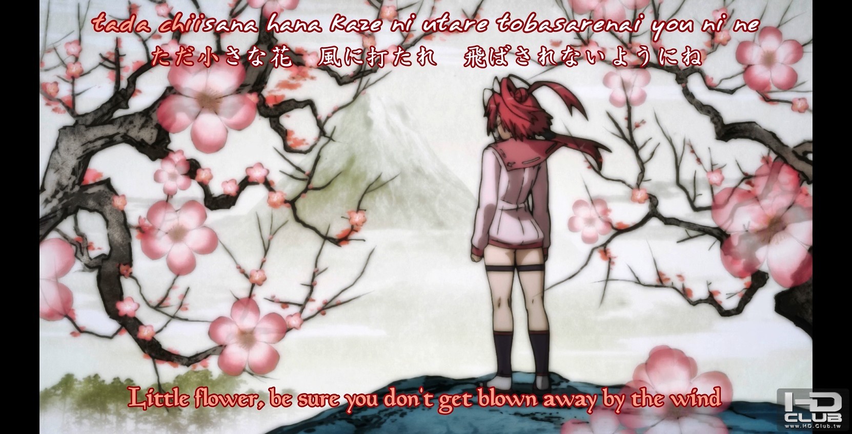

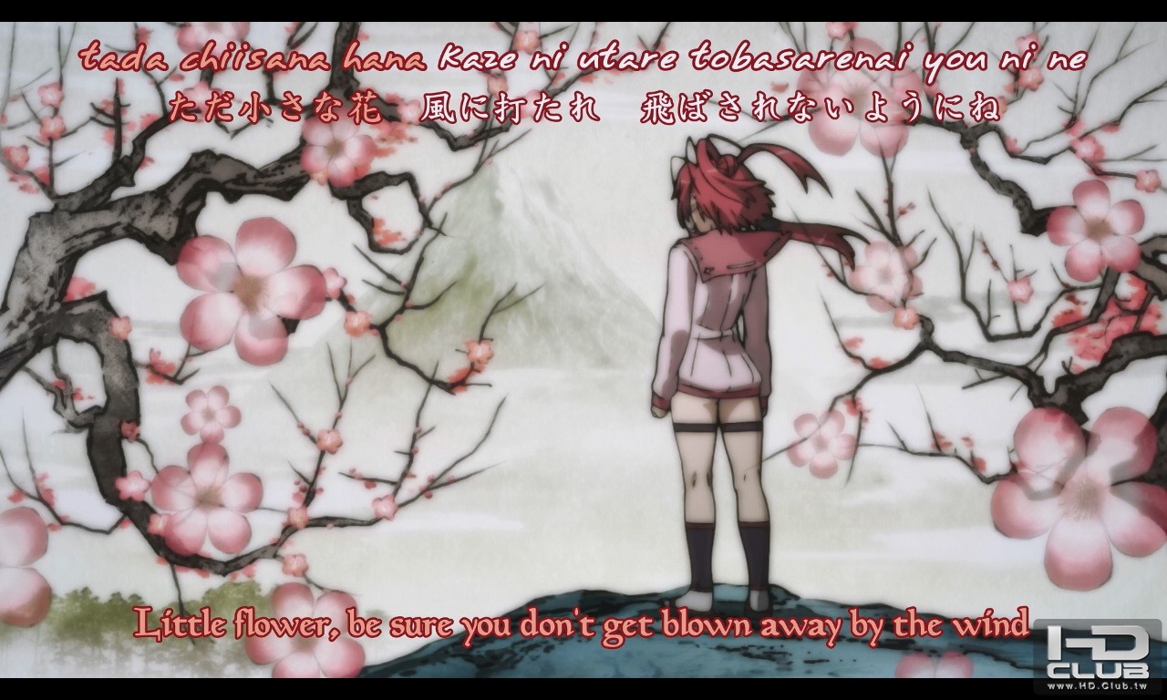

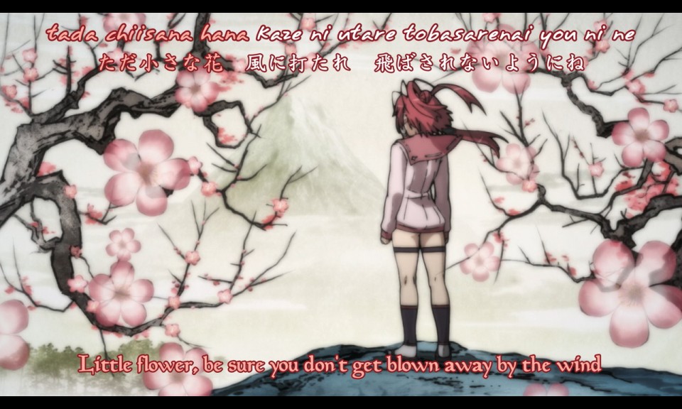

 樓主| 發表於 2011-10-8 15:09:30 | 顯示全部樓層
回覆 50# bluetank
我是用EVR C/P作渲染截圖沒錯啊XD
用EVR C/P 是NV12輸出~
會經過顯卡"動態範圍"的設定~
會覺得鮮豔是因為您的顯卡動態範圍是設定在0~255
如果將動態範圍調整至16~235的話~
EVR C/P的表現其實就不如madVR了~
madVR的渲染地位是無庸置疑的...
(備註:madVR作渲染是YV12輸出)
下面截圖提供參考
EVR(0-255)
EVR(16-235)
madVR

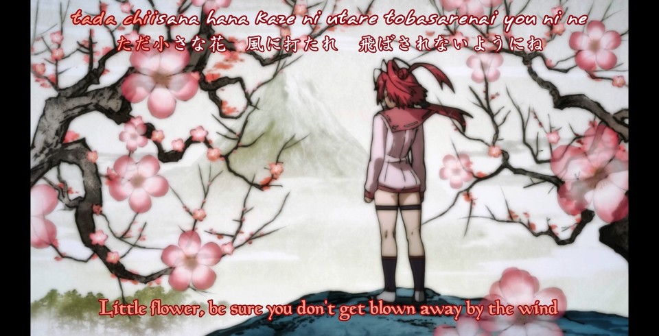

 樓主| 發表於 2011-10-9 18:44:02 | 顯示全部樓層
本文章最後由 pureland 於 2011-10-9 18:52 編輯
剛好上面談到madVR,所以稍微提一下它的優勢~
第一是高品質的chroma upsampling可以保留最多影像的細節~
第二是它可以使用比其他渲染器更高級的Resize運算法~
像是bicubic, mitchell, lanczos, spline等等~
直接看截圖可知madVR所保留的細節較EVR豐富許多~
最好親自測試才知道差別在何處~
madVR相關資訊與測試可至下列網頁參考:
http://forum.doom9.org/showthread.php?t=146228
http://www.vempx.net/article/292.htm
http://www.vempx.net/article/293.htm
madVR (SoftCubic100 Lanczos3 Lanczos3)
EVR C/P (0~255)

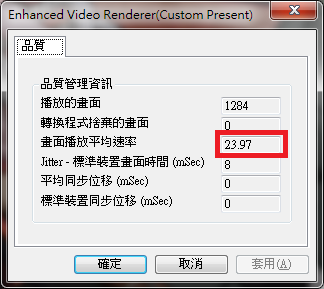

發表於 2011-10-10 11:54:34 | 顯示全部樓層
回覆 22# pureland
可以請問一下pureland大,
小弟在解鴨子走路時要如何得知自己的電腦是跑多少fps??(potplayer+LAV  Video Decorder)
發表於 2011-10-10 13:16:58 | 顯示全部樓層
原來是這樣  XDD
所以要懂得設定madvr才會比較好吧?
目前我木眼還是覺得evr c/p 比較好,應該是看習慣了   Orz
 樓主| 發表於 2011-10-10 13:22:07 | 顯示全部樓層
回覆 53# masonhung
影片播放時在任意處點擊右鍵,選擇解碼器,EVR C/P
紅框內的數字就是你目前跑此影片的fps

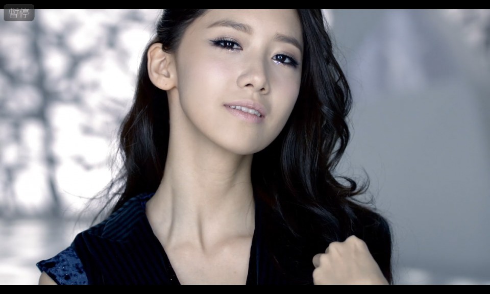

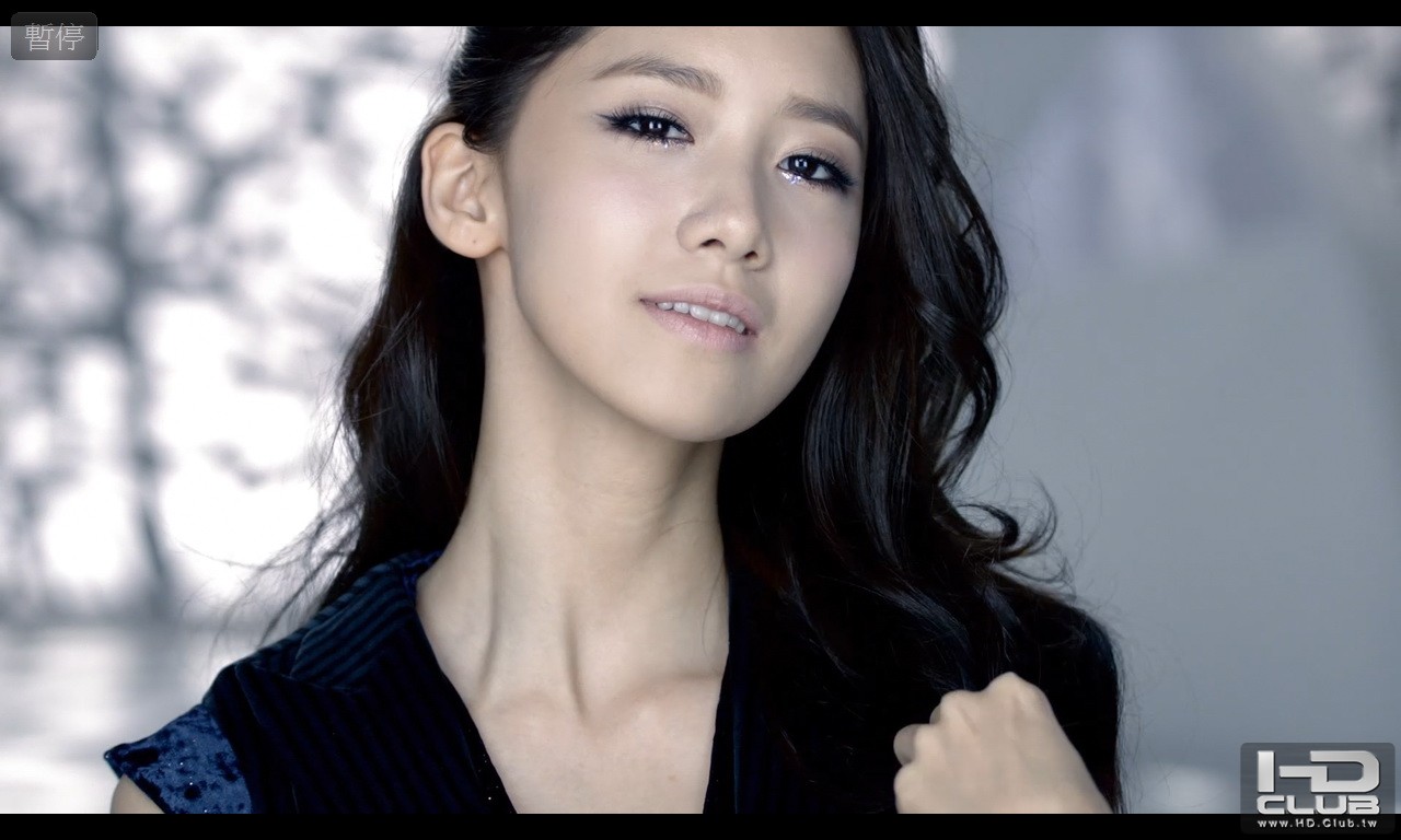

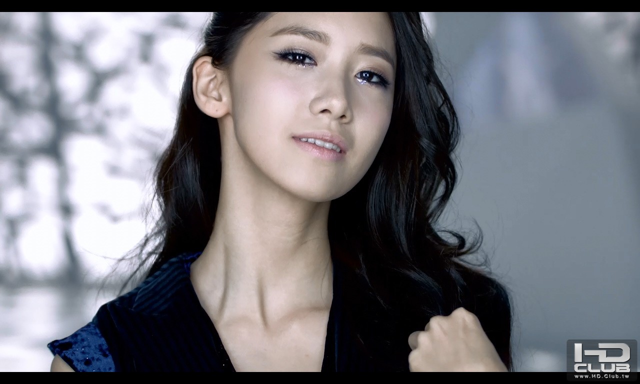

 樓主| 發表於 2011-10-20 17:10:17 | 顯示全部樓層
剛剛用了少女時代新歌MV來測試渲染器之間的差別~
提供簡單的截圖作為參考~
孰優孰劣就自行比較吧,多說無益...
madVR
EVR C/P
