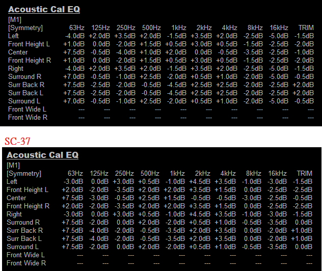

SC-57 DAC 與 OPPO-95 一樣為 Pro 32bit => 有誤請專家更正
SC-57  第一次量測 data (上圖) vs SC-37 data (下圖), 可以看到存在誤差

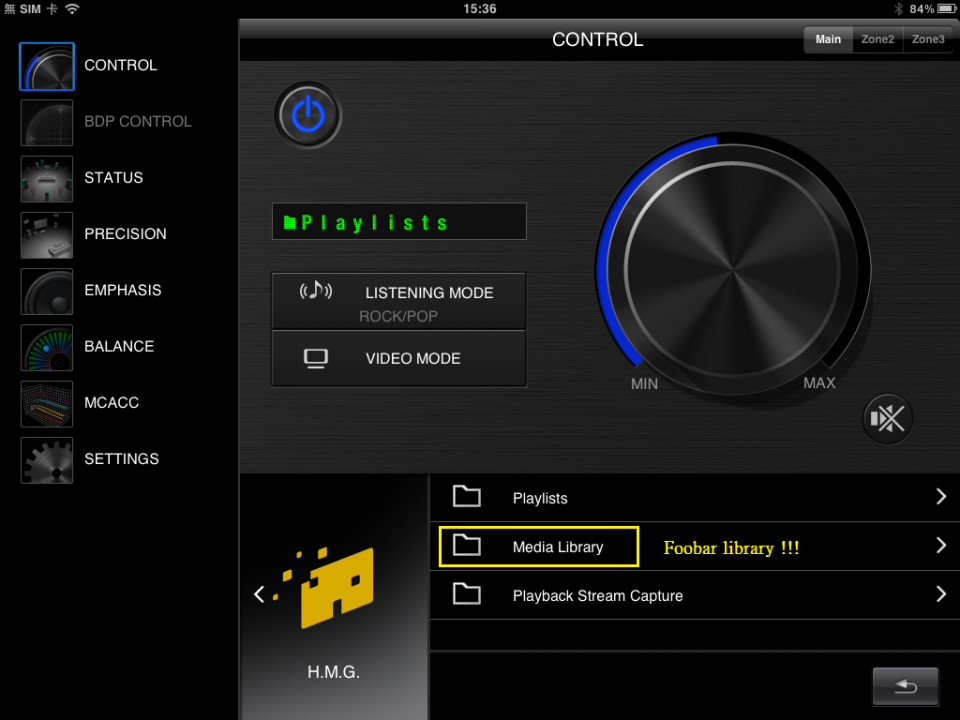

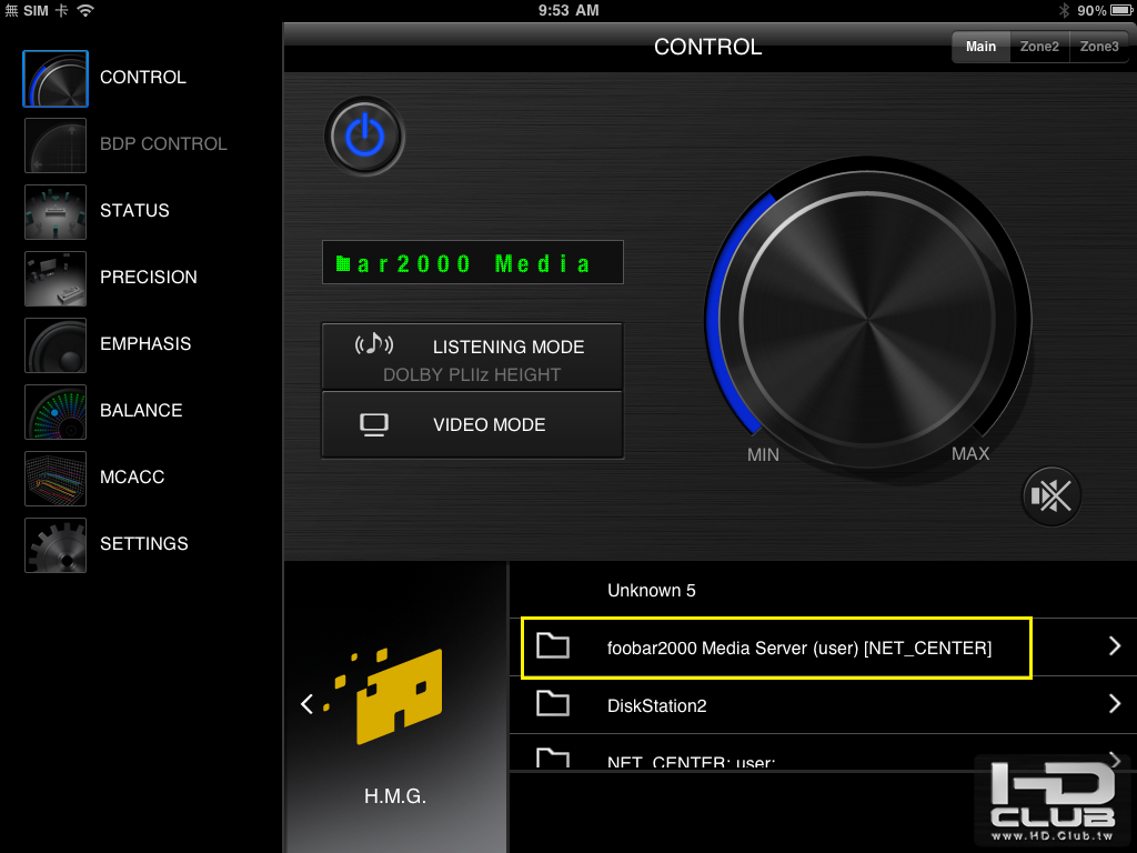

AVR DLNA 的多層目錄智能程度 自然無法和電腦 File manager 相提並論
User 需要一個高度整合的 Tree structure 音樂庫      e.g Foobar library 作為介面選單
大家知道 Foobar Library 多指向性, 可以控管多個 NAS 內 HDDs, 包括各式屬性的音樂檔 people stored by different genres

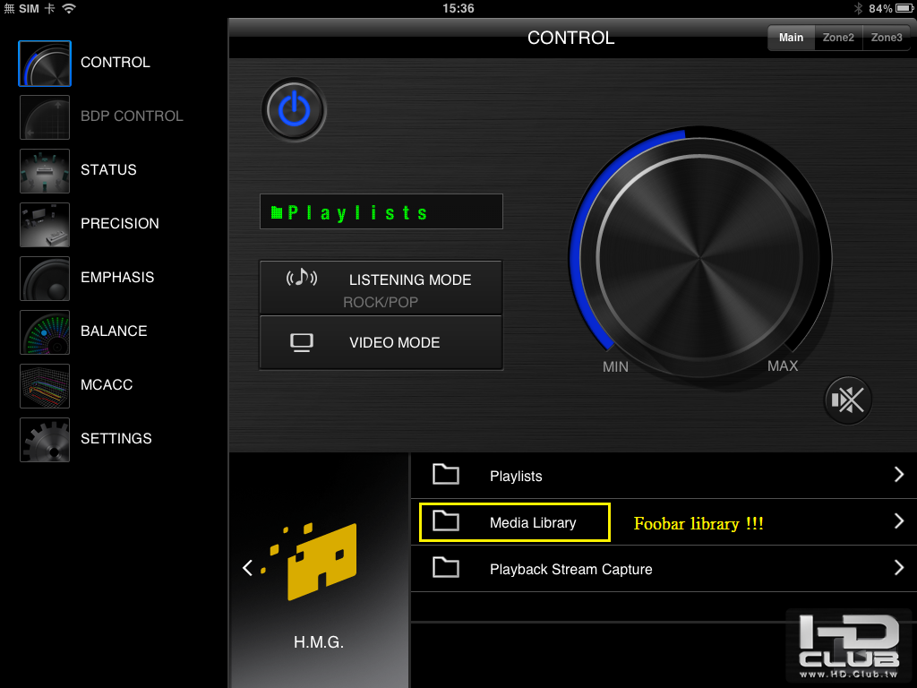

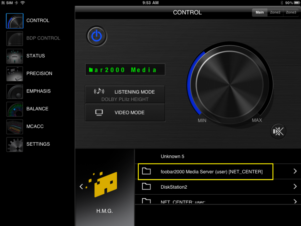

iControlAV2  連線到 PC Foobar Library  選曲立刻人性許多, much more organized than DLNA alone
其後透過  AVR listening mode 作後續音場,音量控制
That is 支援性包山包海的 Foobar/wasapi 作為 music player

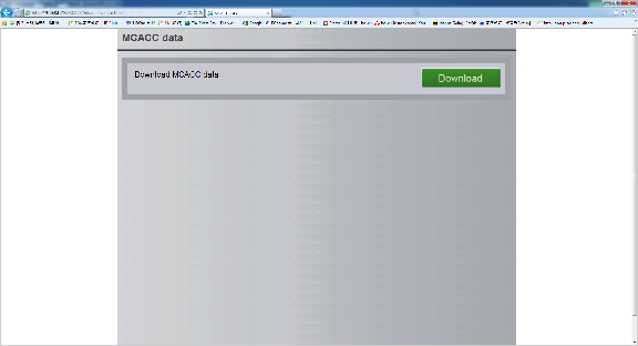

新款 SC-57 MCACC data output 不在 MCACC 主選單上
須從 PC Network 上  Device SC-57 下載  (見圖)

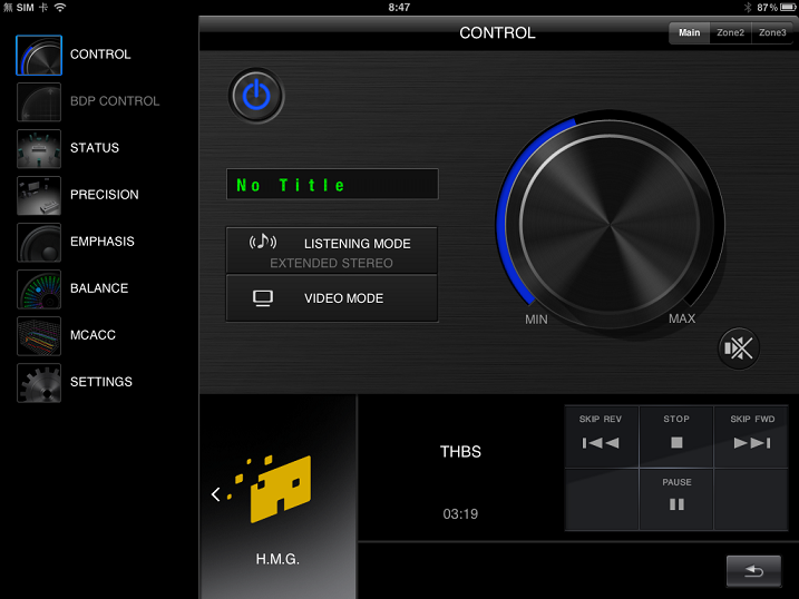

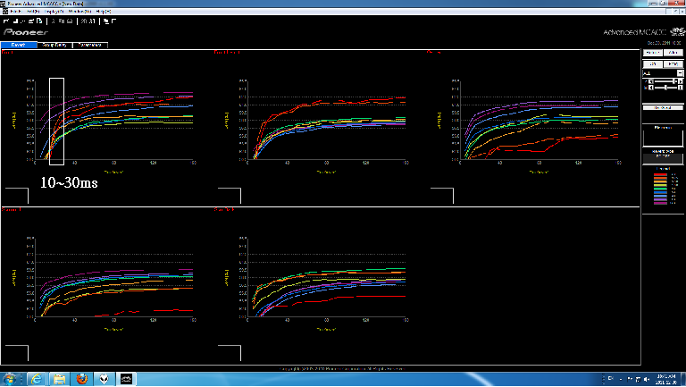

SC-57 measurement shows the reverb from all channels arised drastically after 10~30ms
So 宅爸 set the filter on this time frame to minimize the reverb
Next try on the Web radio, THBS 音質優 (320k bps) is one of 宅爸's favorite station.
Extended stereo mode  提供極佳的包圍感  是多聲道優點之一, 適合當作背景音樂.

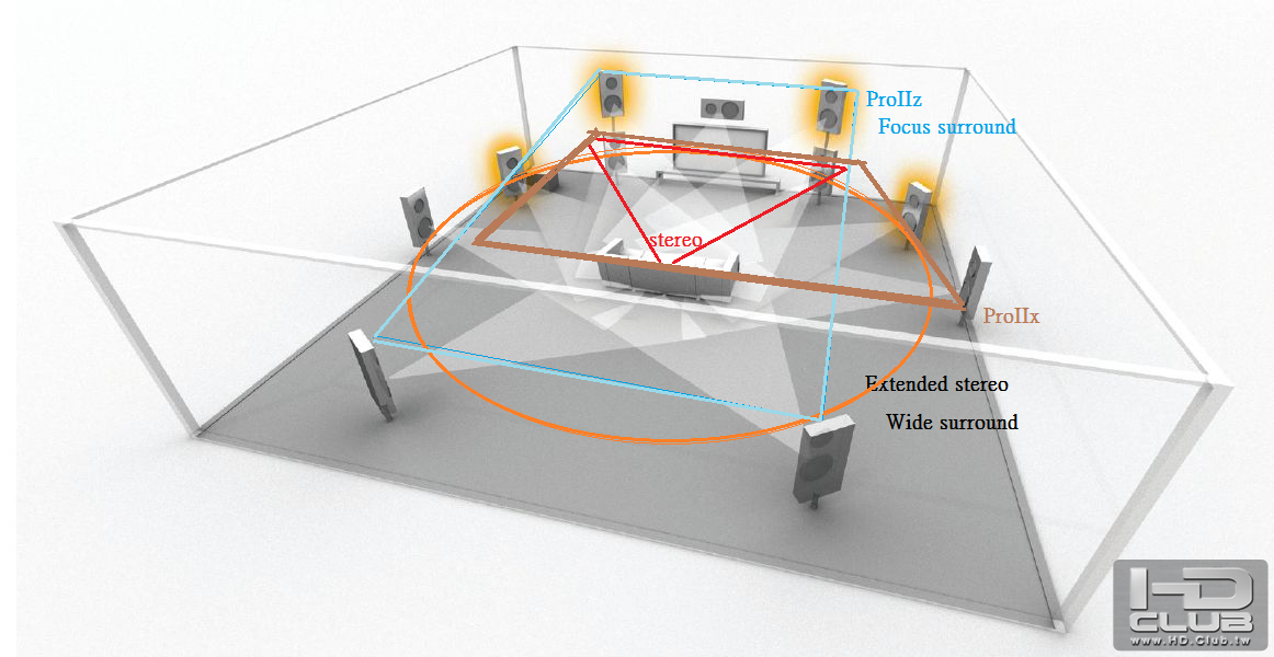

一支電吉它 solo 可以從兩側跑到前方,前上方,再繞回來  包圍感奇佳無比 !
圖示一下 多聲道音場
AVR DSP 音場變化不斷精進, 已非昔日阿蒙 "罐頭音效" , 也是一個日趨成熟的科技
喇叭科技也在進步, 小體積, 快速,敏銳 ,更能融入裝潢 免除 業主 為了多聲道 牆壁掛幾顆大箱子的為難

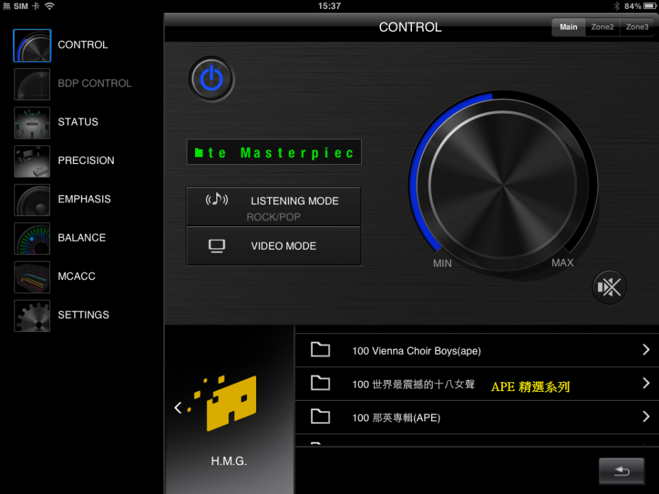

哈拉上網, 電腦當然開著, 此時順便打開 Foobar then 不用理它 !
personalize 音效輸出要設成 AVR
讓 Foobar 自動作為 AVR 外掛 Player
平日各位若已規劃好 各顆硬碟分類     e.g  Flac 一顆, wav 一顆, ape 一顆 ..... etc
統一交給 Foobar library 代勞, 成為主目錄

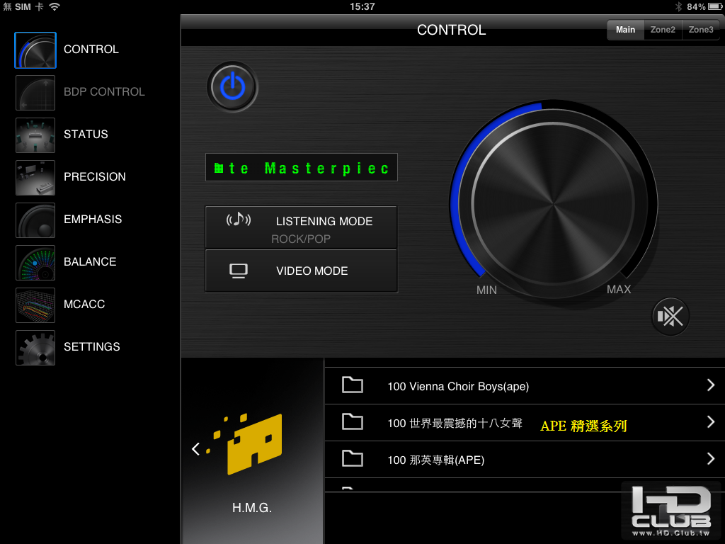

APE 精華區  AVR/WMP 沒支援 ?   Foobar 不怕 !  盡量放 !

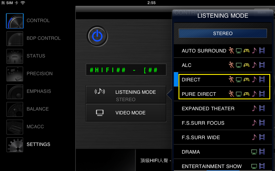

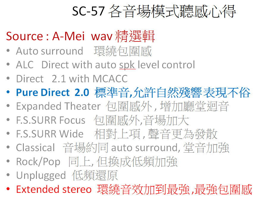

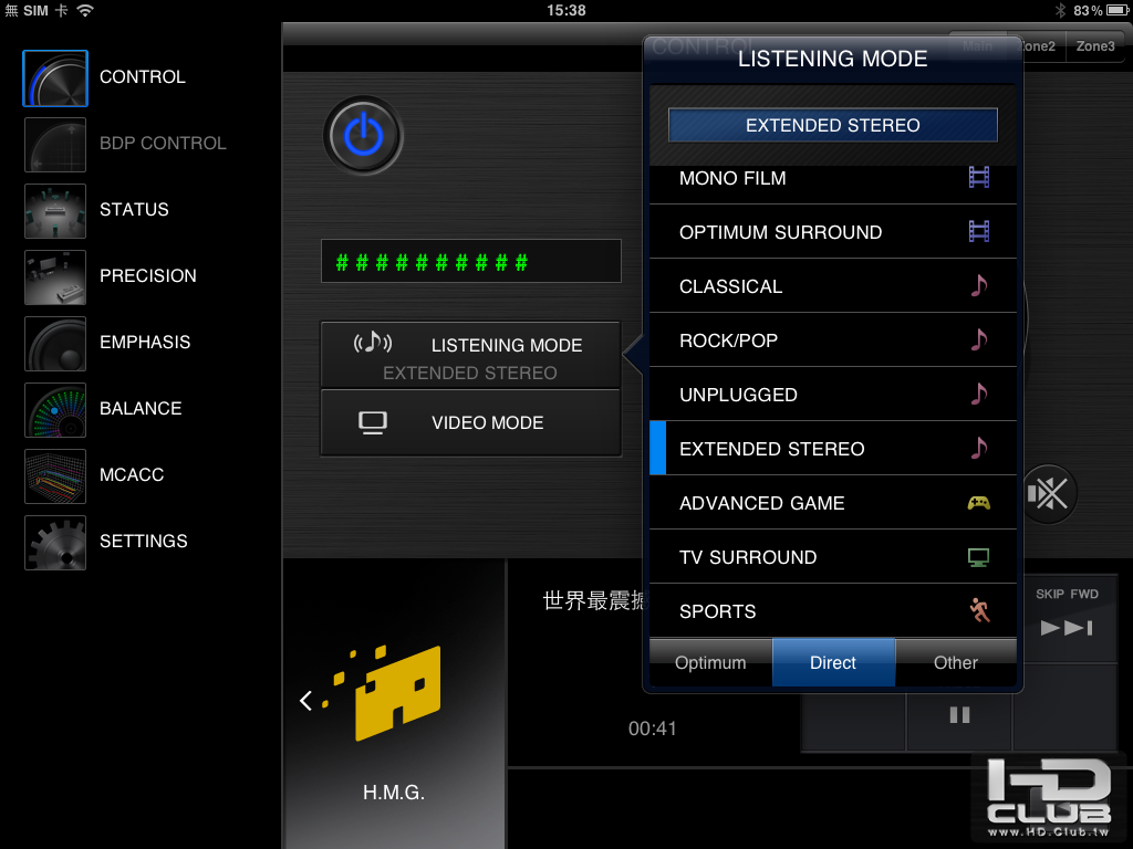

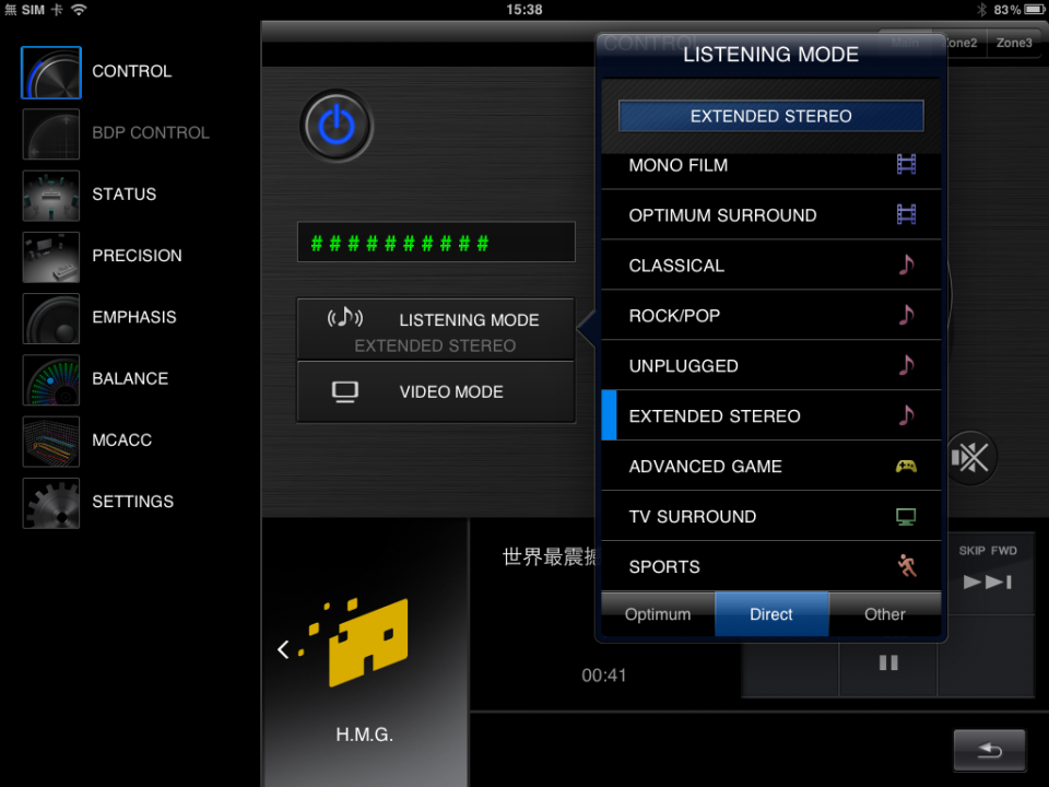

AVR 的音場選單 => 多試多比較, 找出適合府上空間的音場

Why the extended stereo mode sounds so well  ?   much better than ProIIz  mode 宅爸 used to listen before.
It's true !  the human hearing do favor the sound from the front hemisphere
The extended stereo link the Sides with Mains to give a broader listening experience
And the answers from Audyssey second it as well
Audyssey says that the most helpful enhancement is width, followed by height, followed by back-surround. In theory, all three can run simultaneously. If manufacturers follow through with 9.1-channel AVRs, which Denon has hinted at doing, you'd have a choice of two out of the three.
Why width? Audyssey says: “Research in human hearing shows that we can hear many more directions than what current systems provide. Experiments have shown that human localization is better in front than to the sides or behind. This means that for front-weighted content such as movies and most music, good engineering dictates that we employ more channels in the front hemisphere than the back. Imaging is also better horizontally than vertically, and so good engineering also dictates that channels must first be added in the same plane as our ears before going to higher elevations.”
Pure Direct 模式 (純兩聲道)  AVR 關閉 MCACC & cut the signal to Subwoofer
vs
Direct 模式, MCACC & 2.1 輸出, 只消關閉 subwoofer, 則為 2.0+MCACC
相鄰兩個選項, User 可以快速切換 & 對照 enable/disable MCACC 聽感的差異
宅爸以 Tracy Sad eyes 低頻動態頗大的單曲測試
With MCACC, filter effect 讓動態稍稍縮減  bass punch 會減弱,少了此曲的韻味
建議喜歡 原汁原味的 stereo 樂迷 適度關閉 MCACC and use foobar player
兩聲道 蠻不錯聽的 !

Pure 2.0 vs  MCACC 2.1  利用同一首歌, 快速切換對比
1. Pure 2.0 高頻若較亮, 表示有殘響, 修正過殘響的 MCACC 高音會稍暗
   此處不必苛求完美, 以喜歡的聽感為主
2. 兩者低頻聽感若極為類似 表示超低音調整的不錯,銜接成功 ; 反之則 SW 仍太轟
    若主聲道近 small 低頻延伸力不足, 不必強求, 可照喜好維持 Boomy sound 助陣
   按 : 一般樂曲 多無超低頻 ( < 33 Hz) 特效.

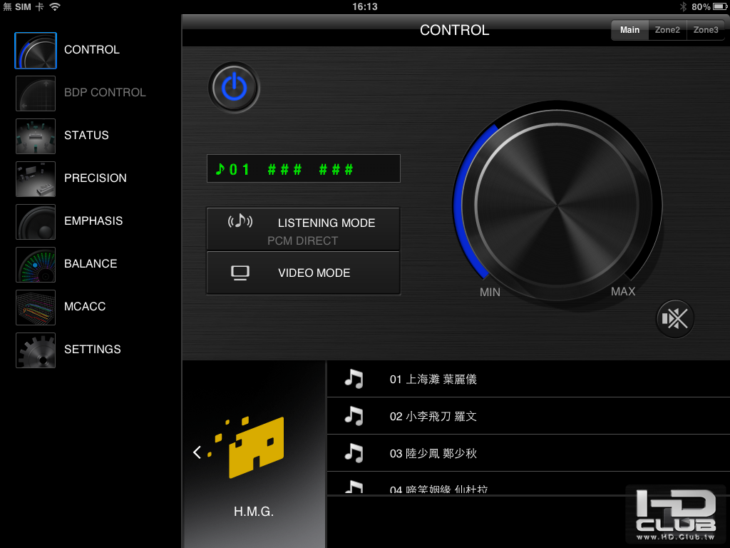

 樓主| 發表於 2012-1-11 00:23:03 | 顯示全部樓層

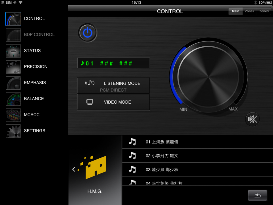

記得 M01 有位網友分享了 5,6 年級黃金港劇主題曲
宅爸終於找到這四張專輯, 放入 NAS Library
數位流不但 迎新 而且 懷舊
