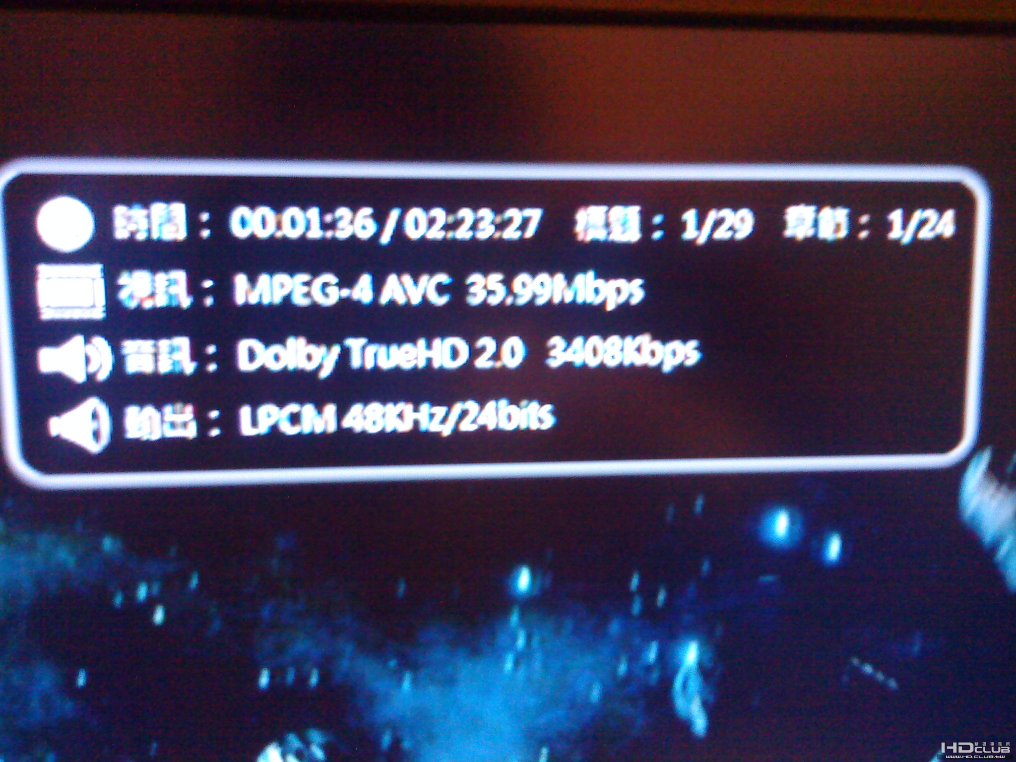

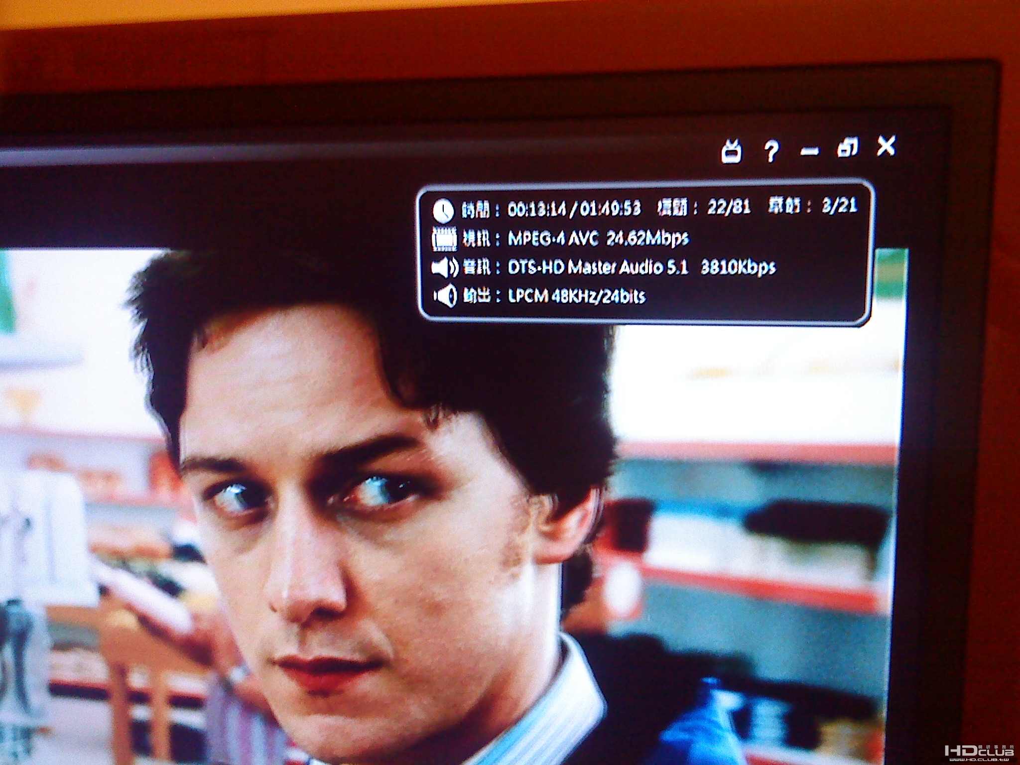

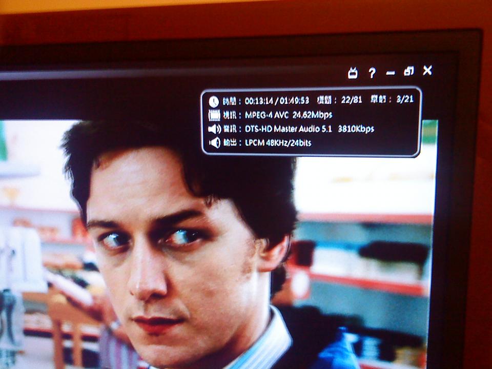

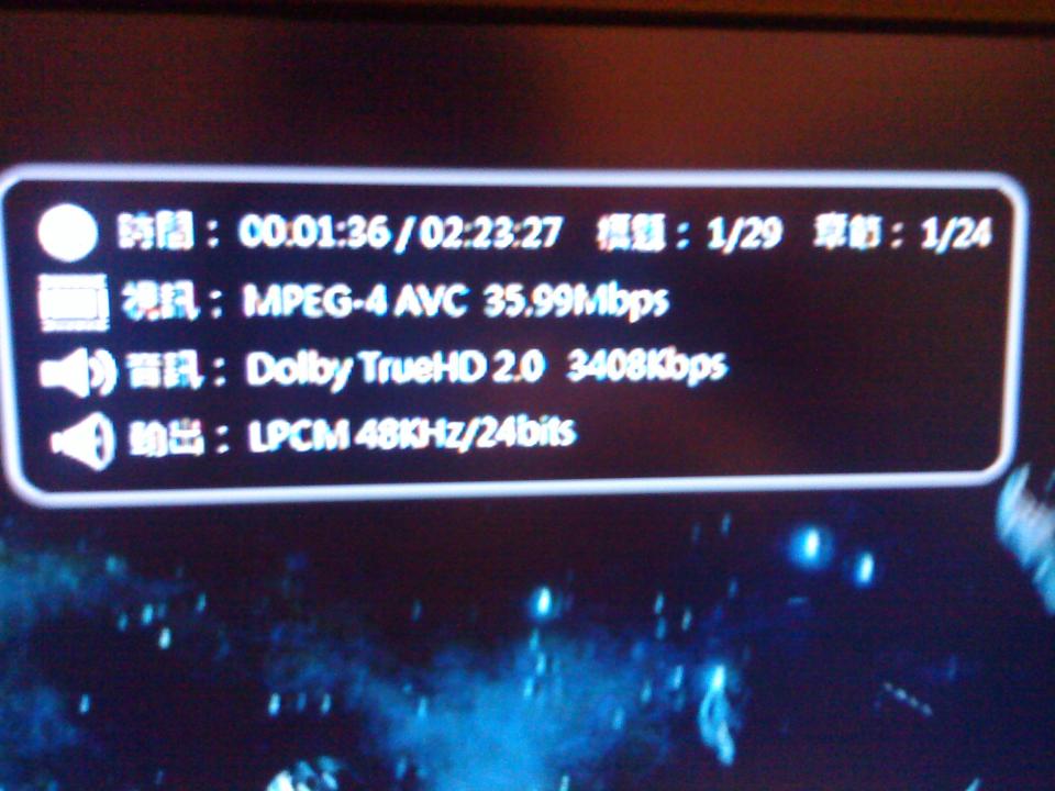

Hello!, I want to share my experience.
Hardware : ATI 4350 + Asus M2A-VM (690G) + Onkyo 605 (all thru HDMI)
Software : Vista SP0 + PowerDVD 9 deluxe (select HDMI & PCM)
Driver : ATI 9.2 + Realtek ATI audio 2.19
Transformers : Dolby true HD 5.1 will downgrade to Dolby true HD 2.0 : LPCM 48kHZ / 24 bits
Wanted : DTS-HD Master 5.1 : LPCM 48kHZ / 24 bits
Wanted : DTS 5.1 : LPCM 48kHZ / 16 bits
The difference of sound effect is big between 16 bits & 24 bits when I set the volume in Onkyo 605 the same at "55".  I think 24 bits / 96kHZ will be much better if use HDAV1.3 sound card.
