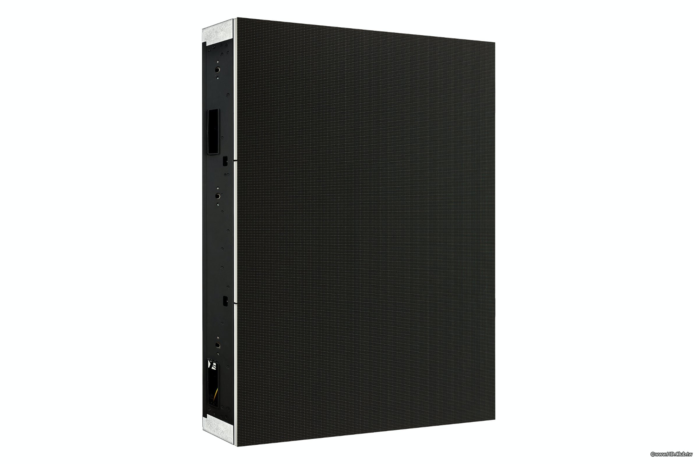

LG LED Cinema - technical specifications
Optical Parameter
Pitch        3.3 mm
LED Type        SMD
Pixels per LED Module        8,640
Aspect Ratio        64 : 90 (per Cabinet)
Resolution        192 × 270 (per Cabinet)
Pixels        51,840 (per Cabinet)
Pixel Density        90,000 (per SQM)
Visual Viewing Angle (Horizontal/Vertical)        120º, 120º
Color Depth        12 Bit (DCI-compliant)
Chromaticity Uniformity        In case of White : Within ±0.015 x, ±0.015 y
Color Temperature (White)        (x. y) = (0.314, 0.351) / DCI-P3 Theater
Color Temperature (R, G, B)        DCI-P3 theater
R: (x. y) = (0.68, 0.32)
G: (x. y) = (0.265, 0.690)
B: (x. y) = (0.15, 0.06)
Contrast Ratio        4000 : 1 (Minimum)
Brightness(After Calibration)        48 nit (DCI-compliant)
Color Gamut        DCI - P3 (DCI-compliant)
Video Frame Rate        24 Hz, 25 Hz, 30 Hz, 48 Hz, 50 Hz, 60 Hz
Lifetime        100,000 Hours (LED to Half Brightness)
Operation Hours        16 Hours per Day / 7 Days per Week
Physical / Electrical Parameters
Modules (per Cabinet)        6 (2 × 3)
Dimension (LDM)        320 mm × 300 mm
Dimension (per Cabinet)        640 mm × 900 mm × 124 mm (Including Handle)
Dimension (4K, Total)        14,080 mm × 7,200 mm (101 sqm)
Dimension (4K, Active Area)        13,653 mm × 7,200 mm (98 sqm)
Weight (per Cabinet)        15 kg
Weight (4K, Total)        2,640 kg
Material of Cabinet Body        Aluminum
Heat Generation (per Cabinet)        221 BTU (Max.) / 73 BTU (Typ.)
Serviceability        Rear only
Power Supply        AC100-240 V ~, 50/60 Hz
Power Type        Built-in Power
Power Consumption (Max, per Cabinet)        90 watt (Main) / 52 watt (Secondary)
Power Consumption (Max, 4K)        9,260 W
Certification        DCI, CB, CE-LVD/EMC, FCC, ETL/UL, RoHS, REACH
Supported Media Server        Dolby IMS3000
Interface        RJ45
Operation Temperature        0°C to 40°C
Operation Humidity        10% to 80%
Storage Temperature        -20°C to 60°C (-4°F to 140°F)
Storage Humidity        5% to 85%
