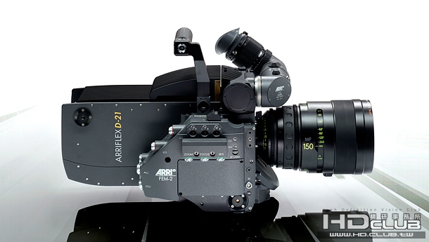

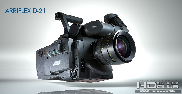

隨著數位技術的演進,數位35mm電影已經是不可阻擋的趨勢,繼Sony發表自家的F35旗艦35mm數位電影攝影機 及RED發佈下一代5K的EPIC 35mm數位電影攝影機之後,電影界和Panavision並列的另一大巨頭德國ARRI也發佈了自家的新款全幅數位電影攝影機 - D21
ARRIFLEX D-21 The Film Style Digital Camera
The ARRIFLEX D-21 combines leading edge digital technology with film camera features that have been refined over ARRI’s 90-year history. It allows directors and cinematographers to shoot in the same way as they would with 35 mm film, while taking advantage of the immediacy and economy of digital acquisition.
Through ARRI Imaging Technology (AIT), the D-21 produces brilliant images with a cinematic look and feel. D-21 images have a high dynamic range, high contrast and the most film-like color reproduction of any digital motion picture camera.
Incorporating a rotating mirror shutter, optical viewfinder and compatibility with existing film accessories, the D-21 is immediately recognizable as an ARRI camera and film crews feel comfortable operating it. Further film style features include variable frame rate and robust construction.
The D-21's single, Super 35-size CMOS sensor exhibits the same cinematic depth of field as 35 mm film and the camera's industry standard PL lens mount accepts the same unequalled variety of spherical lenses as used on 35 mm film cameras. Since the D-21 is the only digital high-end camera with a 4x3 aspect ratio sensor, it can make full use of anamorphic lenses.
The ARRIRAW format enables the D-21 to output raw uncompressed data. Alternatively – or simultaneously – the camera can output an uncompressed HD signal that works perfectly in the established HD infrastructure. With such flexibility, the D-21 easily adapts to a variety of production requirements and budgets.

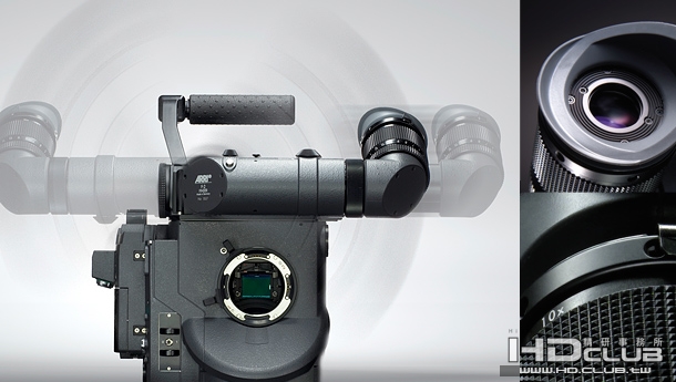

The Optical Viewfinder
While most digital cameras use electronic viewfinders, the D-21 is equipped with the same optical viewfinder as all other ARRI cameras. Thus the D-21 viewfinder always shows an image area larger than the image being recorded, and it can be used even when the camera is not powered up.
Light entering the taking lens is diverted by a spinning mirror shutter and generates a bright, magnified full color image in the viewfinder. This direct light path, free of any electronic image processing, ensures fatigue-free viewing as well as zero delay, a crucial feature when shooting fast action, where a delay of even a few frames can be very confusing. But even something as mundane as following a person getting up from a chair can become horrifying guesswork if the viewfinder images is delayed.
The D-21 optical viewfinder can be freely rotated, extended or flipped to the other camera side for comfortable viewing in any camera position An extension viewfinder, eyepiece leveler and a heated eyepiece are useful accessories in many shooting situations.

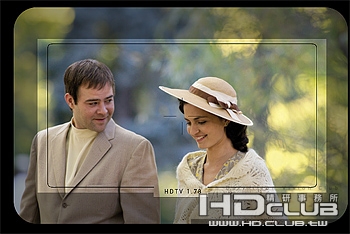

An optical viewfinder is the preferred choice of both cinematographers and camera operators. The clear, full color image enables accurate assessment of focus and facilitates precise and comfortable operating for complex camera moves.
Most crucial of all is the fact that an optical viewfinder shows an image larger than that being recorded and therefore allows the operator to see not just what is in frame, but also what is just outside the frame. This safety area permits meticulous composition and helps the operator prevent unwanted objects (such as a boom or microphone) from entering a shot.

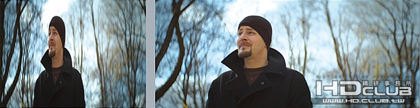

make full use of anamorphic lenses for the CinemaScope format.)現在我們看的電影其實長寬比要遠大於16:9,成為anamorphic片幅 也叫Panavision片幅,這種片幅最早被美國Panavision 發明並推廣,成為業界標準,甚至這家公司也因此片幅而命名Panavision)
The image, as recorded by the D-21 A simple 2:1 stretch in post results in a CinemaScope format image.
with an anamorphic lens.
左邊為CMOS通過anamorphic鏡頭 的原始圖像,右邊是採用anamorphic變換回來的超寬螢幕圖像

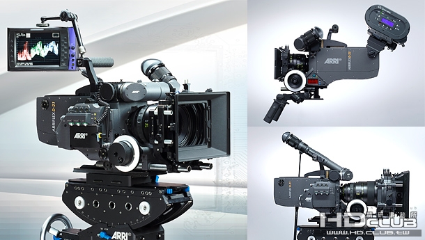

The D-21 is a true ARRI camera; it runs silently and has the same robust construction and ergonomic design ARRI cameras are famous for. Its controls are also simple and straightforward for fast and safe operation.
The D-21 is also compatible with a broad selection of film accessories. Mounted on a standard sliding baseplate, the D-21 shares matte box, support rod and follow focus options with the ARRI 35 mm film cameras.
The extensive range of available accessories allows the D-21 to be configured for any style of shooting. A studio etup might involve a production matte box and follow focus, extension eyepiece with leveler and a heavy zoom lens, while a stripped-down setup would permit handheld or Steadicam shooting.

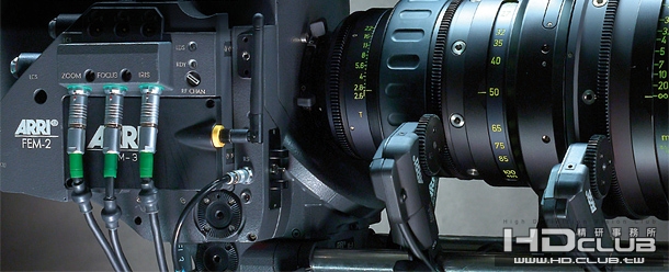

The FEM-2, a Functional Expansion Module that attaches to the side of the D-21, houses a built-in radio module for lens and camera control with the ARRI Wireless Remote System (WRS). It also contains motor drive electronics that allow the ARRI Controlled Lens Motors (CLM) to be plugged directly into the D-21, minimizing the number of boxes attached to the camera.
The D-21's modular system architecture allows upgrading when advances in sensor, electronics or firmware technology become available, thus ensuring a long product cycle for the camera.
Lens motors plug directly into the FEM-2 portion of the D-21,
which can also accommodate the Universal Radio Module URM-3 for wireless lens and camera
