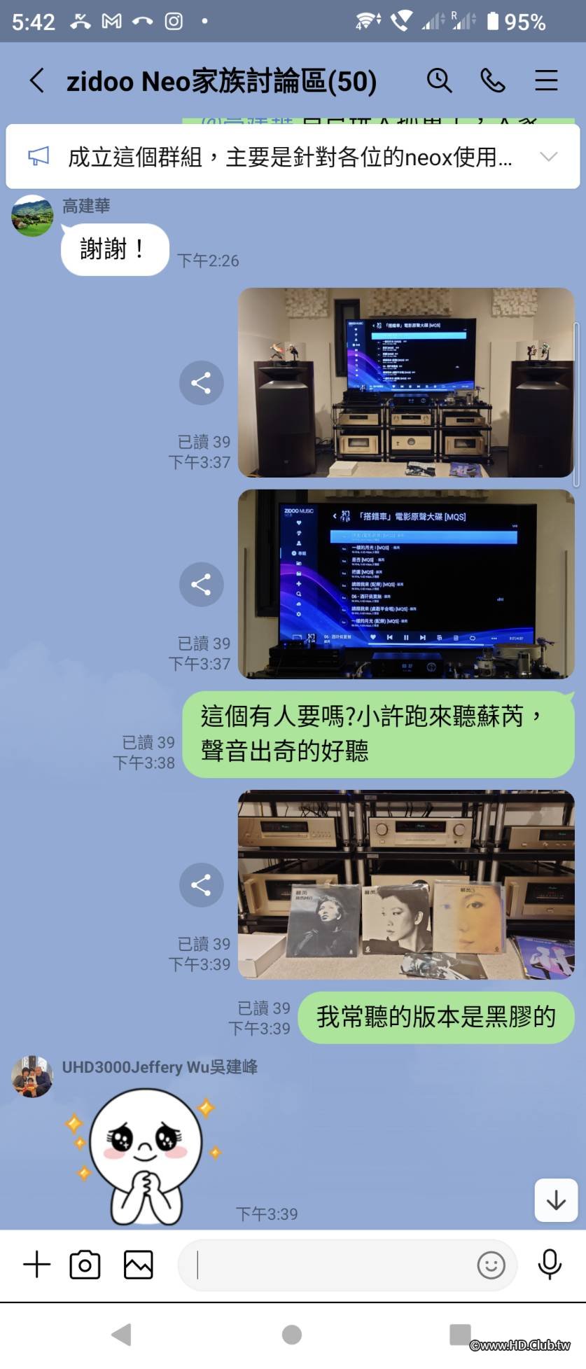

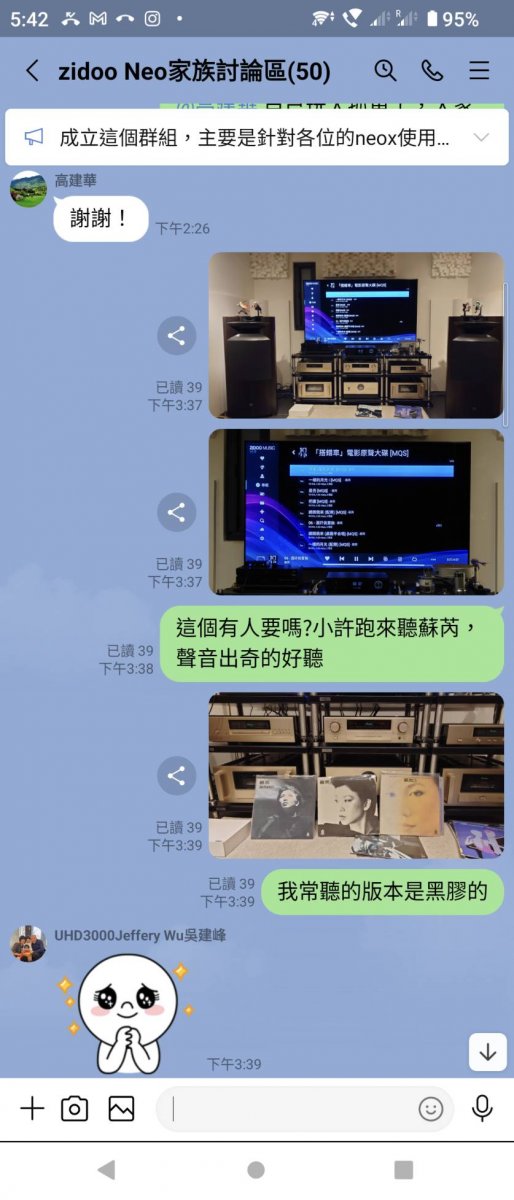

發表於 2022-7-21 05:40:36 | 顯示全部樓層
Until now, we have more than 50 users here
https://www.hd.club.tw/thread-281575-1-1.html
There is also an app that Taiwanese are more accustomed to use: LINE
