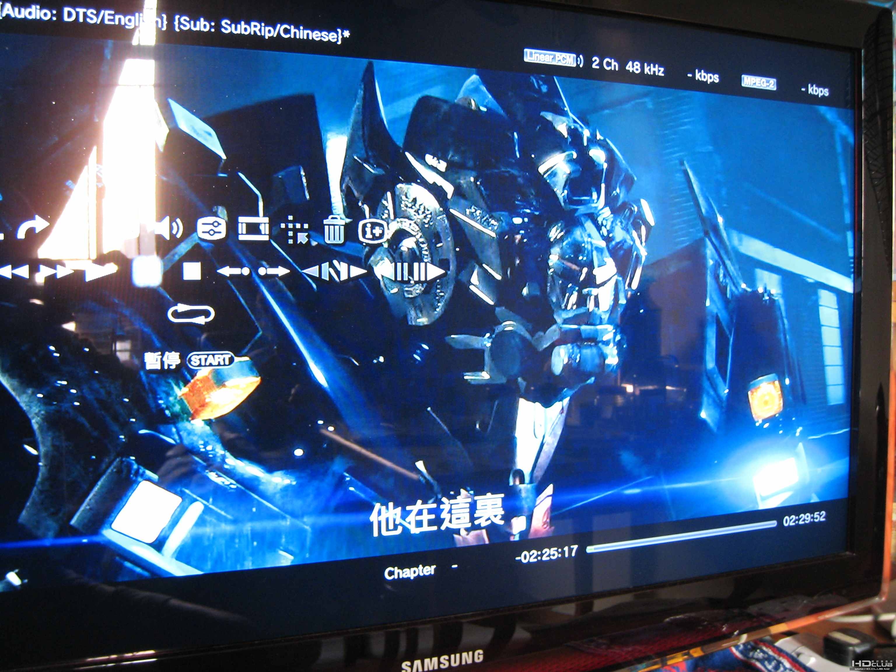

mkv file on LVDTV
mkv file on LVDTV

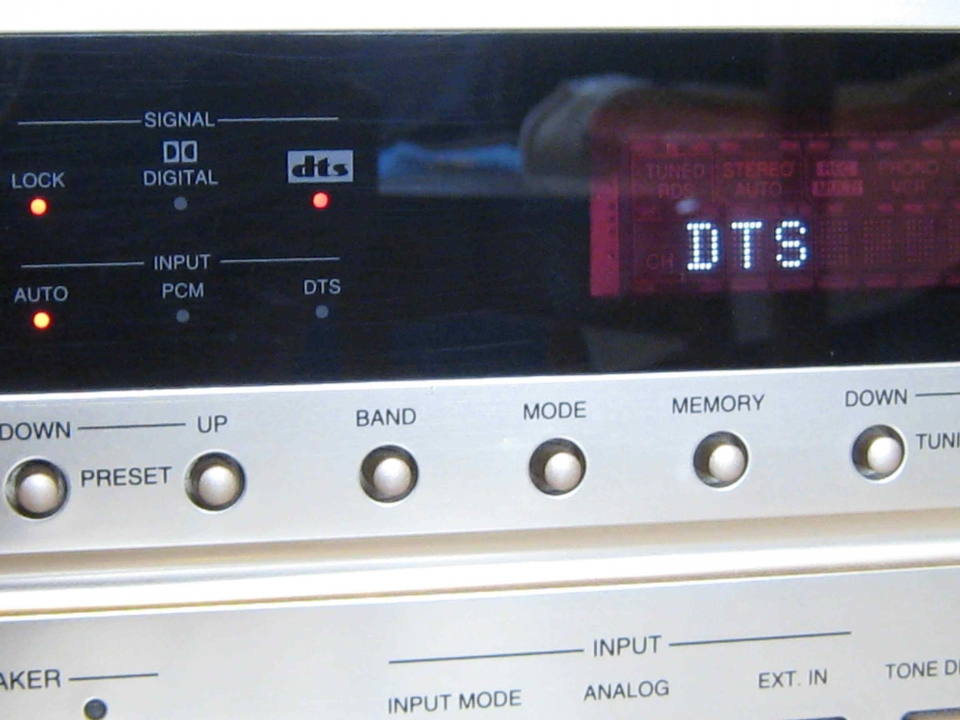

If you connect to AV Amplifer , it supports DTS-HDMA, Dolby Digital
