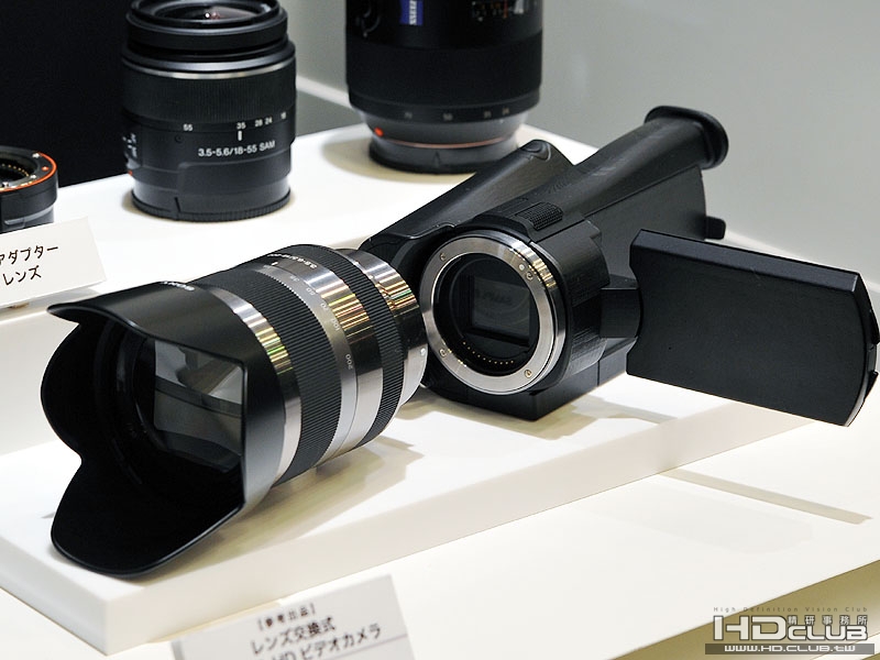

The new camcorder will be equipped with the same "Exmor" APS HD CMOS sensor to be used in "NEX-5" and "NEX-3." In addition, the camcorder will be compatible with "E-mount" interchangeable lenses developed for "NEX-5" and "NEX-3", and also the wealth of "A-mount" interchangeable lenses from the existing "α" DSLR camera lineup via a mount adaptor.
By combining these features, Sony aims to market a camcorder capable of generating a variety of creative expressions in full HD quality.
【 引用】从目前索尼开发草图上看,这款采用APS HD CMOS图像传感器DV产品,像是传统消费级DV机身+单反镜头的组合。据介绍,这款产品将和NEX系列单电一样共同采用索尼E系列镜头接口,也可通过转接环安装“α”单反镜头。
