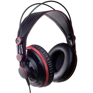

Superlux HD 681 Dynamic Semi-Open Headphones
Type: Dynamic, Semi-open
Driver: 50mm, dome type, neodymium magnet
Sensitivity: 98 dB (SPL/mW)
Frequency Range: 10 to 30,000 Hz
Rated Impedance: 32 Ohms
售價$34.95美金,算便宜,不過小弟對這個semi open就不懂了,是差在哪裡?

小弟今天去敗了 Superlux HD-660,音質還不錯…最比較讓我滿意是隔音效果不錯
Type:Dynamic, Closed-back
Driver:
Φ40mm, neodymium
Sensitivity:
96dB SPL (1mW)
Frequency Response:
10–30,000Hz
Max. Input Power:
100 mW
Rated Impedance:
150 Ω
Earpads:
leatherette
Cables:
3-meter (9.8 ft.) coiled, single-sided cable
Connector:Screw-on gold plated stereo mini plug
Headphone Caliper Pressure:
Approx. 6N
Weight (with cable):250 g/ 8.8 oz
雖然音質比不上其它牌,但我覺得以材質跟價錢上來看,整體覺得還算不貴。
比較讓小弟驚奇的是,在通常電子產品物價都是外國的2倍以上的阿根廷裡,這支才賣 $53美金,台灣拍賣上賣1700,差不多$58美金,我居然買的更便宜?!
