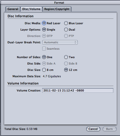

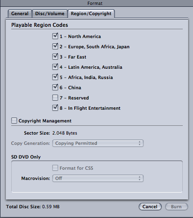

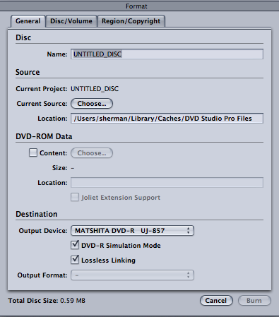

這是我的設定,你試試

你的問題在友站也有提出,但是並未見到你提供相關的資訊,DVD Studio Pro 本來就是製作給家用 DVD 播放機用的,怎麼可能輸出不能播放呢?
樓上的設定,其實都是原本既定的設定,沒有特別做修改,也就是說是通用的設定。
所以還是請你把你相關的影像製作資訊提供一下吧!要不然,要大家怎麼知道你的問題在哪裡呢?
發表於 2011-2-17 17:47:58 | 顯示全部樓層
另外,第一個設定中的 DVD-R Simulation Mode 切勿按下,在 DVD Studio Pro 的操作使用手冊的 587 頁中,很清楚的說明到,如果按下這個功能,只是作測試性的燒錄模擬,但是並未真實的燒錄,所以按下這個,只是浪費模擬的燒錄時間。
以下是那段說明:
DVD-R Simulation Mode: This is active only when writing to a DVD-R drive. When selected,
the format goes through the motions of writing to the DVD-R drive, but does not
actually write to the disc.
Note: This mode can only be used with DVD-R media. It cannot be used with DVD+R
media.
This is useful when you want to ensure that your system is able to support writing to
a disc without any buffer underrun issues. Buffer issues indicate that data is not flowing
smoothly and continuously from the source disk to the DVD-R drive. This can be caused
by a slow device (for example, a networked hard disk) or a system that is too busy doing
additional tasks. (A buffer underrun error that occurs while data is actually being written
to a disc results in an unusable disc.)
Once you finish the simulation with no problems, you can deselect the DVD-R Simulation
Mode checkbox and feel comfortable that you can safely burn a DVD.
而這幾個視窗頁面,都是在 Build & Format 的燒錄方式選擇。
所以,樓主,既然是跟大家詢問,也請您將詳細的影像規格(SD/HD)、時間長度、壓縮流量等,說明一下,要不然,大家很難幫你回答,你想要問的問題。
