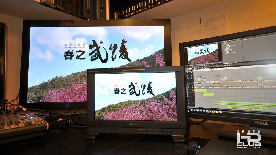

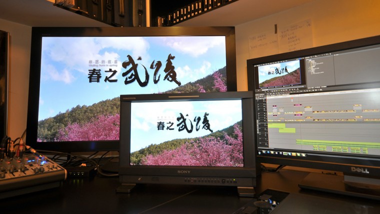

評測準備中
PanelOLED panel
Picture Size16.6 (419.7 mm)
Effective Picture Size (H x V)14.5 x 8.1 (365.8 x 205.7 mm)
Resolution1920 x 1080 pixels (Full HD)
Aspect Ratio16:9
Panel DriveRGB 10-bit
Viewing Angle89/89/89/89 (typ)(U/D/L/R contrast > 10:1)
InputComposite: 1 BNC, 1 Vp-p3dB sync negative
SDI: 2 BNC
1 HDMI
Audio: 1 stereo mini jack, -5 dBu 47 kohms or higher
Parallel remote: 1 modular connector (pin-assignable)
Serial remote (LAN): 1 RJ-45 modular connector (10BASE-T/100BASE-TX)
DC-IN connector: DC 12 V (output impedance 0.05 ohm or less)
OutputComposite: BNC (x1), loop-through, with 75 ohms automatic termination
SDI: BNC (x1), output signal amplitude: 800 mVp-p ±10%, output impedance: 75 ohms unbalanced
Audio monitor out: Stereo mini jack (x1)
Speaker (Built-in): 1.0 W (mono)
Headphones output: Stereo mini jack (x1)
Power RequirementAC 100 V to 240 V, 50/60 Hz, 1.0 A to 0.5 A
DC 12 V 7.0 A
Power ConsumptionApprox. 90 W (maximum), Approx. 70 W (average power consumption in the default status)
Operating Temperature32 to 95°F (0 to 35°C)
Recommended: 68 to 86°F (20 to 30°C)
Operating Humidity30% to 85% (no condensation)
Storage Humidity0% to 90%
Maximum PressureOperating, storage, and transport pressure: 700 hPa to 1060 hPa
Dimensions17.25 x 12.1 x 6.37" (438.1 x 307.3 x 160 mm) (with stand)
17.75 x 11.5 x 4.75" (450 x 292.1 x 120.6 mm) (without stand)
Weight15 lb (7.2 kg)
20 lb (9.3 kg) (with optional stand)
