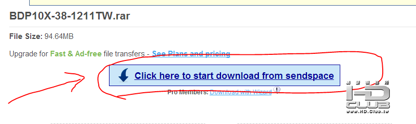

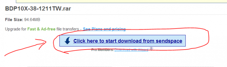

下載連結網址:http://www.sendspace.com/file/1nwgoq
