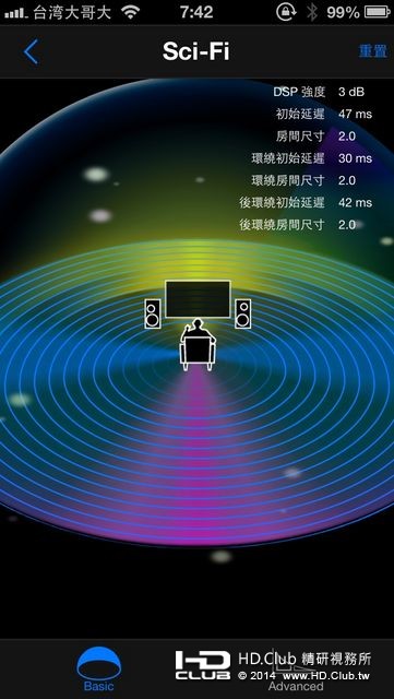

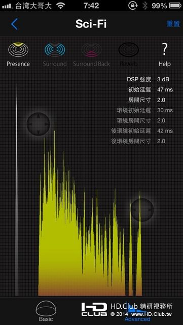

a3040初體驗!!!
報告一下,a3040比a3030效果真的進步很多,不論上空音場或是聲音感覺都有明顯差異呢,更方便是每一個DSP,都能簡單透過手機App作調整,有調整DSP音場效果放大丶縮小及可獨立調整前丶中(側)丶後DSP音場效果增強,最重要是如果調整過度也能隨時重置設定,可以說是貼心功能。
在目前還沒有atmos,但光DSP那效果就可如電影院音場寬大,可能歸功於那垂直高度的第四點角度測量,?有機會一定要試聽看看,在寫一篇來參考看看,以上~謝謝!

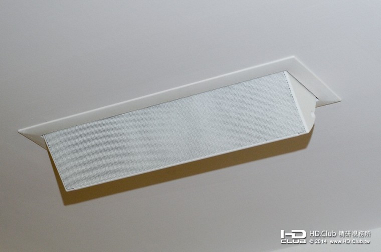

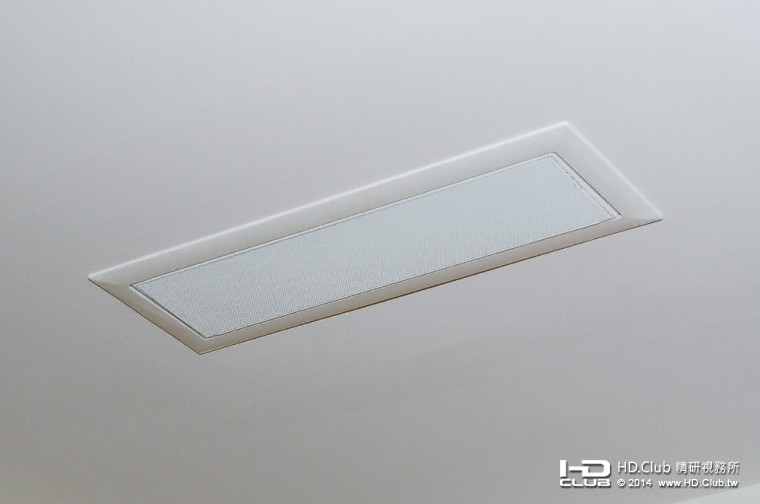

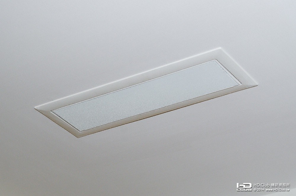

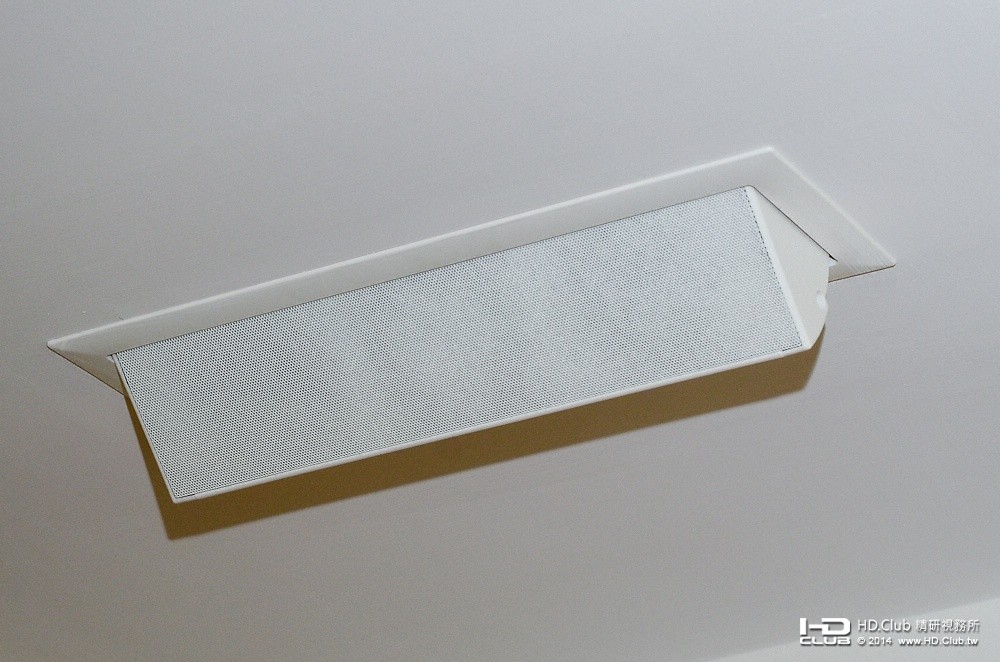

電動的吸頂式 KEF
平時關閉.
用時打開.
  型號:CI3-80QT
http://www.kef.com/uploads/files/en..._spec_sheet.pdf
實例:
http://www.audionet.com.tw/a/forum.php?mod=viewthread&tid=4314&highlight=%E5%AE%B6%E8%A8%AA
ATMOS 就可利用.

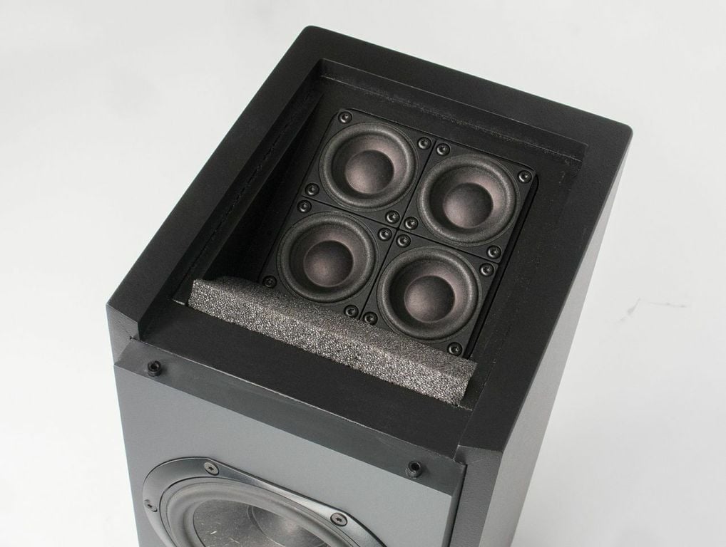

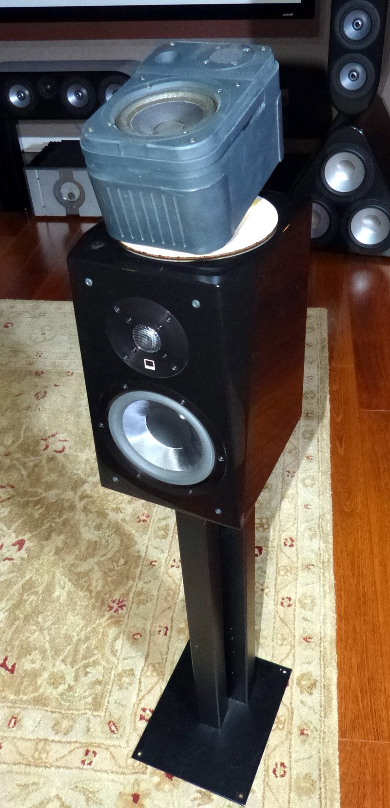

目前 已知ATMOS 的 喇叭
本文章最後由 -sdds- 於 2014-10-1 10:05 編輯
關於ATMOS喇叭的使用 這有兩篇寫的還不錯的~可以了解更多~~ 其中一篇也提到 拿用不著的書架喇叭當ATMOS喇叭時的注意事項~~
Steerable Dolby Atmos Enabled Speaker Proposal with Video Interview
http://www.audioholics.com/audio ... os-speaker-proposal
Dolby Atmos Elevation Speakers Explained
http://www.audioholics.com/louds ... s-elevation-speaker
Make Your Own Dolby Atmos Elevation Speaker?
Procedure For Making Your Own Atmos Elevation Speaker:
Select a smallish bookshelf speaker that can easily fit on top of your front and/or rear surround speakers (choose something with similar output and frequency response capabilities above 200Hz as your other surround channels if possible).
Place the speaker (with the front baffle firing up towards the ceiling) on top of your front and/or rear speakers at 20 degrees using a door stop or foam wedge.
Connect the top firing speaker to the Atmos channel of your AV Receiver.
Set your AV Receiver HPF bass management for the Atmos channels between 150-200Hz.
Level match and time align.
Caution: Don't place an Atmos logo on the speaker to avoid a potential patent infringement lawsuit
Atlantic Technology, Definitive Technology, KEF, Onkyo, Pioneer USA, Teufel, and Triad Speakers
Atlantic Technology
KEF
Onkyo
Pioneer USA
Teufel
Triad Speakers
