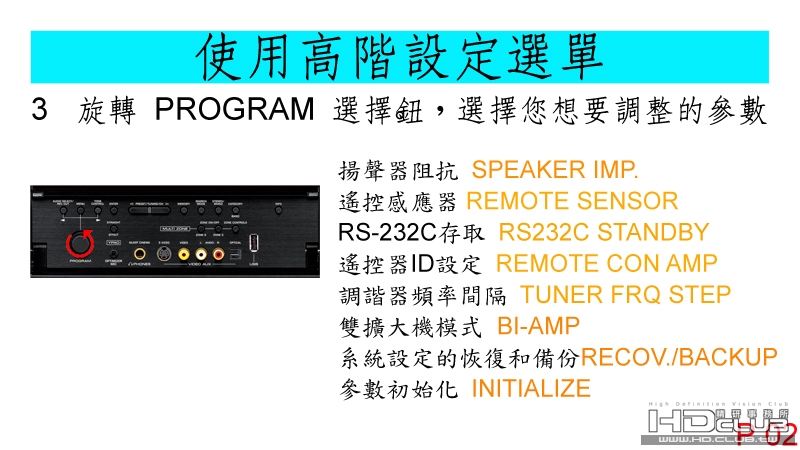

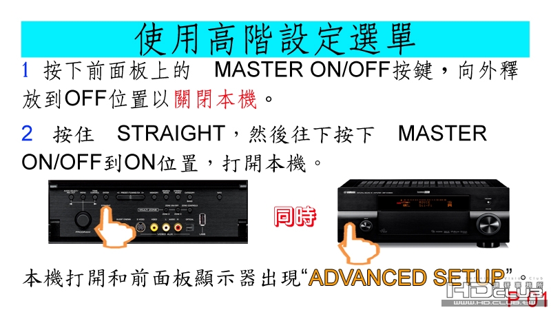

可以使用

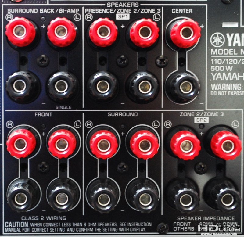

我記得Bi-AMP用上了Surround Back78聲道的喇叭端子,而78聲道的擴大模組跟Presence的擴大是同一組...
所以Bi-AMP,78聲道,前環場,三者只能擇其一.....麻煩Peter大有空幫忙try一下...小弟這邊只有5顆喇叭,無法測試,感恩

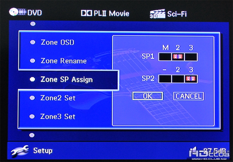

A:請進入ZONE 設定將SP 1 改 M

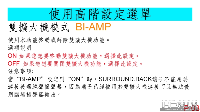

A:請看說明書 每一音場程式之聲音輸出
請設定SP 1為M

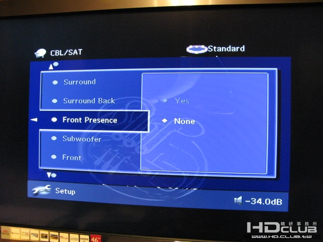

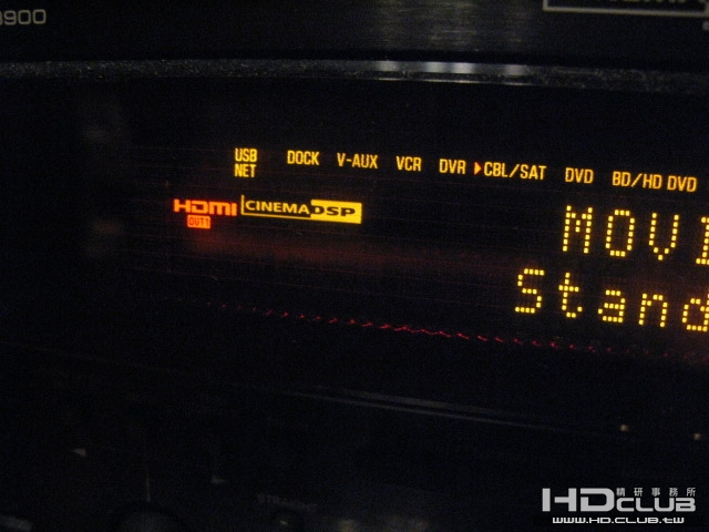

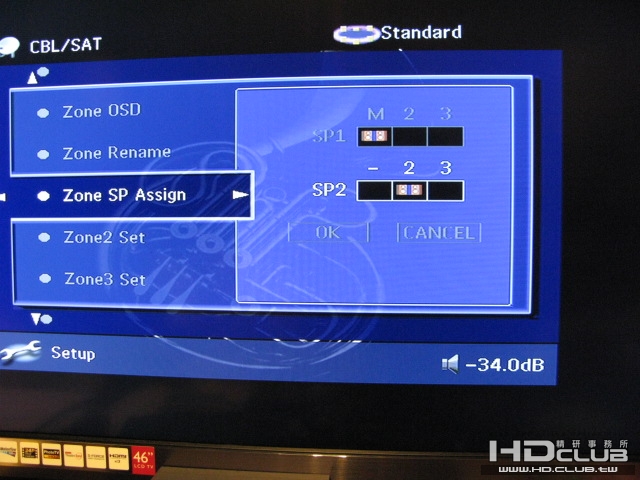

I confirmed that set the zone sp assisgn is still can't use bi-amp & front presence at same time.
see the photo
3D signal is off
3D signal is off
front pre. is none
front pre. is none
sp1 is set on main
sp1 is set on main
