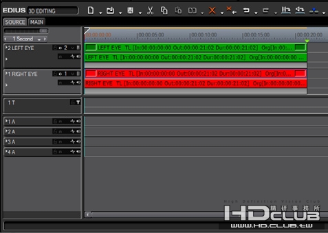

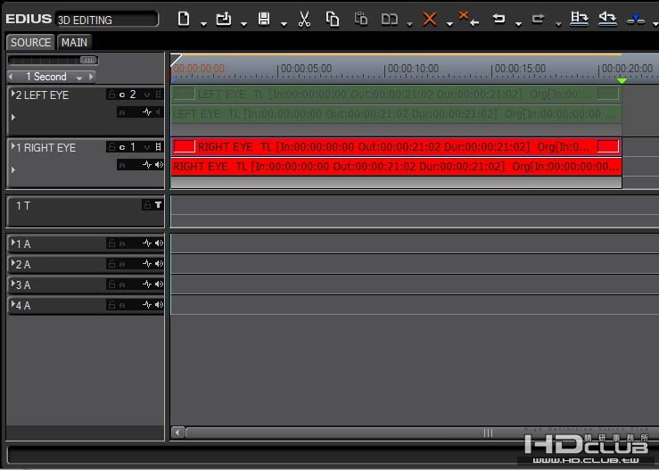

First, name the tracks, to differentiate Left-eye and Right-eye channels
(Example: Track name for 1VA = 1Left, track name for 2VA= 2Right.)
Adjust and place Left-eye and Right-eye clips on the timeline, according to their timecodes

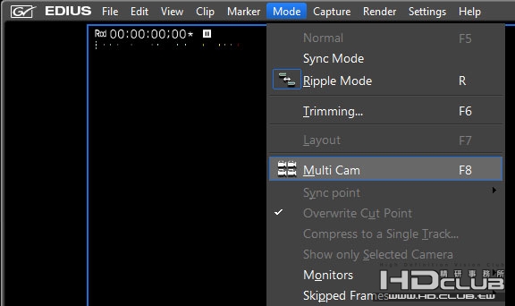

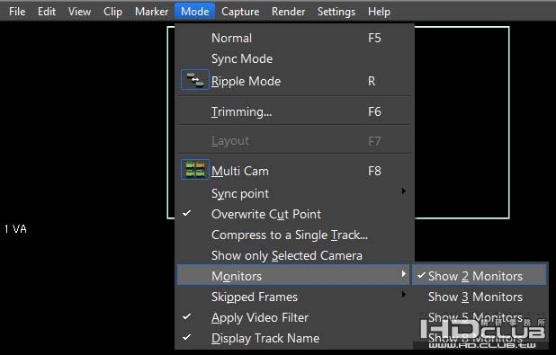

After registering the Left-eye and Right-eye videos in the Bin, change to Multi-cam mode.
Choose “Mode” from the menu bar, then select “Multi-cam.”
Setup (cont.)
Set Multi-cam Mode to two screens, and make sure that you can see both left and right screens at the same time.
Select “Mode” from the menu bar > “Monitors” > “Show 2 Monitors.”

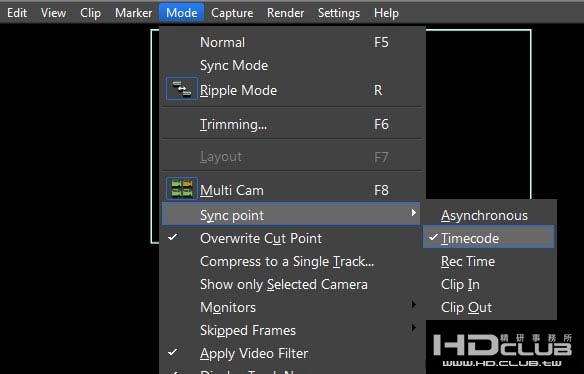

Choose “Mode” from the menu bar again, then “Sync Point”, and make sure that “Timecode” has been selected. If not, select it.
Now, if you select the Left-eye and Right-eye clips in the Bin, and place them on the timeline, the clips will be synchronized by their timecodes.
In the event that the clips do not have timecodes, you must manually adjust the two clips on the timeline.

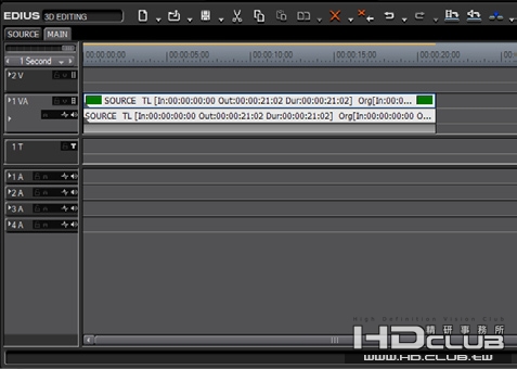

Once the clips have been synchronized in Multi-cam mode, drag the source sequence from the bin to the main sequence.

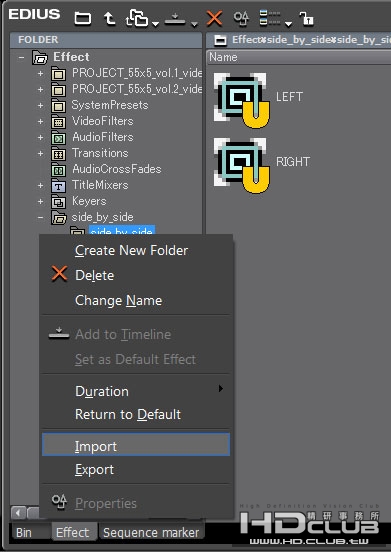

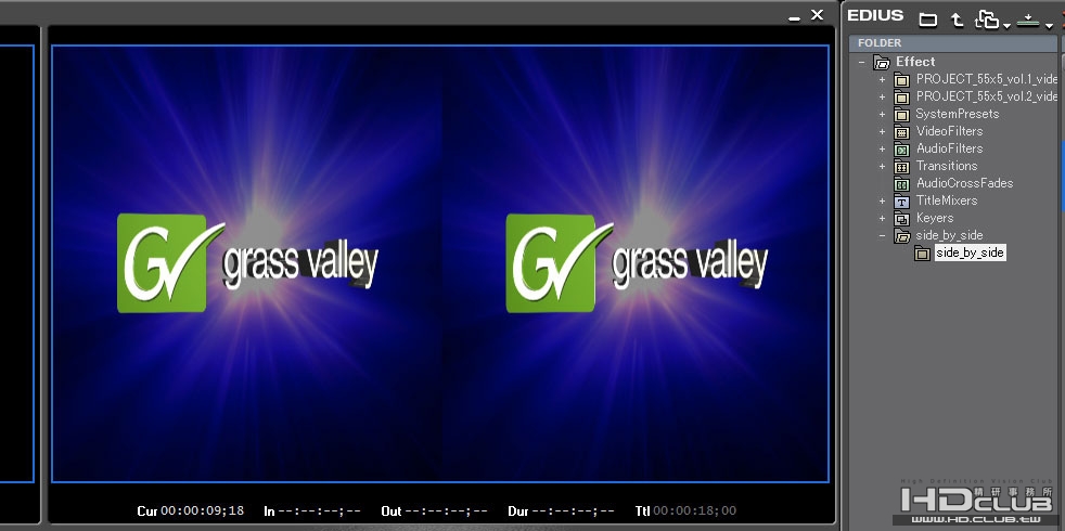

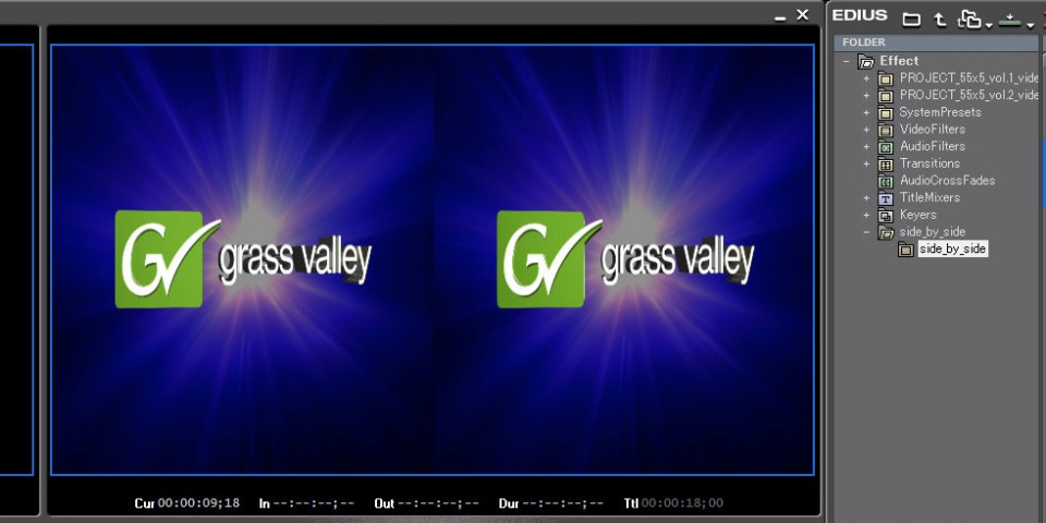

First, import the Side-by-Side preset into the effects folder.
Left-click the Effect pallet, select “Import”, and open “side_by_side.tpd.”
Explanation of the Side-by-side Preset

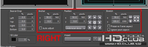

Left-eye (Left camera) Layout: LEFT
(Anchor: x=-50% position: x=-50%, size: x=50%, deselect “Preserve frame aspect”)
Right-eye (Right camera) Layout: RIGHT
(Anchor: x=50% position: x=50%, size: x=50%, deselect “Preserve frame aspect”)

Next, open the source sequence, and apply the Video Layout preset “LEFT” on the clip for the Left-eye, and “RIGHT” on the clip for the Right-eye.
Now, if you return to the main sequence, you should be able to see the edited video Side-by-Side.

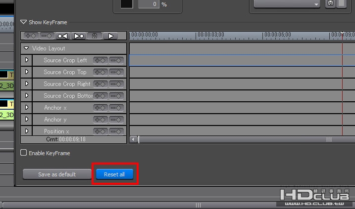

If you need to edit the video after the Side-by-Side layout setting has been applied, remember to remove the Side-by-Side layout settings first!
To do this, open the source sequence, choose each clip, select the “Video Layout” setting from the effect pallet, and select “Reset all” button on the bottom left side of the window to clear the settings.

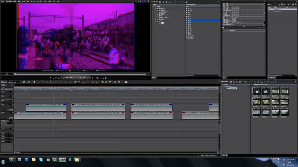

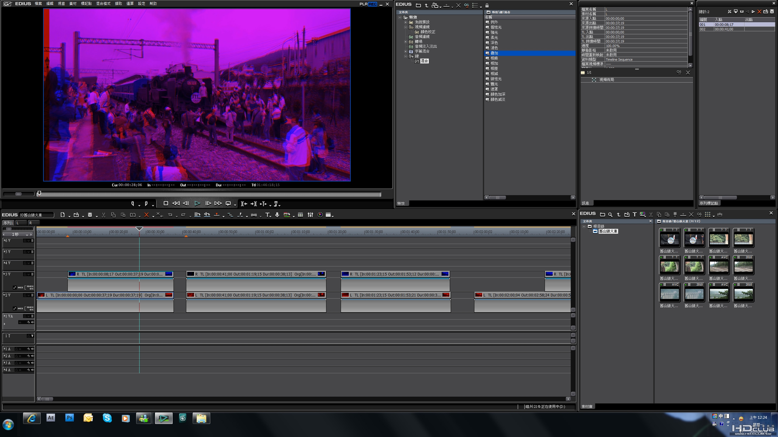

EDIUS 也可以土法煉鋼使用紅藍眼鏡剪接的。
只是效果當然沒有side_by_side來的好。
