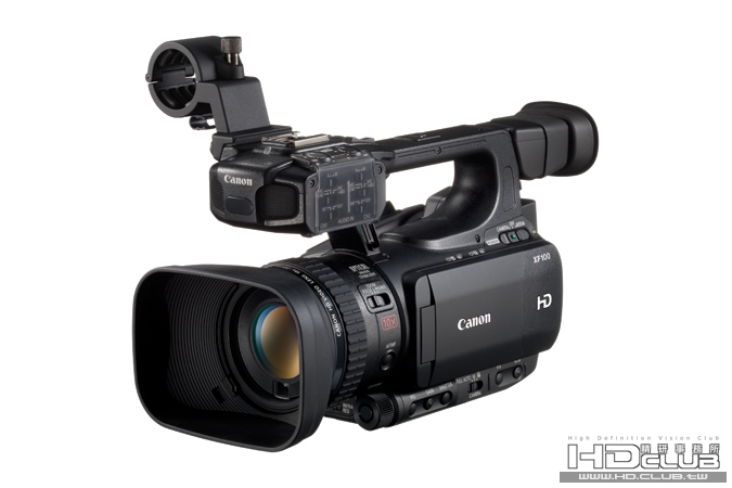

這台怎麼沒人討論呢?
在這 APSC 充斥的時代,這種機器會被冷落也是應該的,
不過這個是真正的攝影機,207萬點對點畫素,分辨率的保證,
很有興趣。
Standard Definition or High DefinitionHigh Definition
Power Supply (rated)7.4V DC (battery pack)
Video Recording systemCompression: MPEG-2 Long GOP
Color Space: 4:2:2 (at 50Mbps recording)
File Format: MXF
Recording Modes:
50Mbps (CBR) 4:2:2, 1920x1080, (60i/30p/24p),  1280x720 (60p/30p/24p)
35Mbps (VBR) 4:2:0, 1920x1080 (60i/30p/24p), 1280x720 (60p/30p/24p)
25Mbps (CBR) 4:2:0, 1440x1080 (60i/30p/24p)
Audio Recording system2-Channel, PCM digital recording, 16-Bit; 48kHz
Image Sensor1/3-inch CMOS
Total PixelsApprox. 2.37 megapixels (2044 x 1160 pixels)
Effective PixelsApprox. 2.07 megapixels (1920 x 1080 pixels)
Maximum recording Time64GB Compact Flash (CF) card
Greater capacity is possible when two cards are used.
25Mbps: 310 minutes
35Mbps: 225 minutes
50Mbps: 160 minutes
LensCanon 10x HD Zoom Lens, 4.25-42.5mm (35mm equivalent 30.4-304mm), f/1.8-2.8
Focusing SystemTVAF plus External Phase Difference Metering Sensor, Autofocus (Instant AF, Medium AF, Normal AF, Face AF, Face Only AF), Manual, Full Manual
Manual ExposureYes
Max Shutter Speed1/2000
Minimum Focusing Distance20mm (wide macro), 60cm (entire zoom range)
White BalanceAuto, Manual, Custom (2000K - 15000K in 100K increments), Daylight, Tungsten
Frame Rate60i, 60p, 30p, 24p (50i and 25p optional upgrade available through Canon Factory Service Center)
Minimum IlluminationFull AUTO mode: 4.5 lux (Shutter speed 1/60, Gain +24dB); Manual mode: 1.6 lux (shutter speed 1/4, Gain +33dB)
Image StabilizationSuperRange Optical (Lens Shift) 4 modes: Standard, Powered, Dynamic, Off
Filter Diameter58mm
Viewfinder0.24-inch color widescreen, approx. 260,000 dots, approx. 100% field of view
LCD Screen3.5-inch color widescreen LCD, approx. 920,000 dots, approx. 100% field of view
MicrophoneStereo electrect condenser microphone
Recording MediaCF Card : 2 Slots, Movie files only
SD Card: Still images, Custom Picture Data, Clip Metadata, Custom Settings
USB TerminalMini-B USB 2.0 Hi-Speed
Video TerminalComponent: Output only
Composite: A/V terminal 3.5mm mini-jack, output only
Audio TerminalXLR 3-pin jack (2), Switchable between MIC/LINE, 3.5mm stereo mini-jack
HDMI TerminalYes (Type A)
AV Mini Terminal/Headphone Terminal3.5mm stereo mini-jack
Remote Control TerminalYes (compatible with LANC protocol)
Operating Temperature range0°- 40°C, 32° - 104°F , 85% relative humidity
DimensionsApprox. 4.8 x 5.8 x 9.8 in. (121 x 148 x 250mm) (not including lens hood, mic holder unit, grip strap)
Weight (not including battery pack and memory card)Final specifications to be announced
WeightFinal specifications to be announced
重量雖然沒寫,預計是在 1.2Kg左右,很不錯的身形,
又是標準業務機。
