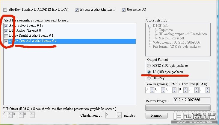

最新發現不要轉m2ts, 6500a 也可點燈TrueHD
只要用TsRemux 0.0.21.2, 過水一次成 ts 即可( I always uncheck the Dollby Digital to reduce file size a little bit).
[ 本帖最後由 joewang2003 於 2008-11-13 10:36 編輯 ]

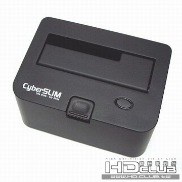

suggest to use external USB docking station like below, which can make your life easier.

發表於 2008-11-11 23:10:08 | 顯示全部樓層
回復 #436 joewang2003 的帖子
Thanks for joewang2003 feedback....
I know to use an exernal USB will be easier....But just worry about the transfer rate and stability for USB.....
I tried the "Tansformers" 40GB version on an USB HDD....looks fine.....
Maybe I am just too worry......:">
yrjou
