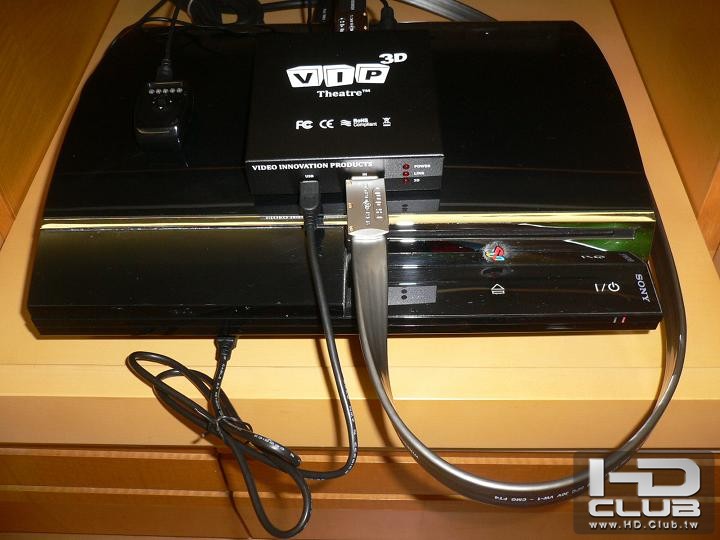

Watching 3D in your old TV - VIP 3D convertor
發表於 2011-3-28 18:24:48 | 顯示全部樓層 |閱讀模式
本文章最後由 r32 於 2011-3-28 23:22 編輯
http://www.avsforum.com/avs-vb/showthread.php?t=1323736
http://www.3d-vip.com/#!products
The Gamer will only work with PS3, 3D Games and DLP 120Hz projectors/televisions.
We will have 3D Theatre/3D-Displayer in stock in the first week of April.
3D-Theatre: $499.00 (Games, Movies, Satellite/Cable & Internet and 60Hz/120Hz TV/projector)
3D-Displayer: $299.00 (Games and Movies & 60Hz/120Hz TV/projector)
IR emitter glasses with emitter: $129.00
DLP Link glasses: $70.00
Shipping via USPS Priority Mail: $29.99 (International) & $9.99 (Domestic)
跟市場上同類產品(i.e. 3D-XL)不同,聽說這個可以輸出1080@24p! 可使用在2D TV / pj.(效果當然不及120Hz)
IR眼鏡 + emitter set或DLP link眼鏡均可選購, 其他品牌的IR眼鏡和DLP Link眼鏡也可共容, 但因應使用2D TV的用家, 眼鏡和emitter必須能同時對應60Hz / 120Hz.

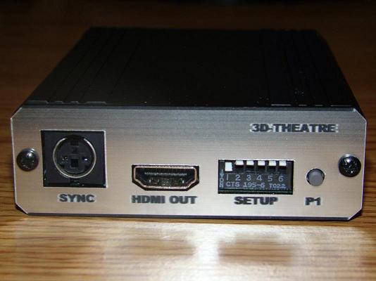

Here is the list of modes that VIP supports under 3D-THEATRE:
3D:
INPUT:
720p60 Frame packing, Side-by-Side, Top-and-Bottom
720p50 Frame packing, Side-by-Side, Top-and-Bottom
720p24 Frame packing, Side-by-Side, Top-and-Bottom
720p25 Frame packing, Side-by-Side, Top-and-Bottom
720p30 Frame packing, Side-by-Side, Top-and-Bottom
1080i60 Side-by-Side
1080i50 Side-by-Side
1080p24 Frame packing, Side-by-Side, Top-and-Bottom
1080p25 Frame packing, Side-by-Side, Top-and-Bottom
1080p30 Frame packing, Side-by-Side, Top-and-Bottom
OUTPUT:
720p 60Hz/120Hz
1080p@24 (firmware upgrade to come soon)
Jonathan Alexender
Video Innovation Products (3D-VIP)
1080p@24 3D輸出, 可以跨過2 : 3 pulldown這個大害, 將訊號交由3D ready DLP倍速處理.

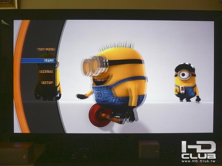

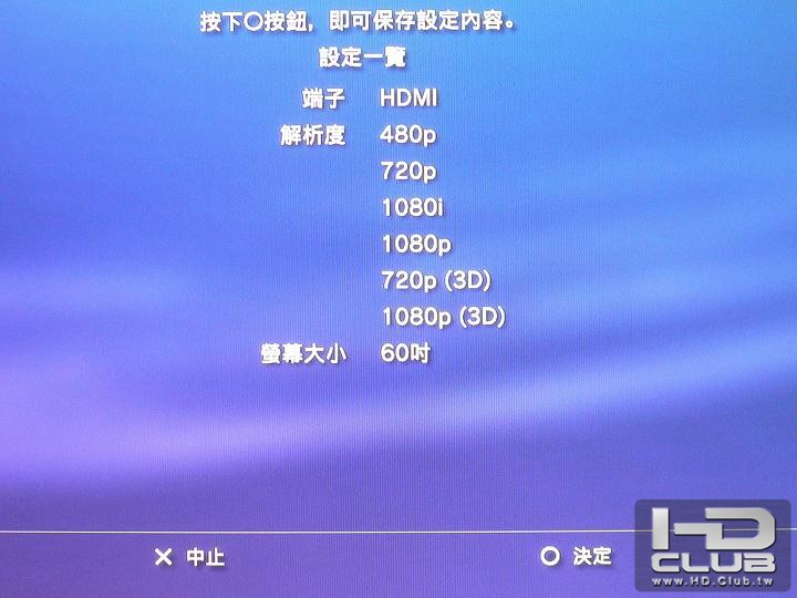

原r32大大提供的avs forum討論帖,目前已經蓋到40樓、1仟1百多篇的回覆了。
因為購入了2D投影機,所以也對這個機器感到有點興趣了!!
原作者的文中有提到使用60HZ 的LCD投影機來測試3D畫面的效果。
原文如下:

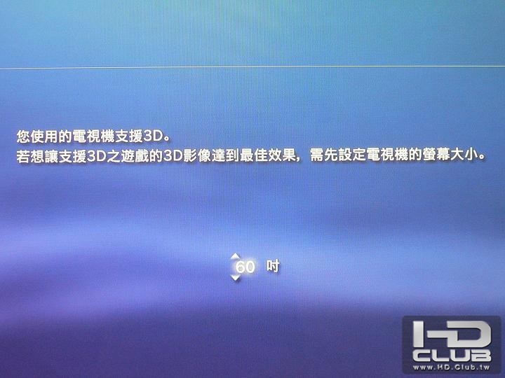

There is also a set of 6 Dip swithces on the rear of the unit,(more on those later). For this test the number 1 dip switch needs to be in the down position as the Epson is a 60hz LCD.
After powering on the PS3 it immeditely recognized that is was connected to a 3D display, YEAH!!! After setting the screen size we were off and running. My first test was Superstardust 3D, and the theatre Unit did its job! After a few clicks I was playing a 3D game on a projector I was never supposed to be playing 3D ANYTHING on! The image is solid with no ghosting, or crosstalk. There is a slight bit of flicker, thats to be expected on a 60hz display, but killing all light sources and pulling the shades, the flicker was unnoticeable in the image. So much for having to buy a brand new projector just to do 3D!
該測試有幾個重點:
1.連接PS3時成功被辨認為3D顯示器(VIP+EPSON 2D PJ)。
2.3D畫面無明顯的鬼影或重像(CROSSTALK)情況,但有輕微閃爍現象。
3.閃爍現象在60HZ的顯示器是預期會出現的,但是透過視聽環境的加強(全黑+強遮光)後可以得到改善。
當然這還是一個3D轉換的新產品,還需要與更多不同機型/不同光學設計的投影機/平面顯示器,作實際測試才知道是不是每一台60HZ/120HZ的顯示器都可以達到像作者形容的那種效果不錯的3D效果。
還是值得關注啦~

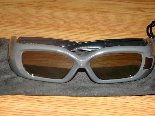

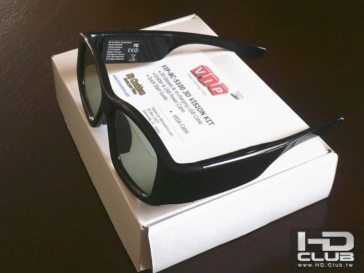

本文章最後由 r32 於 2011-6-17 16:00 編輯

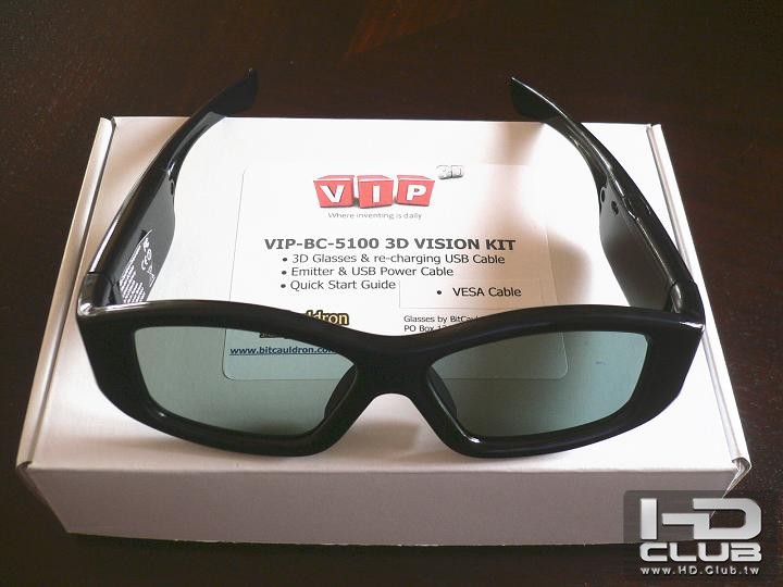

VIP Theatre 3D converter with RF active shutter glasses.

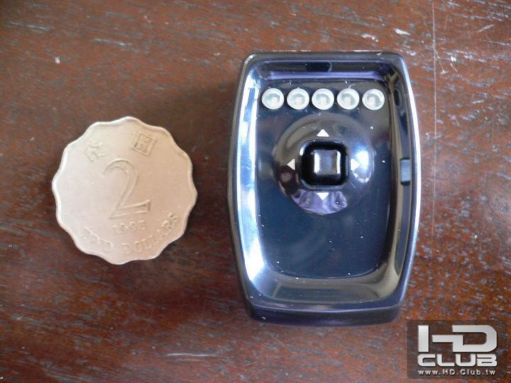

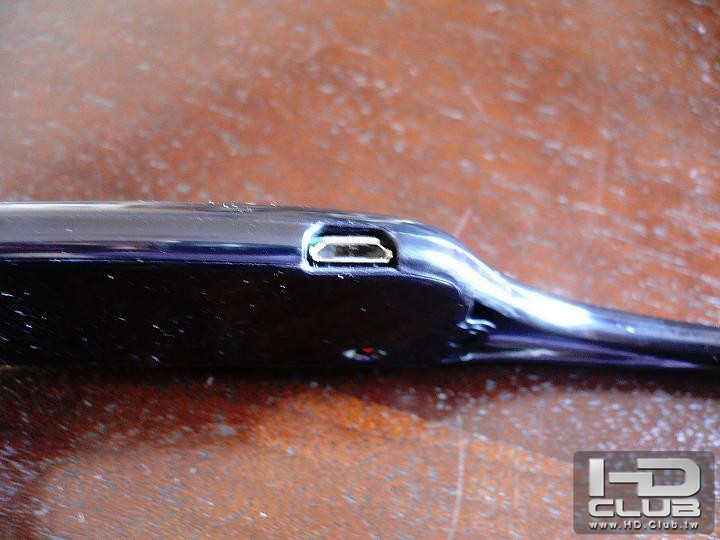

 樓主| 發表於 2011-6-17 16:02:38 | 顯示全部樓層
Bit Cauldron BC5000 glasses and BC100 RF Emitter.

 樓主| 發表於 2011-6-17 16:10:11 | 顯示全部樓層

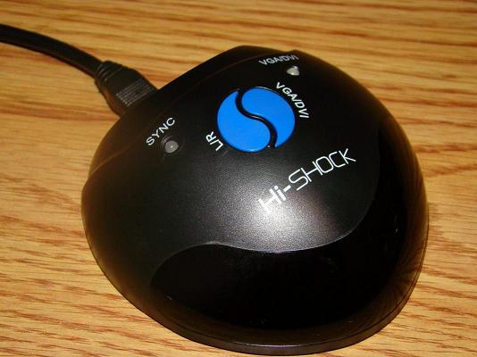

一般active 3D眼鏡多採用紅外線傳送同步訊號.
AV room太大接收不佳;
眠鏡不對正IR發射器有機會接收不佳;
若投影機置於視聽位遠後方, 可能要加裝IR發射器延長線, 甚至雙IR發射器;
同步訊號有機會被其他訊號干擾.......
Bit Cauldron採用RF傳送, 屬IEEE 802.15.4-2003 (ZigBee radio) 標準, 完全消除以上問題.
Bit Cauldron的特點 :
Eliminate ghosting with multi-microsecond accuracy;
Adjustable duty cycle for multiple display types;
不單對應 120Hz 的顯示器, 它還可以與50Hz, 60Hz, 84Hz, 100Hz, 120Hz同步. AMD HD3D解决方案也支持Bit Cauldron, 這對PC用家是一大喜訊.
