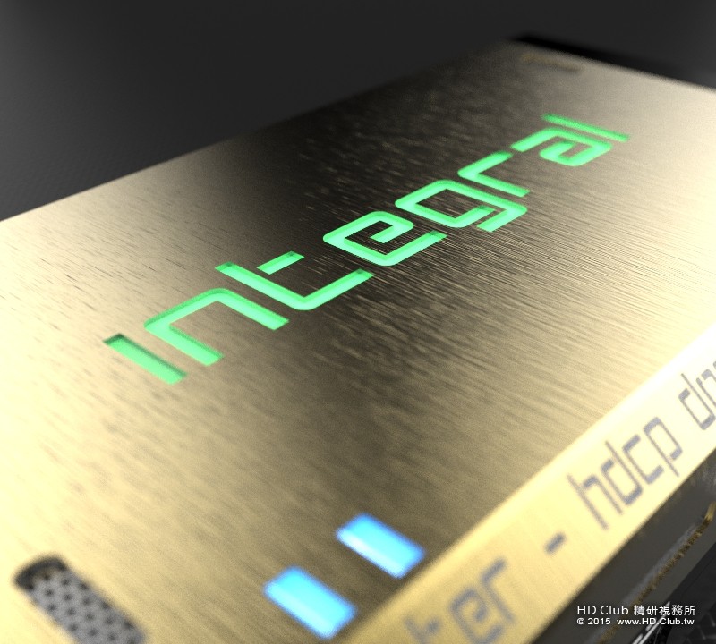

過去的幾年裡出售的許多4K UHD電視機不兼容HDCP 2.2,這意味著某些情況下,您可能無法收看到內容。 HDfury聲稱與他們的Integral 4K60 HDMI分配器方案能解決。
HDfury Integral is a 4K60 4:4:4 600MHz 18Gbps capable device built for system integrators and advanced users that will please everyone else as well.
By supporting the max bandwidth and data transfer rate of the HDMI2.0 standard and by offering new appealing options and possibilities, HDfury Integral set another couple of World 1st features. Versatile by design, it is a kind of hybrid HDfury that you can operate, configure and control from your Android/Apple smartphone/tablet.
HDfury Integral is capable of connecting any HDCP revision sources devices to any HDCP revision sink devices. GUARANTEED!
If you ever saw the following statement: “this TV does not support HDCP 2.2. Make sure you have HDCP 2.2 capable TV” or a similar one, make sure you never see it again with HDfury Integral! Featuring 2 inputs and 2 outputs, HDfury Integral can act as a Splitter, HDCP Doctor, CEC Commander, Audio extractor, Audio replacement, HDMI Doctor, Matrix, EDID management and more… Discover the tomorrow’s hardware today!
HDfury Integral Key Features

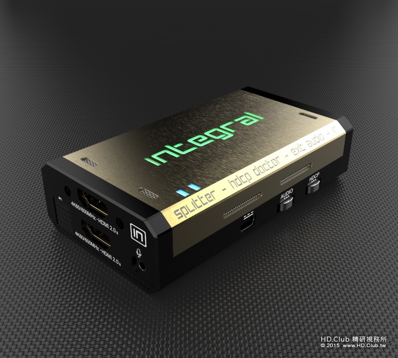

  • 2×2 Splitter up to 4K60 4:4:4 600MHz 18Gbps
    Splitting any signal up to 4K60 4:4:4 600MHz signal is now a reality, thanx to IR/BT or push button, you can easily switch between 2 inputs that will be replicated to 2 outputs. HDCP conversion can be configured and applied on the fly in order to always output the type of signal that your display or sink device is expecting.
  • 4K60 4:4:4 600MHz 18Gbps > 4K60 4:2:0 300 MHz 10.2Gbps conversion
    Mostly all UHD TV sold until recently can only accept 4K60 when it comes in the form of a 4K60 4:2:0 300MHz signal, However upcoming sources and current high end graphics cards are outputting 4K60 4:4:4 (600MHz – 18 Gbps). Integral is solving that arising issue.
  • HDMI Audio Extracting
    HDfury Integral can extract HDMI audio and has a simultaneous output of analog L/R stereo and optical S/PDIF via 3.5mm combo jack connector.
  • External Audio Replacing
    Mini jack input connector (or Mic/Line IN) option is available to replace the audio in any HDMI/DVI-D stream up to 4K60 4:4:4 600MHz 18Gbps.
    Audio replacing only work on one channel, the secondary channel is a direct path from HDMI to HDMI.
    Useful in presentation areas or for simply streaming your phone/tablet music to your HDMI amp.

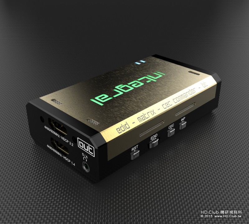

  • EDID Management
    Improved EDID Management solution with either a Custom uploaded EDID, Self generated Automix EDID or a Fixed basic EDID.
    AutoMix EDID feature will create a custom EDID by mixing both sink EDID connected to the splitter output ports.
    Custom and manual EDID utility available from the download section.
  • HDMI/CEC TOTAL COMMANDER*
    HDfury Integral offers an unique CEC commands manager, with CEC compatible equipment.
    CEC commands allow a HDMI source to send instructions and operate check on connected HDMI devices.
    Using the Integral’s Android/Apple APP for smartphone/tablet, user can configure custom CEC commands and send them LIVE or based on trigger event.
    As a practical use case example: it is capable of turning your display OFF when the source device is turned OFF.
    Concretely, it could turn off your HDTV when you power off your PS4.

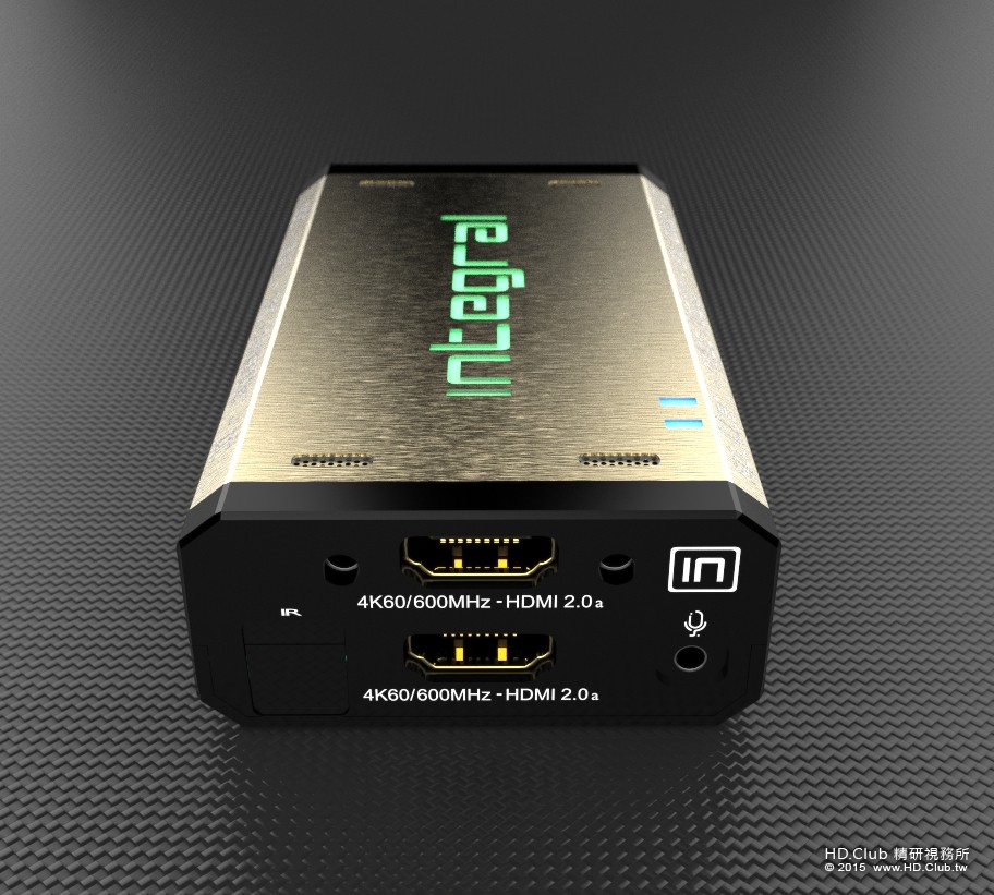

  • TOTAL CONTROL*
    HDfury Integral APP is available for mobile and tablet running Android or iOS.
    You can control HDfury Integral using your mobile phone or tablet via a bluetooth connection.
    IR control and various physical buttons for configurations are also available.
  • 2×2 Matrix up to 4K30 4:4:4 300MHz*
    Matrix solution is available for HDMI stream up to 4K30 4:4:4 300MHz 10.2Gbps.

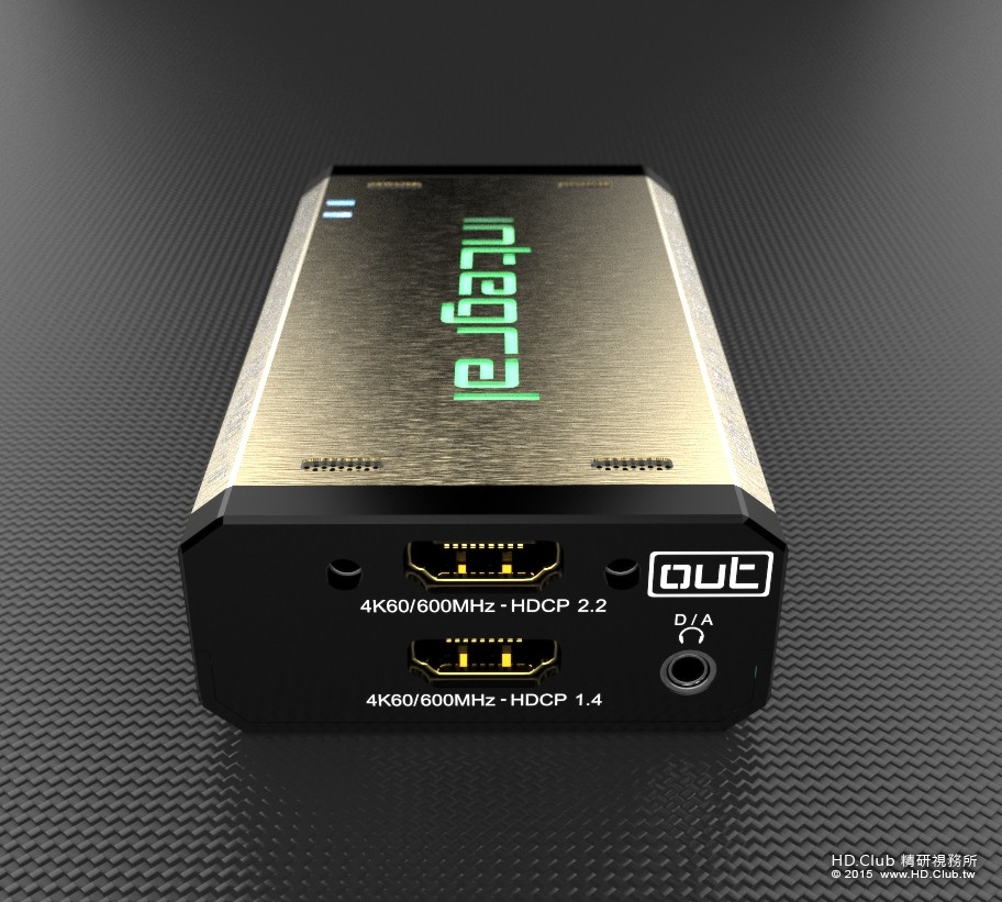

HDfury Integral SpecificationsMain Specifications
    • 2x Input / 2x Output Splitter (HDMI2.0a/HDMI1.4/DVI1.0 compatible)
    • ■ 4K60 4:4:4 600MHz 18Gbps Pass through
    • ■ 4K60 4:4:4 600MHz 18Gbps > 4K60 4:2:0 300MHz 10.2Gbps conversion
    • HDCP Doctor (HDCP Workaround solution)
    • ■ HDCP 2.2 > HDCP 1.4 conversion
    • ■ HDCP 1.4 > HDCP 2.2 conversion
    • ■ HDCP x.x > HDCP x.x conversion

    • Optical S/PDIF output
    • Analog stereo mini jack output.

    • Product Dimensions: 3.6” x 2.5” x 1”, Weight: 4 oz
    • Shipping Dimensions: 6.3” x 4.2” x 3.3”, Weight: 16 oz
    • Enclosure: Black PVC/Gold metal with Green/Blue Led

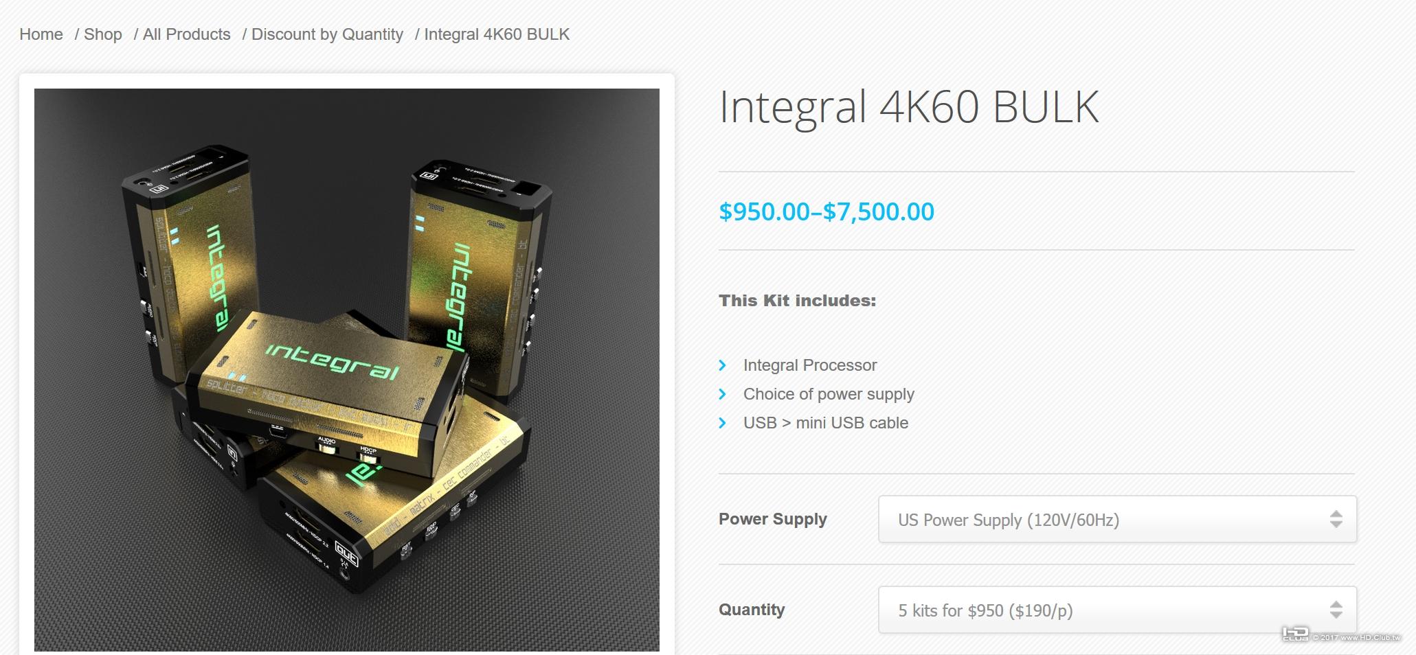

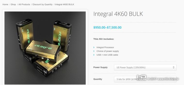

    Integral 4K60 4:4:4 600MHz
    $199.00
  • HDCP Doctor (HDCP Workaround solution to any HDCP error)
  • Dual HDMI2.0a & HDMI 1.4 combined
  • Dual HDCP 1.4 & HDCP 2.2 combined
  • CEC Support: For inter-device control between both inputs and the primary output (TOP) HDMI channel.
  • CEC command: USB configuration for automation, trigger via events, push button or via IR/Bluetooth
  • External Audio Replacing: input external sound or switch sound between input
  • Audio Extracting: Audio De-Embedder of Optical & Analog L/R
  • Advanced EDID management via USB, IR or Bluetooth APP
  • ■ Improved EDID Management solution with either a Selected EDID bank, Custom uploaded EDID, Self generated Automix EDID or a Fixed basic EDID.
  • ■ Sniff EDID from connected sink devices, Save, Edit, Load any custom EDID table at any time.
  • ■ Select and pick any EDID of your choice from a preloaded list of EDID tables, it loads and reset HPD to present your chosen one automatically.
  • ■ AutoMix EDID feature will create a custom EDID by mixing both sink EDID connected to the splitter output ports.
  • ■ Some EDID flags can be forced in Automix such as: Stereo/5.1/Full/YCbCr/BT2020/HDR/3D.
  • HDR & InfoFrame Live Injector. Watch the video!
  • HDMI Booster/Extender: Capable of extending 1080p resolution up to 15m. in and 15m. out (30m. total for 1080p), UHD resolution up to 10m.
  • HDMI Doctor: Solves most HDMI integration issues such as HDCP, EDID, HPD, and audio breakout.
  • HDMI Equalevel: Precise signal equalization towards both input and output signals perfectly delivers the best possible picture quality.
  • Hot-Plug control: Force the input device to always see an active connection.
  • Licensing: Fully licensed and compatible with all HDMI and HDCP technologies.
  • Deep Color Support
  • xvYCC Color Support
  • Flexible/Portable/Plug’n Play
  • 3D Ready: Capability to pass 3D stereoscopic signal formats.
  • Just like any recent HDfury hardware, it comes with USB upgradable firmware that allow you to unleash furious features.
Supported Audio/Video Signals
  • Supported Format: SD/HD/FullHD/UHD/4K30/4K60, basically INPUT/OUTPUT any video format up to 4K60 4:4:4 600Mhz 18Gbps
  • Supported resolution examples: 480p/720p/1080i/1080p24/1080p25/1080p30/1080p50/1080p60/1440p50/1440p60/2160p24/2160p25/2160p30/2160p50/2160p60
  • Support all UHD/BR standard resolution: 4K60 4:2:0 10bit BT2020 HDR, 4K60 4:2:0 12bit, 4K30 4:4:4 12bit, ..
  • Support all VESA mode video format (PC Resolutions) up to ultra high resolution such as WQSXGA, QUXGA, QFHD, WQUXGA, 4K
  • Support any Audio format such as PCM at up to 192kHz, compressed audio (IEC61937), DSD, DST,DTS,DTS-HD, Dolby True HD, DTS-MA and HBR.
Technical Specifications
  • Audio: PCM at up to 192kHz, compressed audio (IEC61937), DSD, DST, DTS, DTS-HD, Dolby True HD, DTS-MA and HBR.
  • Mic In (Line In) sampling at 44.1/48kHz
  • Mic In (Line In) 10k input impedance and 2 Vrms input level tolerant
  • DDC Signal: 5V p-p (TTL)
  • Power Supply: External 5 Volt 2 Amp USB (same as most smartphone/tablet PSU)
  • Power Consumption: <2Watts
  • Regulation: CE, FCC, RoHS, WEEE

官網有組合套餐基本款5台,1台原價199美元
一次買5台每台省9美元
不知有沒有人要合購
https://www.hdfury.com/shop/bulk/integral-4k60-bulk/
