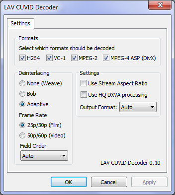

I would like to introduce my LAV CUVID Decoder.
It is a DirectShow Video Decoder utilizing the NVIDIA hardware decoder engine through the CUDA Video Decoding API ("CUVID").
Its still in its early stages, but its already been tested thoroughly and supports all major formats that the NVIDIA hardware can decode,
which are right now H264, VC-1, MPEG2 and MPEG4-ASP (DivX/Xvid). Both progressive and interlaced types are supported.
As a bonus, when decoding interlaced content, it can do full adaptive deinterlacing, the best your GPU has to offer.
So, without further introduction, here it is!
Features
- Decoding of H264, VC-1, MPEG2 and MPEG4-ASP (each given appropriate hardware support)
- Full Adaptive Deinterlacing, including Frame Doubling (perfect smooth playback of 1080i/60 content!)
- Usable with all renderers! Including
madVR, which is recommended for the best playback quality!
- NV12/YV12 output
Download
Source Code is available from my
Git repository
Binarys are available here:
Version 0.10:
-Installer (32/64-bit, CUDA 4.0+)
-32-bit (CUDA 4.0+)
-64-bit (CUDA 4.0+)
-32-bit (Older CUDA)
A note on the different versions: The CUDA 4.0 builds require a 270 series driver (or newer). The "Old CUDA" build should in theory work with much older drivers, in case you cannot upgrade.
Changelog
--Full changelog
--Release Notes
0.10 - 2011/08/14
- Refuse connection to MPEG-2 4:2:2 material
- Improved VC-1 interlaced timestamp handling
__________________
LAV Filters - open source ffmpeg based media splitter and decoders.
LAV CUVID - High Quality Hardware decoder for NVIDIA
This is a decoder for NVIDIA GPUs, it does not work with ATI/AMD or Intel, and it never will!
Requirements/Recommendations
- NVIDIA PureVideo HD capable graphics card (VDPAU Feature Set A or better - see
list here)
- At least 256MB of Video RAM, 512MB recommended
- Recent NVIDIA Drivers - CUDA 4.0 compatible driver recommended (270 series), older drivers may work with the "Old CUDA" build.
- Vista/7 recommended due to much improved driver handling, but XP SP3 "should work" (see hints below)
Performance
- 1080p60 decoding is only supported on VP4 hardware (VDPAU Feature Set C)
- When encountering performance issues, turning off the "HQ DXVA processing" option will yield the best gain in performance, at a minimal loss of quality.
- Using the latest driver (275.33 at the time of writing), can greatly improve the performance.
Hints
- When running on Windows XP, its recommended to turn the "Use HQ DXVA processing" setting off, its not fully supported on XP and might cause image corruption.
Known Issues
- The decoder will try to decode all video streams, and not refuse formats that are not supported.
- XVID in AVI will sometimes play not smooth / choppy. This is technically a problem with NVIDIAs decoder which should take care of this,
and therefor unlikely to be fixed anytime soon. I suggest to simply disable MPEG-4 ASP in LAV CUVID if you suffer from this problem.

容小弟補充一下...
1.此解碼器使用CUDA API,所以只有N卡才能用~
2.作業系統建議使用Win7
3.顯卡驅動程式建議更新至27x.xx以上版本點我更新
大姊怎會突然想到要介紹此Decoder...
下面參考附件設置...
For PureVideo 2 GPU users, enable only the H264 option.
For PureVideo 3 GPU users, enable the H264, VC-1 and MPEG2 options.
For PureVideo 4 GPU users, enable all format options.
The Deinterlacing option should be set to 'Adaptive', while the 'Use Stream Aspect Ratio' should be disabled.
'Use HQ DXVA processing' should also be disabled, unless your are playing interlaced movie DVD/Blu-rays. Almost always have to be disabled for progressive contents. Output Format should be left to 'Auto'.
If you don't want to bob during deinterlacing, choose the '25p/30p (Film)', else you can choose the '50p/60p (Video)'. 'Field order' can be left to 'Auto'.

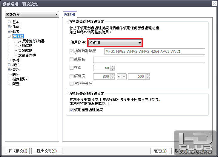

發表於 2011-8-26 20:41:31 | 顯示全部樓層
奇怪....我用GTS250
驅動程式版本 275.33
將Potplayer的解碼改成LAV CUVID
但是播放時顯示資訊卻仍是ffshow...= =||

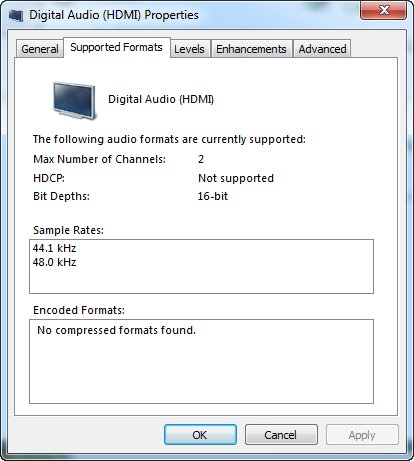

發表於 2011-8-26 21:50:58 | 顯示全部樓層
順便請教各位,各位用的Nvidia顯卡用HDMI輸出時,支援的頻率有沒有88.2KHz & 176.4KHz?
因我家裡用的兩張卡,一張是NV450,一張是AMD 5670,其中AMD 5670可以支援上述兩個頻率,但反而較晚出的NV450不支援....
參考畫面如下:

發表於 2011-8-26 22:56:09 | 顯示全部樓層
奇怪....我用GTS250
驅動程式版本 275.33
但是播放時顯示資訊卻仍是ffshow ...
echoli 發表於 2011-8-26 20:41
很明顯是你沒設定好...
除了附件圖還有3樓的設定去看一下唄~
