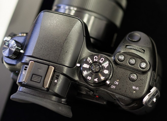

Above: Mr Uematsu-san presents the GH4

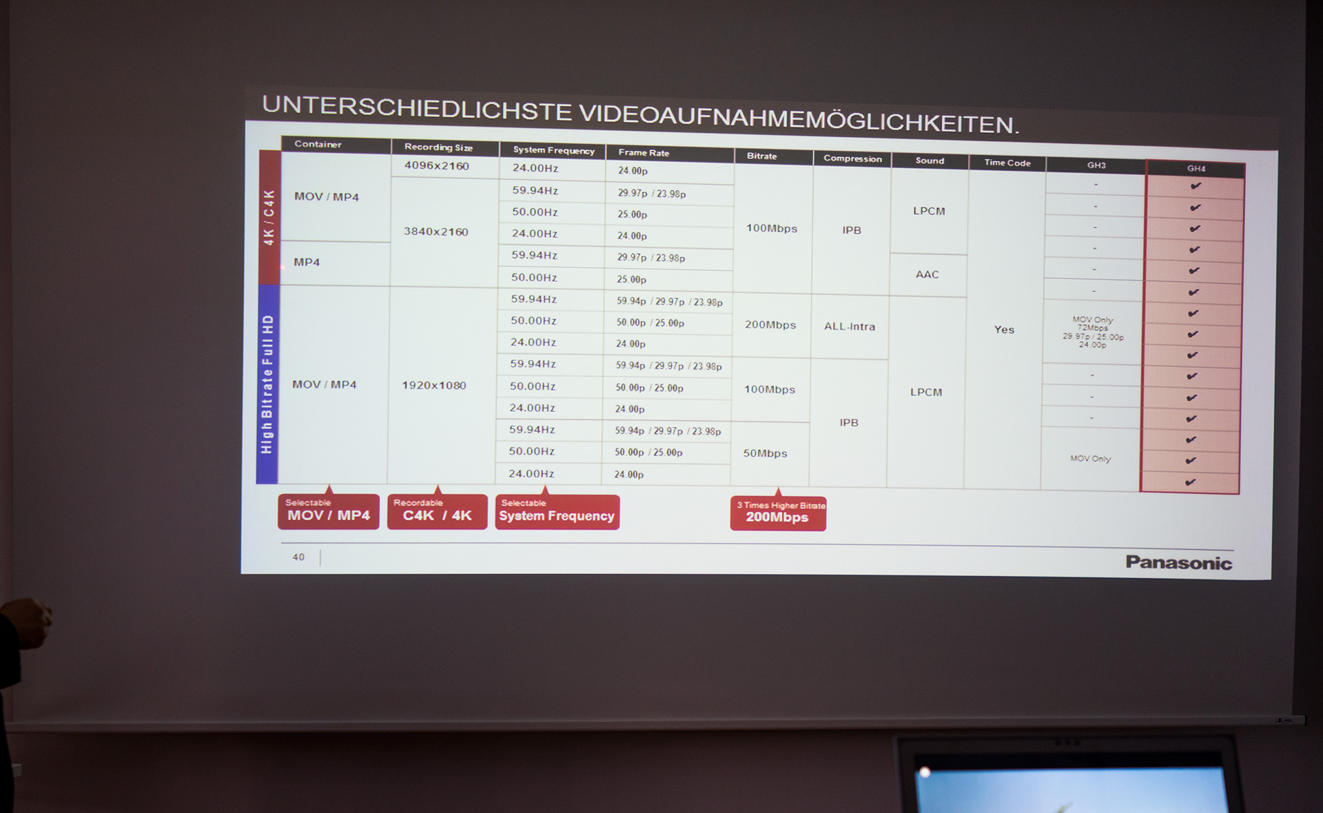

The internal codec for 1080p now goes to a huge 200Mbit ALL-I and Panasonic have introduced new SD cards which can sustain up to 30Mb/s as a bare minimum. These cards are good enough actually for 240Mbit/s 1080p.
This bitrate rivals ProRes and surpasses all the AVCHD pro cameras stuck at just 24Mbit like the Sony FS700 ($8000) and Canon C100 ($5000).

The 4K internal recording is H.264 at 100Mbit/s (megabits per second). The H.264 codec is much more efficient than MJPEG on the Canon 1D C and to save Canon’s blushes we won’t mention the price! The 1D C uses a bitrate of 500Mbit/s just to keep the image quality up. The end result is that you can store just 20 minutes of 4K video per 64GB compact flash card on the 1D C but a much more practical 90 minutes of 4K on one 64GB SD card with the GH4.

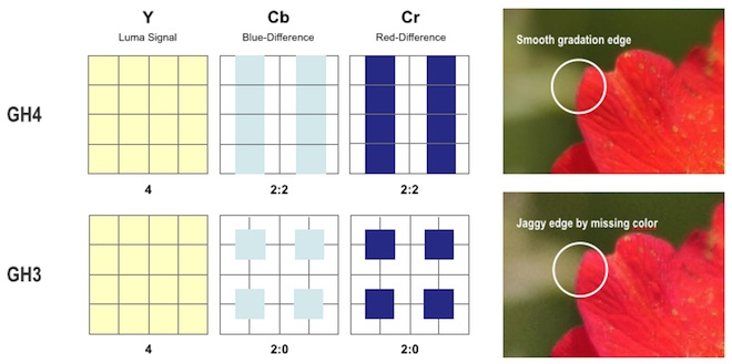

Although all the GH4 internal codecs are 8bit 4:2:0, according to Mr Uematsu-san the internal signal processing is all 4:2:2 (the same as for JPEG stills). As we have seen with the hacked GH2 and Canon 1D C, beautiful image quality can be maintained in 8bit if you don’t excessively grade the image and for those who do want to heavily colour correct, there’s the 10bit 4:2:2 1080p HDMI output. Until now DSLRs have only done 8bit over HDMI (and in my mind doubtful whether this was true 4:2:2).

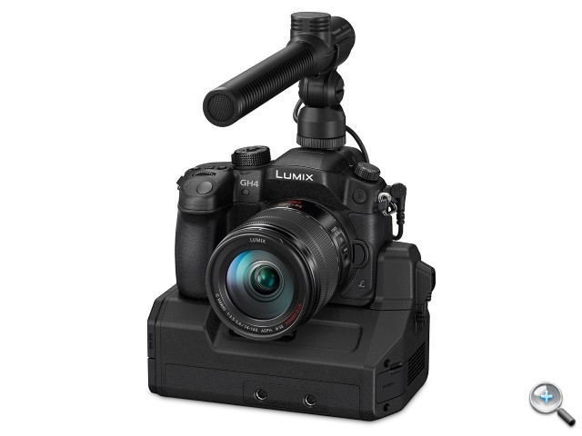

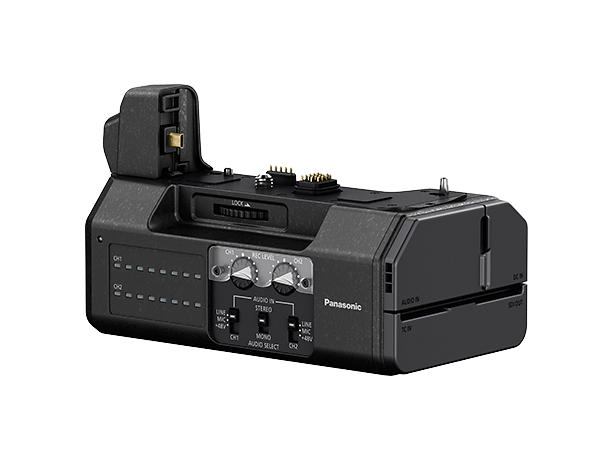

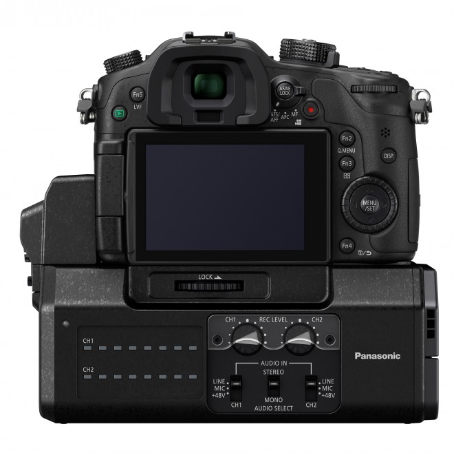

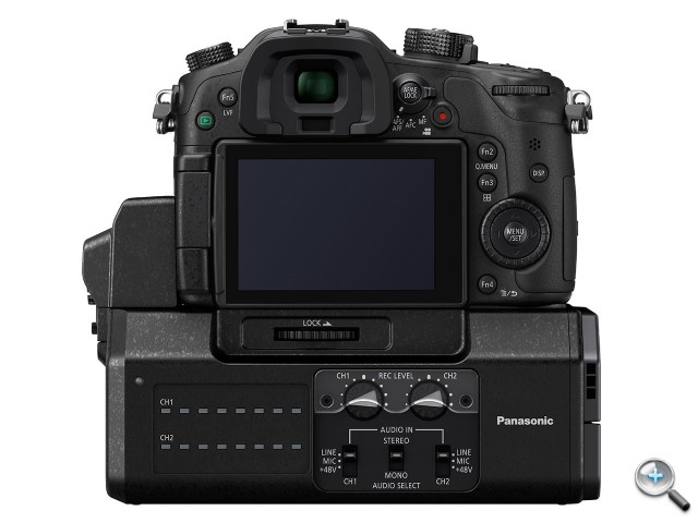

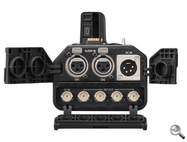

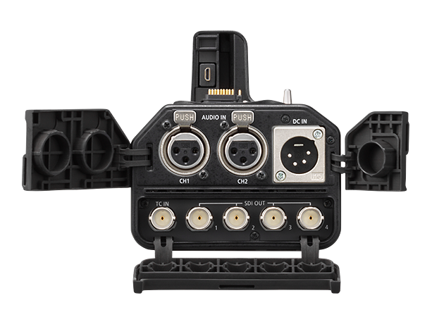

The external XLR / HD-SDI add-on for this camera allows for uncompressed 10bit 4K output over 3G HD-SDI – the kind of spec Canon currently charges $25,000 for.
The powerful add-on has no less than 4 HD-SDI ports (two of them 3G-HD-SDI), two XLR inputs with manual gain control dials and phantom power, a full sized HDMI port and a 12v power input. It is exactly what myself, Rudi and Rob (of Slashcam.de) suggested Panasonic make when we met a year ago.
Looking at some comments on the heavily leaked GH4 info out there, there seems to be some confusion about how this external box should be used. The form factor is not designed for handheld shooting or consumers. It isn’t an external recorder. It isn’t designed to be a battery grip. It isn’t “a vertical grip” as some even reported! It requires external power via a 12v tap, which should give you an idea of the kind of processing power it contains within.
Think about what would connect to this unit… A very high spec 4K recorder / monitor like the Odyssey 7Q, a V-lock battery and some chunky pro audio equipment via XLR. Is there any point shrinking this add-on down to the size of a consumer DSLR battery grip when you have all this hanging off it?
I appreciate it won’t be for everyone but the basic GH4 spec of 4K 8bit 4:2:0 at 100Mbit and 1080p in 10bit 4:2:2 via HDMI is to me very impressive and negates the need for most consumers to get the HD-SDI hardware.
I do think the ergonomics of ‘the brick’ could be, ahem – more refined! But it adds robustness and a leap in image quality that puts the GH4 firmly in professional territory – exactly what Panasonic needs. The box will also be indispensable for pros who find wobbly HDMI and single 3.5″ mic jack connections a major reliability worry.
It’s just a shame that the unit is designed only to fit directly under the camera. It should have been designed to fit pretty much anywhere, either under the camera or further back on your shoulder, indeed anywhere on the rig deemed convenient by the operator. It would have been great too for the unit to double as a recorder, reducing the extra hardware required to get that lovely uncompressed 10bit 4K. As of now, external 4K recorders are few and far between not to mention extremely expensive.

4K internally is 24p in the academy aspect ratio of 1.85:1 – 4096 x 2160.
A full range of frame rates – 30p,25p and 24p are available in the 16:9 4K variety of 3840 x 2160.
It’s great that Panasonic have included both 4K standards in the camera. The slightly wider 1.85:1 aspect ratio 24p mode is clearly aimed at filmmakers, 16:9 at the broader video production industry.

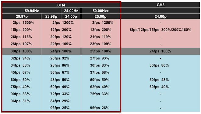

Here’s a slide showing the full array of recording options and codecs on the GH4 (click to enlarge) -
96fps slow-mo
The GH4 has a new undercrank and overcrank mode with slow-mo frame rate of 96fps, when is conformed to a frame rate of choice in-camera. Conformed to 24p and you get a lovely 25% reduction in speed which is much more dramatic than the more common 50% reduction from 60p to 30p.
These slow-mo options are available in full 1080p resolution, no need to drop to 720p.
Although 96fps isn’t going to look like the FS700 at 200fps, 96fps with a little Twixtor and post-production magic on top will!
The slow-mo option is not available in 4K mode, understandable given the enormous processing requirements this would require.

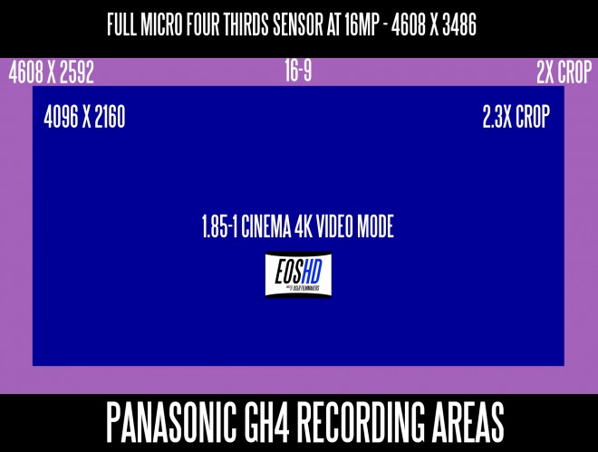

In order to get down to the 8.847MP of cinema 4K from the 4.6K full sensor (12MP in 16:9, 16MP in 4:3) the camera has to crop.
Cinema 4K mode video at 4096 x 2160 (1.85:1) is cut out of a 4680 x 2592 16:9 recording area (the full width of the sensor).
The crop factor in 4K mode therefore is not 2x as is standard for Micro Four Thirds but approximately 2.3x (similar to the Blackmagic Cinema Camera).
My feedback to Panasonic was to give us the full sensor 4.6K readout and let us scale it to 4K in post as the reduced sensor size is perhaps a little disappointing. I’m told Panasonic had much internal discussion over whether to take a 1:1 pixel readout of the sensor for 4K video, or to take the full sensor and scale (zoom) it down. The latter technique entails a drop of image quality because we’re back to pixel binning again. In the end they used the same technique as Canon on the 1D C – optimal image quality, reduced recording area – and it seems to pay off looking at the output.
With the current Metabones Speed Booster adapter you should get a Super-35-style 1.7x crop in 4K mode – close to the Canon APS-C 1.6x crop and only a 1.2x crop in cinematography terms. That for me is problem solved, but it’s a shame some of the wider native Micro Four Thirds lenses (at say 12mm) lose some of their appeal in 4K mode.

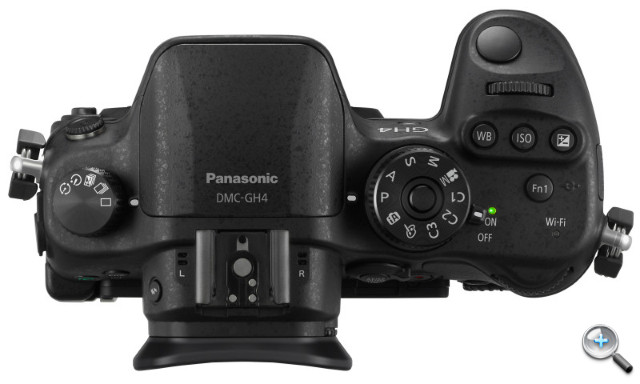

In my opinion Panasonic could have done more to differentiate the new body relative to the GH3 and not just in superficial ways. Like the GH3 small but significant design issues remain, for example a rear grip which doesn’t drop down near the rear-command wheel making it more awkward to turn than it should be. In general I’d have liked to have seen a few more changes here than just the re-sculptured flash and locking mode dial, welcome though these are.
I say lose the flash altogether and give us an extremely robust 5D Mark III style body and hot-shoe that can withstand anything. Let’s have a large HDMI port on the camera itself instead of the mini-one.

  • Ergonomic design of external add-on “DMW-YAGHE” could be better
  • External DMW-YAGHE has to attach to base of camera, cannot be more conveniently placed on your rig

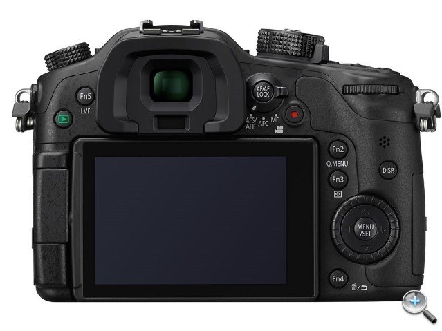

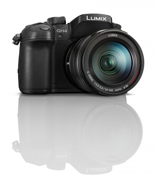

▲ 拍照與錄影畫質同步進化、對焦與規格全面提昇的 Panasonic LUMIX GH4 正式登場!
Panasonic 今天在日本正式發表旗下 Micro 4/3 無反光鏡系列旗艦機種 LUMIX GH4,以取代在 2012 年九月登場的 GH3。這款新機以 GH3 的防滴防塵金屬機身為基礎,但有相當多層面的提升,無論對靜態拍照玩家或多媒體錄影使用者而言都充滿吸引力。GH4 主打超高效能的感光元件與四核心處理器,可帶來更好的色彩詮釋、動態範圍與雜訊抑制,支援 B 快門 60 分鐘長曝,並達成 4K 超高解析度錄影,此外它的自動對焦速度更快、更精準,還支援眼部優先自動對焦。
在官方網頁 Panasonic 已經釋出許多專業攝影師所拍攝的 GH4 照片與影片,雖然暫時沒有完整解析度,但從色彩詮釋來看,似乎是 LUMIX 機種當中的最高水準。而在上市資訊方面,Panasonic 尚未透露 GH4 的發售時間與建議售價,普遍預期機身售價在 2,000 美元左右,發售時間可能是今年三月到五月之間。

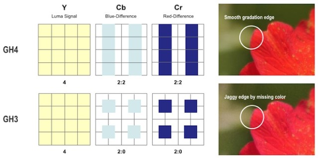

而較基本的 1080p 錄影解析度,也有 200Mbps 的 ALL-Intra 編碼超高流量模式能帶來極為清晰的畫質。此外還支援 2fps、96fps、4X 等模式來達成慢動作與快動作影片,還可在機身內製作縮時攝影與定格動畫。
▲ 透過 4:2:2 採樣,GH4 的色彩與滑順度都比前代機種更好。

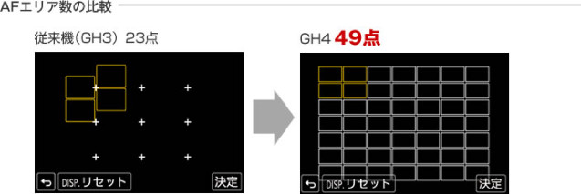

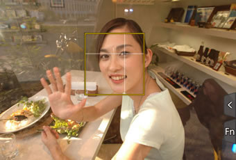

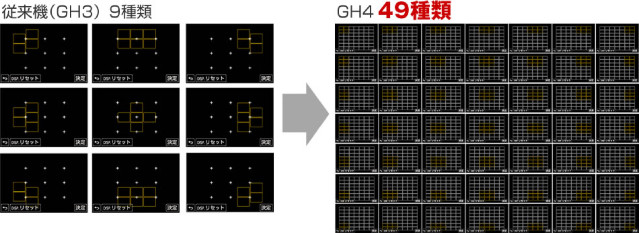

更快更多的自動對焦點、支援眼部對焦根據 Panasonic 表示,GH4 的自動對焦能力,又比其它自家機種更加精進,透過新導入的 DFD(Depth from Defocus) 技術,將每一顆 Panasonic 原廠鏡頭在各種光圈焦段之下的景深資訊做為演算參考,進一步縮短對焦時猶豫的時間,而達到 0.07 秒超高速 AF。另外,GH4 的對焦分割區域,也從 GH3 的 23 點提升為 49 點,並將臉部對焦強化為更精細的臉部對焦,可在找到畫面中人臉之後,對準眼睛的部位為最清晰範圍。而手動對焦時所需要的峰值對焦,這次 GH4 當然也如願以償追加了進來。
▲ 偵測到臉部時,會優先以眼睛部位為對焦優先。
▲ 自動對焦區域從原本 23 點進化為 49 點。
▲ 區域選擇模式也從 9 種大幅增加為 49 種。
236 萬畫素 EVF、104 萬畫素 LCD、機械快門壽命保證 20 萬次、NFC在其它規格方面,GH4 也比前代更加精進,包括與 GX7 相同的 236 萬畫素 16:9 比例 OLED 電子觀景窗,解析度 104 萬畫素的 3:2 比例電容觸控螢幕。同時 Panasonic 宣稱 GH4 在機械快門模式之下,擁有超過 20 萬張的快門壽命,當然如果使用者偏好電子快門的話,更是不會造成耐用度的消耗。而在原本就有的 WiFi 功能,這次 GH4 也追加了 NFC 近場通訊,能夠更簡單的和行動裝置配對。
機內 RAW 檔編修GH4 在拍攝 RAW 檔案格式的照片之後,可在機身選單內進行基礎編修,包括白平衡、曝光、色域、明暗曲線、飽和度、對比度、雜訊抑制和銳利度等,並維持 LUMIX 原廠風格的色彩詮釋與影像特質。
▲ Panasonic LUMIX GH4 機身背面與前代類似,但螢幕提升為 104 萬畫素,
以及 236 萬畫素 OLED 電子觀景窗。
▲ Panasonic LUMIX GH4 機身頂端,模式轉盤多了防止誤轉的按鈕。
Panasonic LUMIX DMC-GH4 重點特色
● 鎂鋁合金機身
● 支援防滴防塵,可在溫度 0 至 40 度 C、濕度 10% 至 80% 環境正常使用
● M4/3 尺寸 Live Mos 感光元件,1605 萬有效畫素
● 最佳化的低通濾鏡,能保留最高解像力、並減少摩爾紋
● 超音波除塵
● 全新超高速化 Venus Engine IX(4 CPU)影像處理引擎
● 感光度範圍:ISO 200 - 25600
● 快門範圍:靜態 60 至 1/8000 秒,支援 B 快門可達 60 分鐘曝光
● 閃燈同步可達 1 / 250 秒
● 內建閃光燈(GN12)
● 機身前端具備閃燈同步端子插槽
● 可翻轉 3 吋 104 萬畫素電容觸控式螢幕
● 具備 236 萬畫素 OLED 電子觀景窗,視野率 100%,放大率 134%(等效 67%)
● 獨立的白平衡、感光度、曝光補償快捷鍵
● 對比檢測式 49 個自動對焦點
● 0.07 秒超高速對焦
● DFD 對焦技術,機身內建全部 LUMIX 鏡頭的景深資訊,強化對焦演算效率
● 支援峰值對焦、眼部優先精細自動對焦
● 內建對焦輔助燈
● 完整解析度模式連拍可達每秒 12 張(儲存 100 張 JPEG 或 40 張 RAW)
● 持續自動對焦時可維持每秒 7.7 張連拍
● 144 區測光
● 內建 WiFi(IEEE 802.11b/g/n)可透過手機、平板操控,支援 NFC
● 電子水平儀
● 電子靜音快門
● 可彈性調整的錄影頻率,59.94Hz (23.98Hz) / 50.00Hz / 24.00Hz,micro HDMI 輸出 4:2:2,8bit / 10bit
● 可錄製 MOV 格式 Cinema 4K  4096 x 2160 @ 24p(高流量 100Mbps,IPB)影片,LPCM 音軌
● 可錄製 MOV / MP4 格式 QFHD 3840 x 2160 @ 30p(高流量 100Mbps,IPB)影片,LPCM 音軌
● 可錄製 MP4 格式 QFHD 3840 x 2160 @ 30p(高流量 100Mbps,IPB)影片,AAC 音軌
● 可錄製 MOV / MP4 格式 FHD 1920 x 1080 @ 60p(高流量 200Mbps,ALL-Intra)影片,LPCM 音軌
● 可錄製 AVCHD  格式 1080 @ 60p(高流量 28Mbps)影片
● 影片支援 Time Code
● 錄影支援慢動作模式
● 錄影支援快動作模式
● 快動作與慢動作錄影皆支援 1080p
● 具備 3.5mm 麥克風插孔、耳機插孔
● 具備 2.5mm 線控插孔
● 儲存媒介採用 SD / SDHC / SDXC 記憶卡(支援 USH-I C3 高速傳輸)
● 支援 DMW-YAGHE 外接式底座
● 採用型號 DMW-BLF19 的 1860mAh 充電式鋰電池,每次充電可拍攝 500 張
● 體積 133 x 93 x 84.0 mm,重量約 480 公克(單機身)/ 560 公克(含電池、記憶卡)
▲ LUMIX GH4 可支援全新開發的 DMW-YAGHE 外接式專業級錄影底座。
▲ DMW-YAGHE 底座背面。
▲ DMW-YAGHE 底座側面。
官方實拍範例以下擷取幾張 Panasonic 所釋出的 LUMIX GH4 實拍範例,但僅有縮圖,更多照片請參考官方網站

請問樓主
Although all the GH4 internal codecs are 8bit 4:2:0, according to Mr Uematsu-san the internal signal processing is all 4:2:2......
假如我只有用sd 卡來錄影. 不想買底座
那麼  錄影格式只有8bit 4:2:0嗎?
或者換成這樣子請問gh4  得透過底座
輸出的格式才有4:2:2 的8/10 bit  嗎???
發表於 2014-2-19 12:08:11 | 顯示全部樓層
Panasonic 原廠為 GH4 所推出的線上藝廊所提供的 4K 畫質影片真得很細
 樓主| 發表於 2014-2-20 18:06:59 | 顯示全部樓層
findingnemo 發表於 2014-2-19 10:33
請問樓主
Although all the GH4 internal codecs are 8bit 4:2:0, according to Mr Uematsu-san the intern ...
GH4 機身錄製SD速度是 8bit 4:2:0 200Mbit ALL-I and 100Mbit IPB
要更高流量必須外接記錄器 ,機身HDMI 是 1080P 4:2:2,8bit / 10bit
要4K高流量必須用底座的 3G SDI 接記錄器
