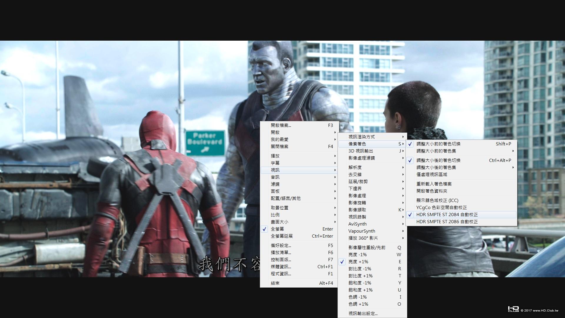

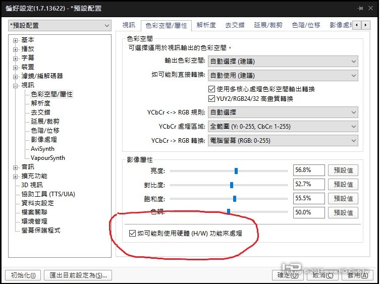

選項
選項

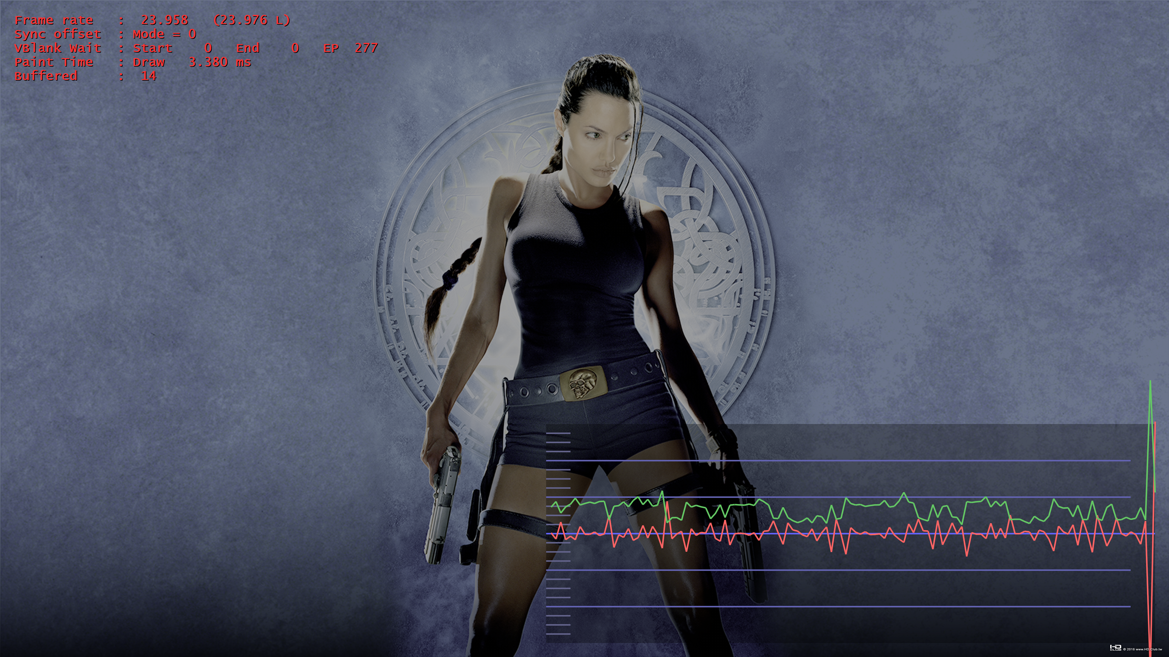

校正前
校正前

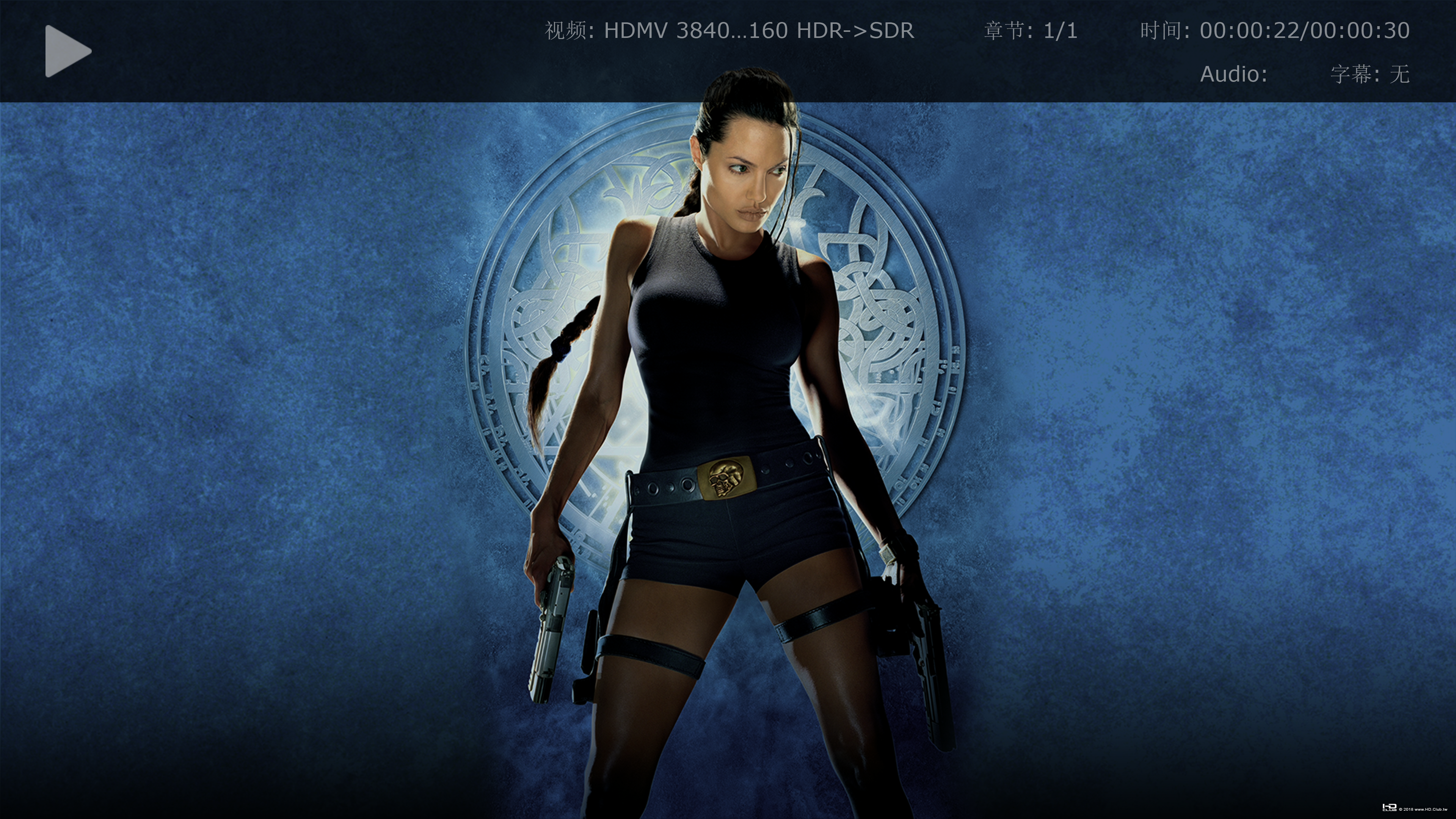

校正後
校正後

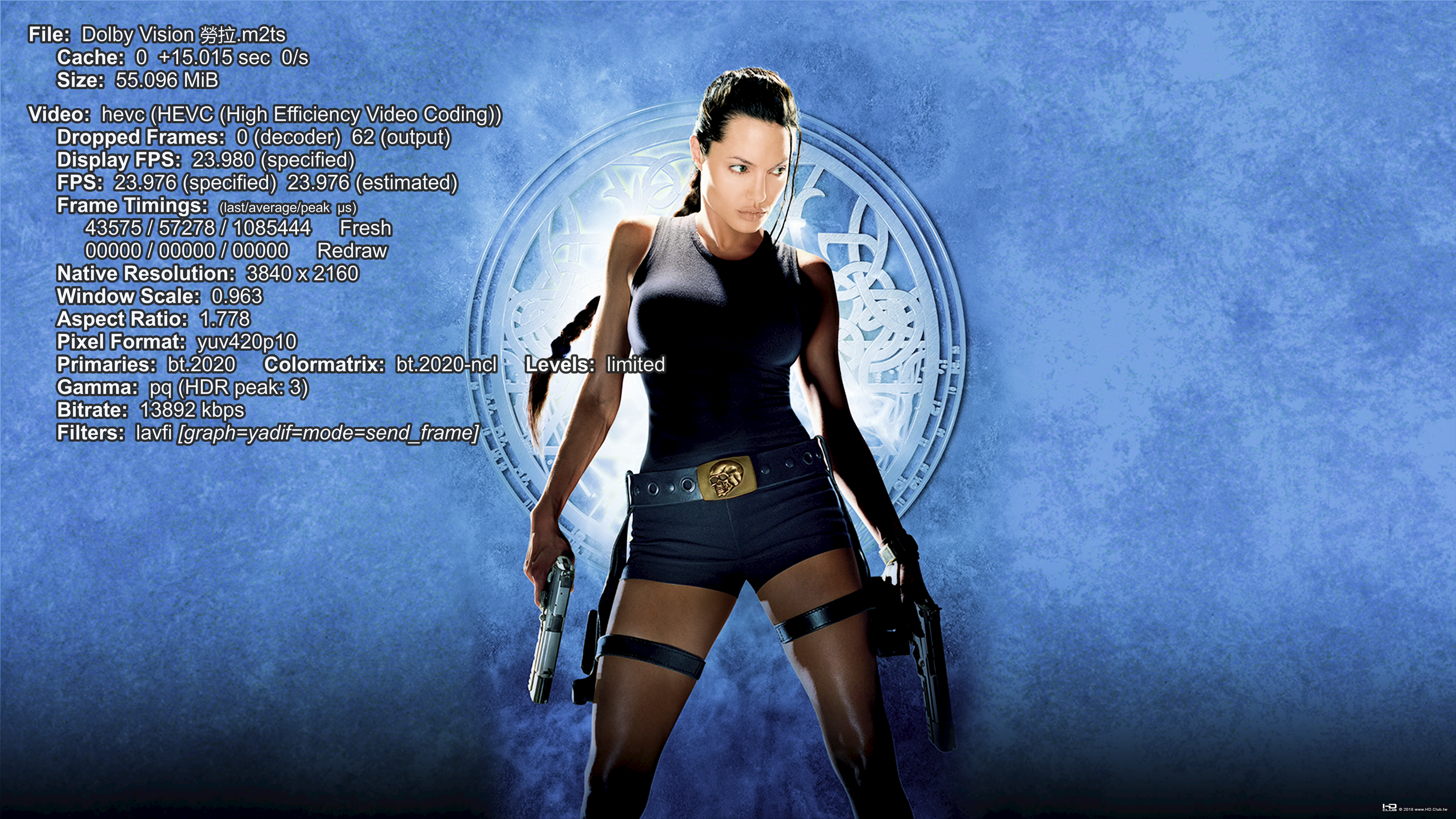

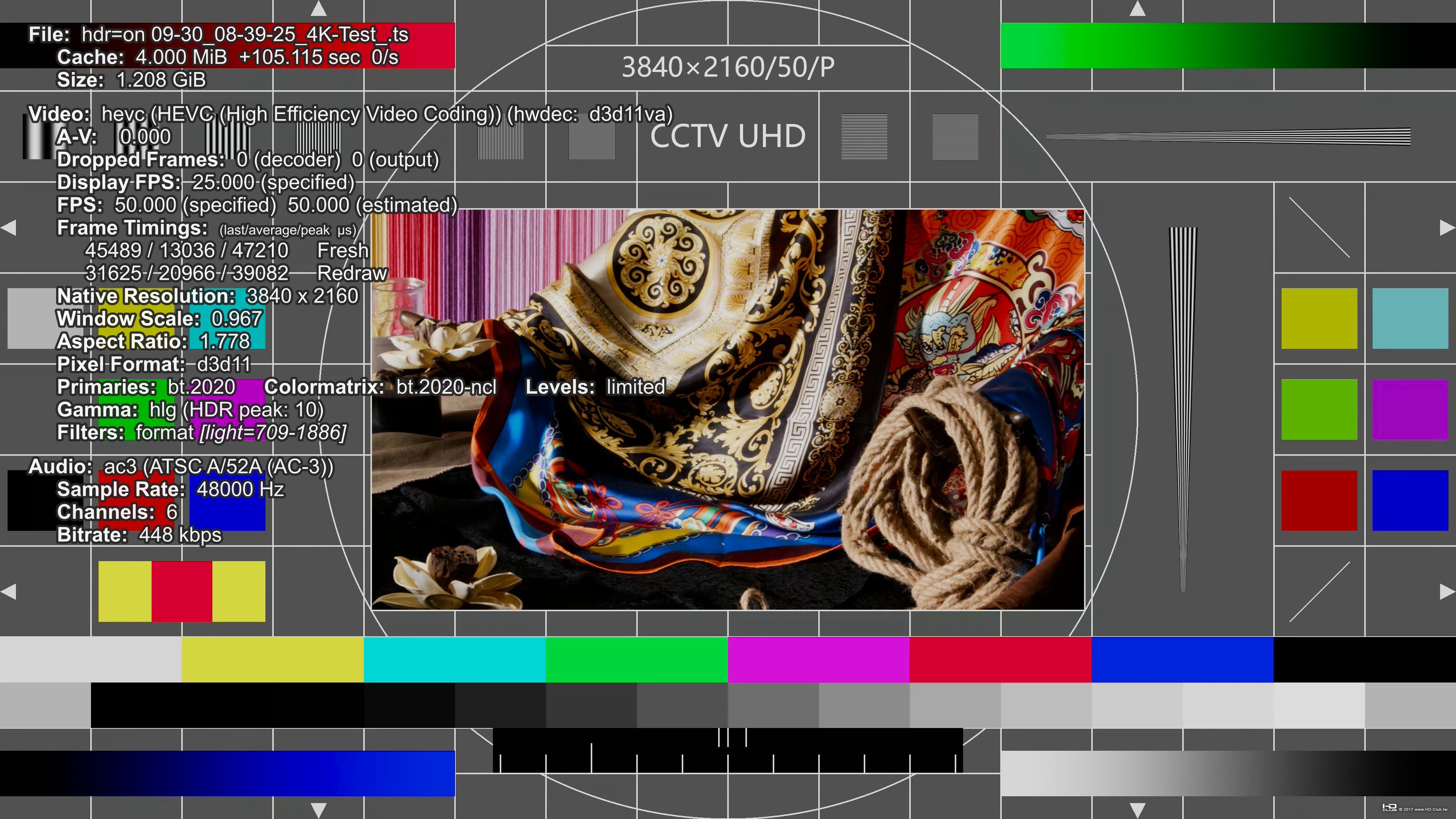

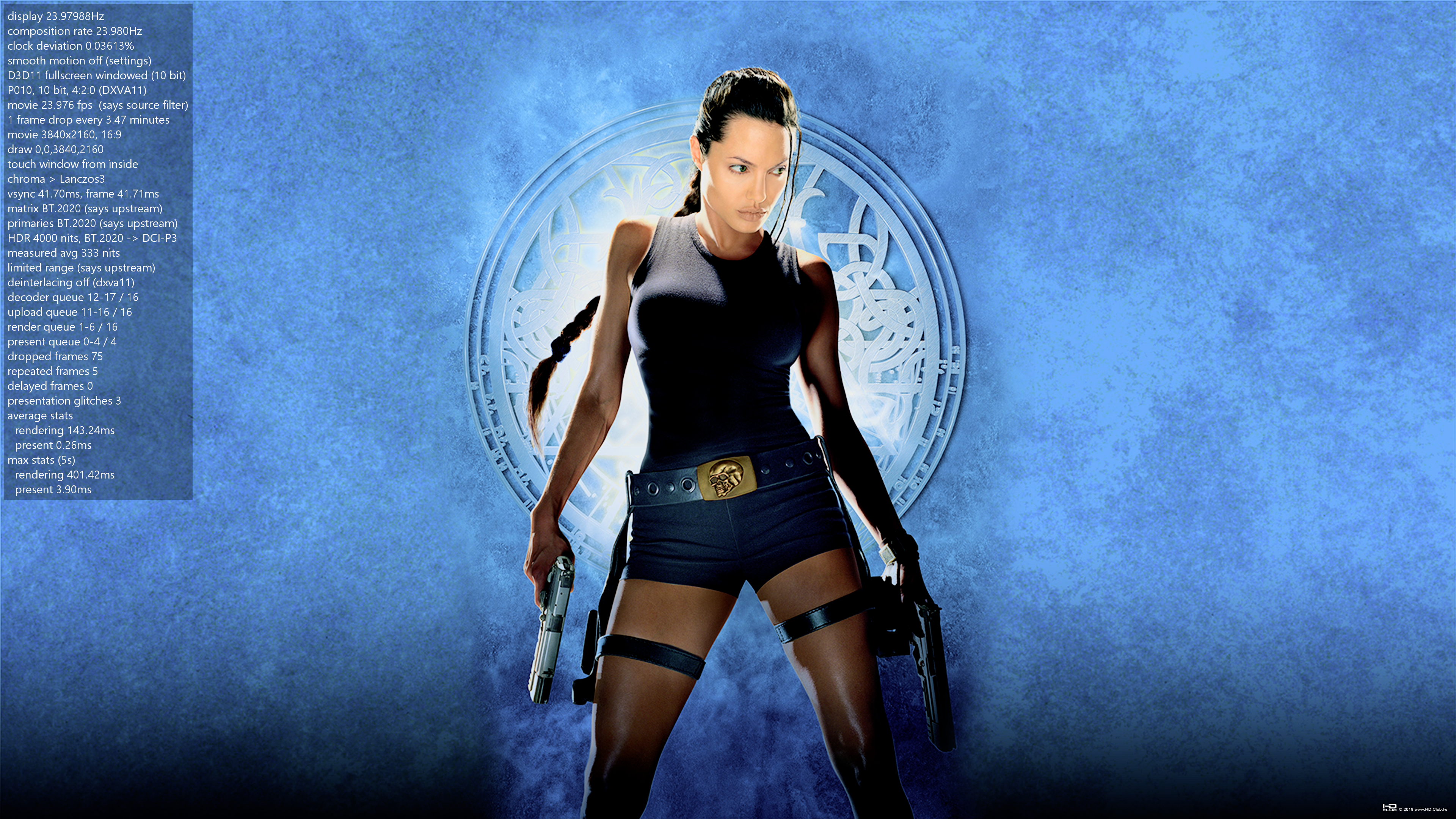

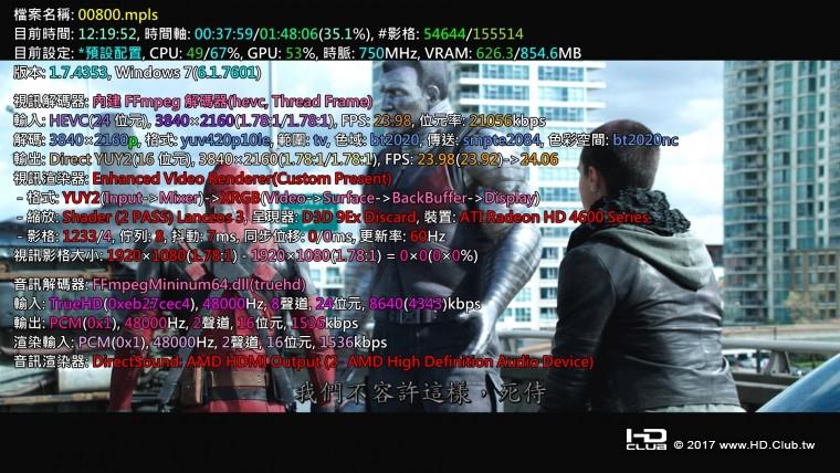

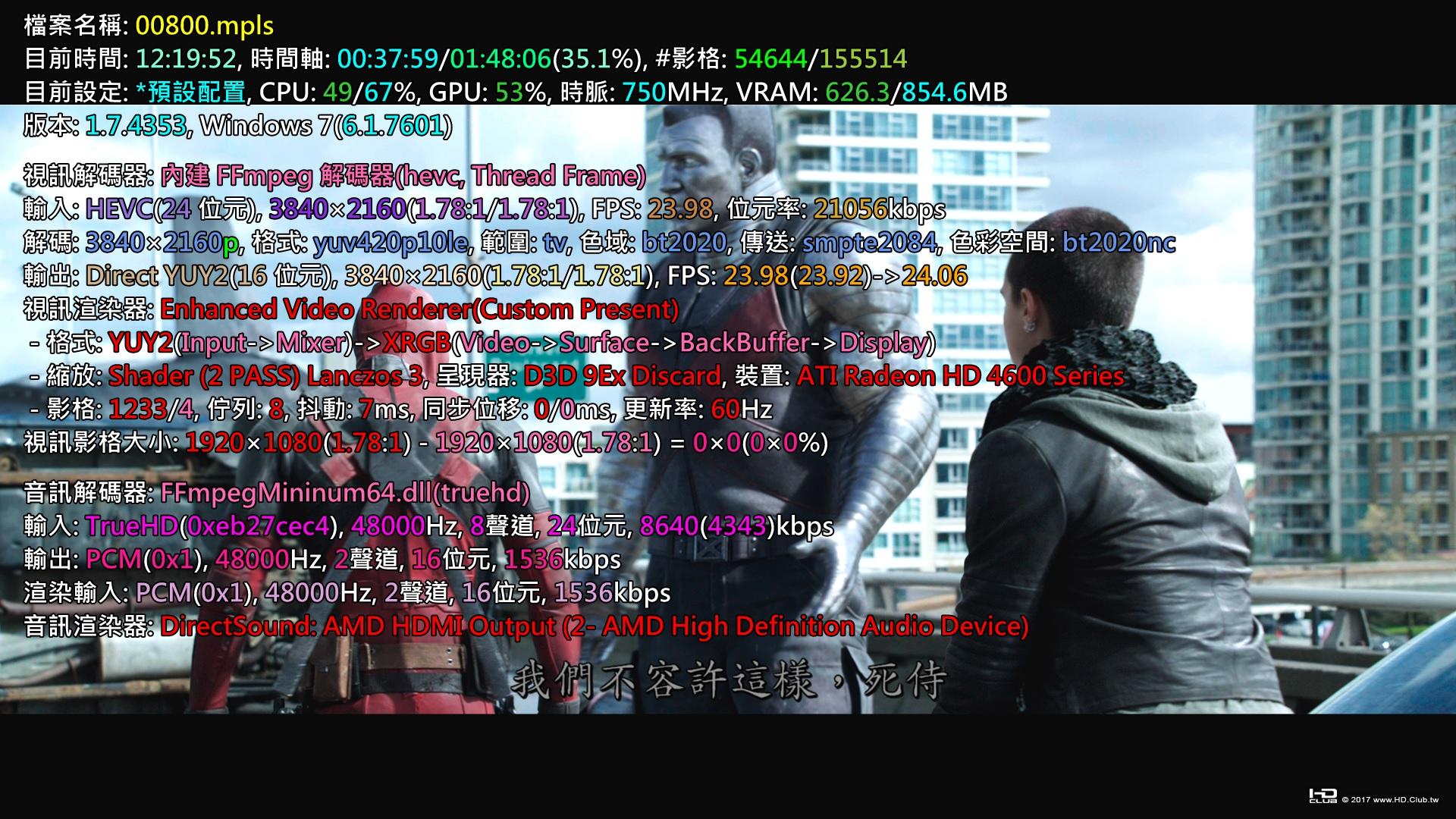

CPU與顯卡所耗用量
CPU與顯卡所耗用量

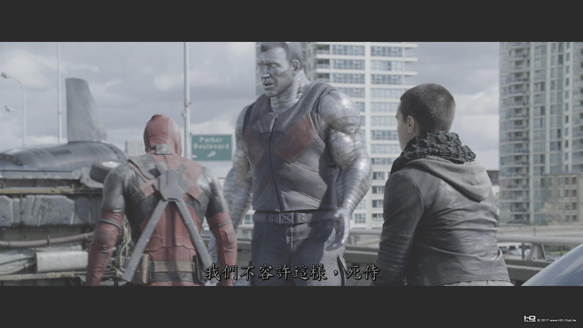

發表於 2017-12-18 16:23:48 | 顯示全部樓層
本文章最後由 astroboy 於 2017-12-18 16:42 編輯
6hzzz 發表於 2017-12-2 14:11
最新版的MPC-BE,全部使用內置解碼器+EVR渲染器也支持HDR2SDR了。
MPC-BE
昨日測試已成功播放,畫面提升超有感,顏色也比之前網兄推薦的Potplayer/ MPC-HC更正確,音質畫質都相當不錯,感謝分享!

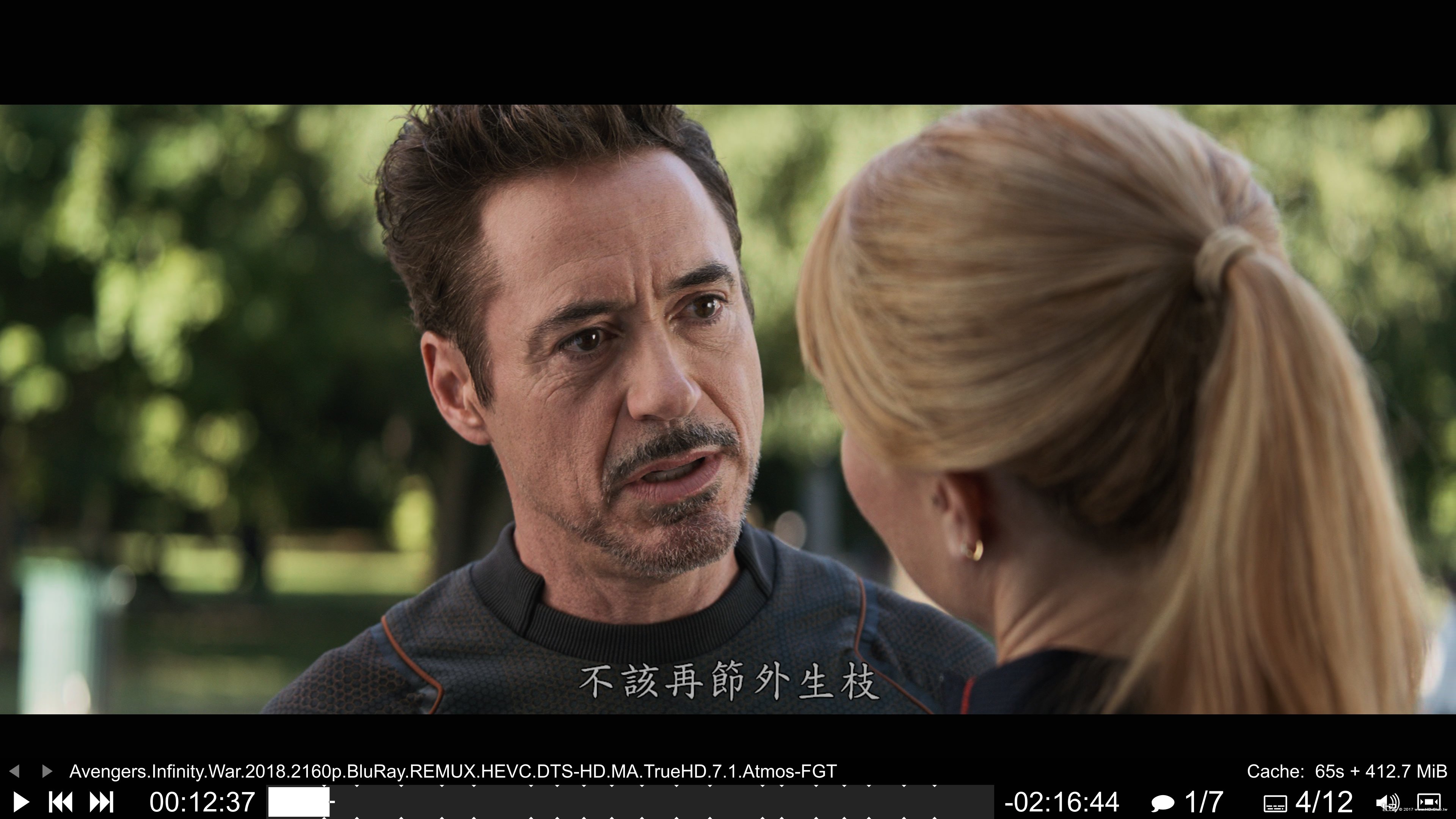

 樓主| 發表於 2018-3-9 14:26:16 | 顯示全部樓層
來來來簡單做個PK好了
本文最後由 6hzzz 於 2019-6-26 02:00 AM 編輯
HDR2SDR PK
MPV:
MPV高渲染模式:

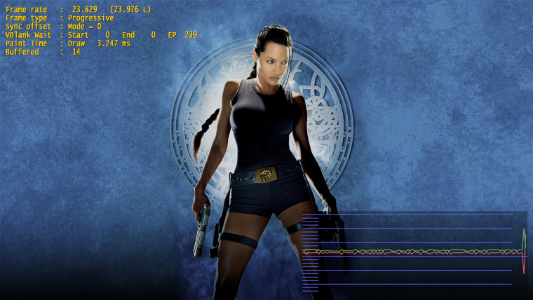

MPC-HC+LAV+madVR:
MPC-BE+madVR:
MPC-HC+LAV+EVRCP:
MPC-BE+EVRCP:
DVDFab Player 5:
madVR實時動態映射:

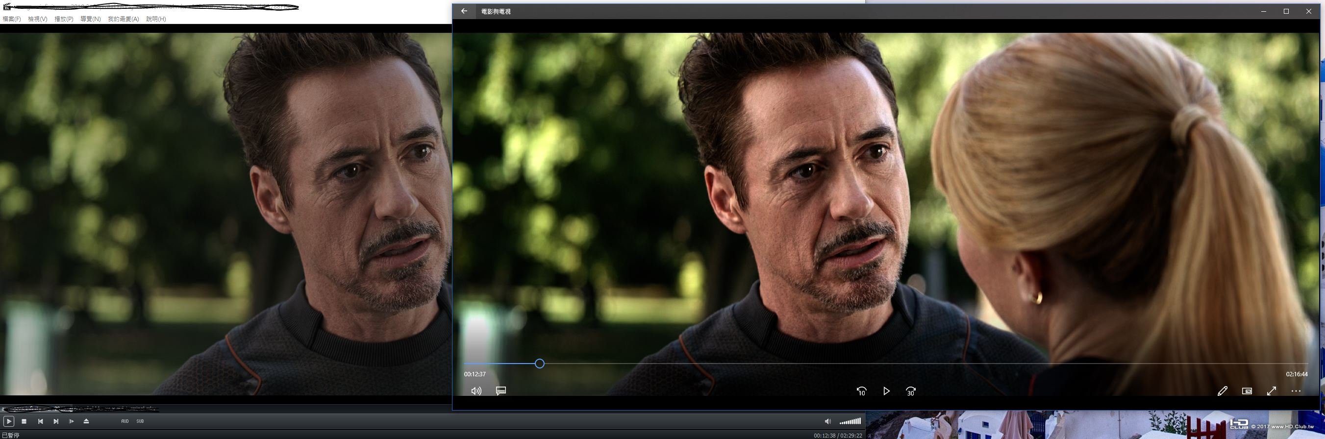

本帖最後由 kingofway 於 2018-8-22 10:01 PM 編輯
各位老大哥們好,小弟爬了文照了設定,但是發現沒法跟 Win10 Movie&TV 一樣
請問該怎麼用其他撥放器達到與 Win10 Movie&TV 一樣畫面哩???
感謝
配備:不是 HDR 的螢幕
沒有 HDR 的顯卡 GTX-980

發表於 2018-8-25 15:34:04 | 顯示全部樓層
hi 6hzzz 大您好
請問您發的這兩組都是 HDR2SDR 的設定嗎?
那 Movie&TV 是給出完整 HDR 嗎?

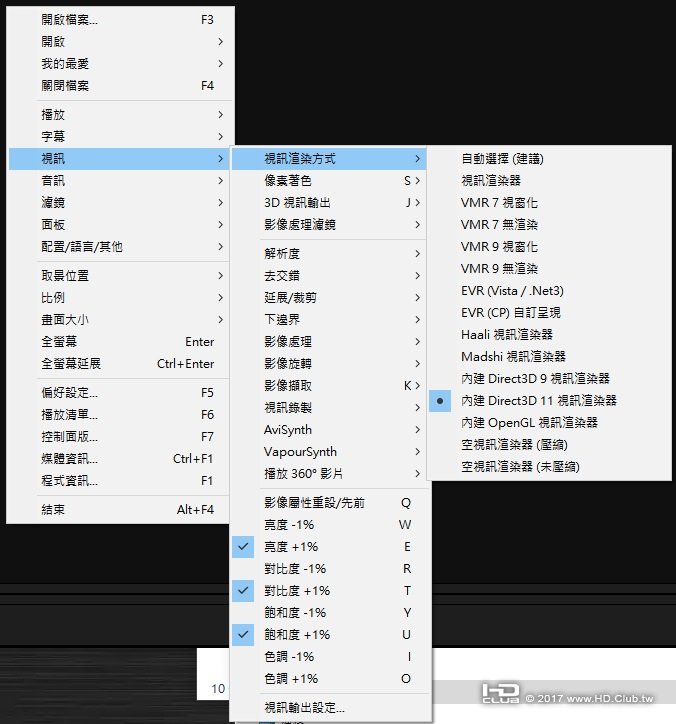

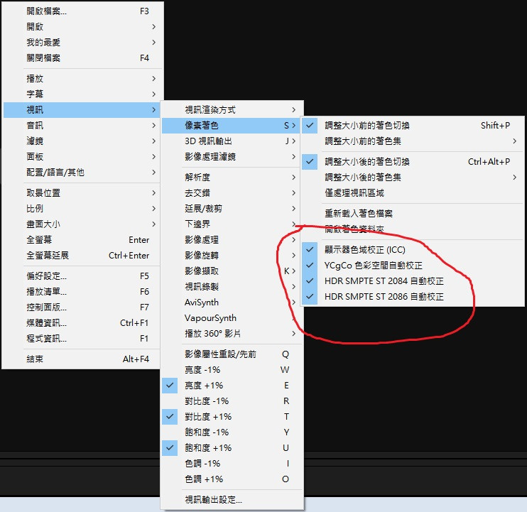

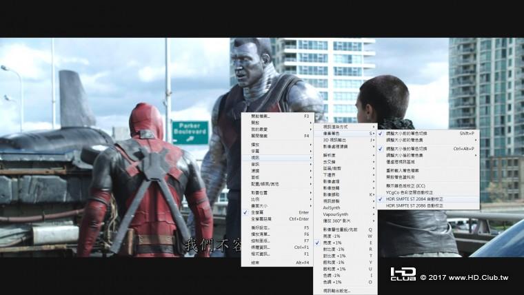

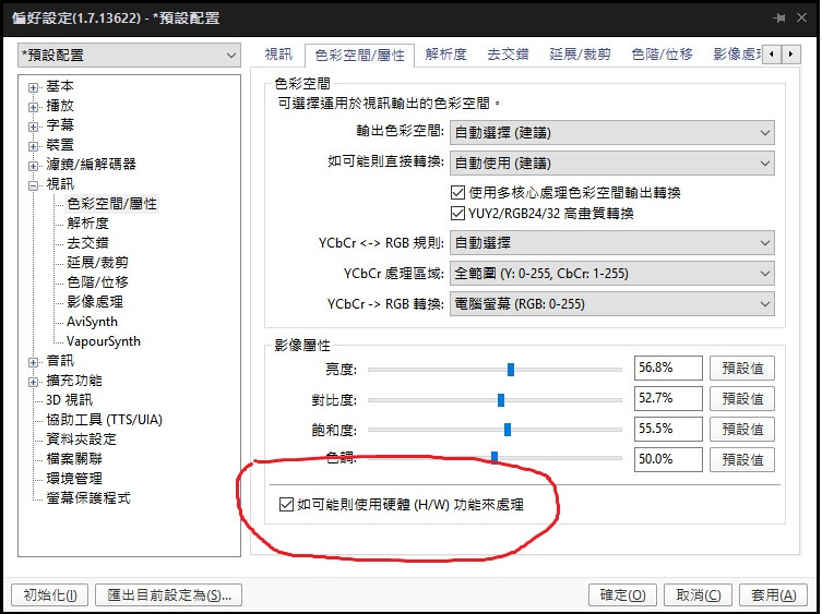

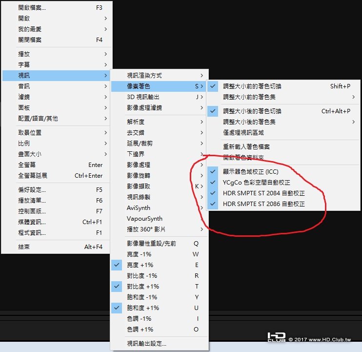

發表於 2018-8-25 17:37:21 | 顯示全部樓層
自問自答,找到讓 PotPlayer 輸出自己理想畫面的設定了
在這邊分享一下,設定後比 Movie&TV 還要棒
亮度,對比度,飽和度,再依照自身螢幕去調整

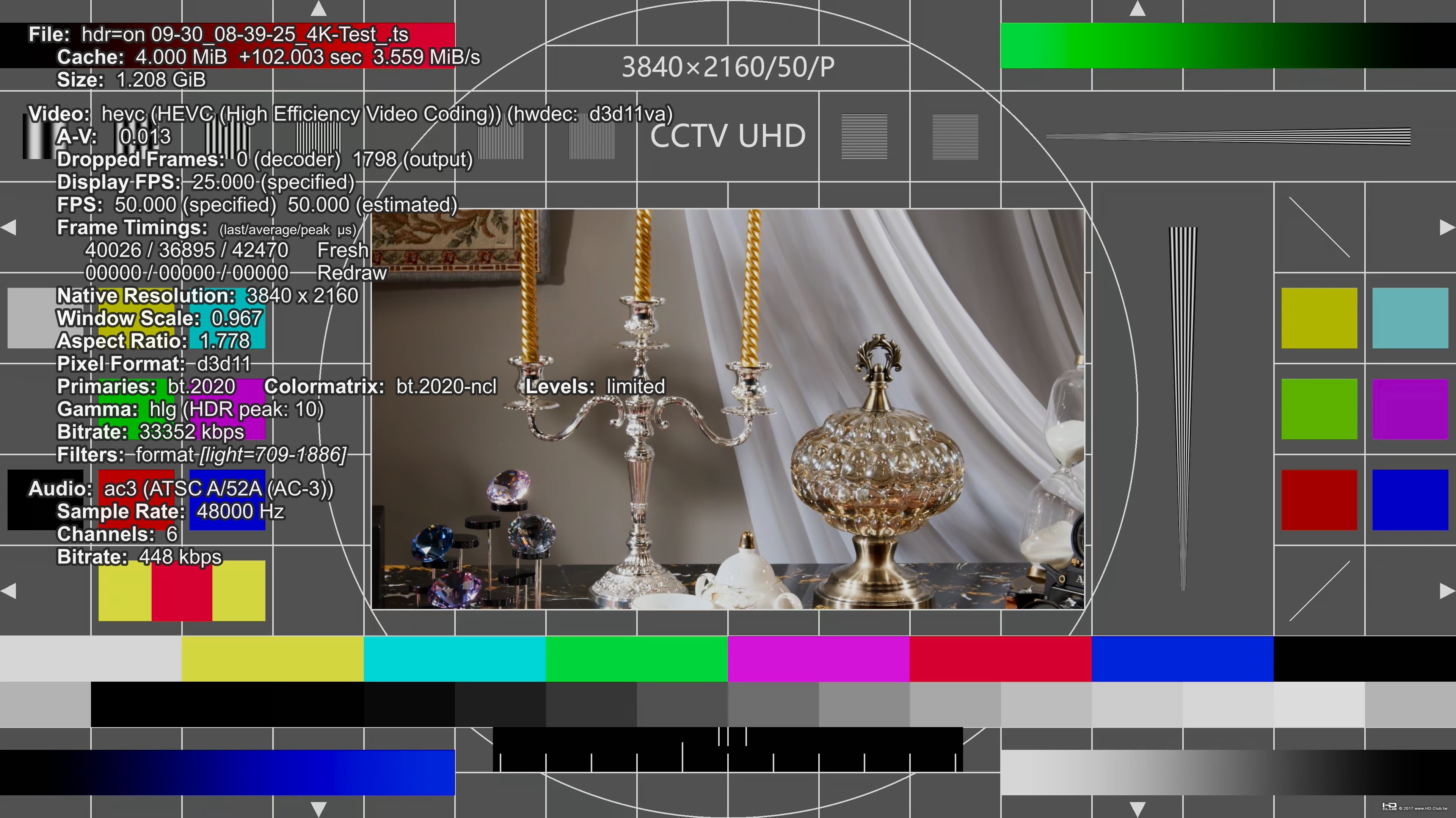

MPV HLG2SDR測試:

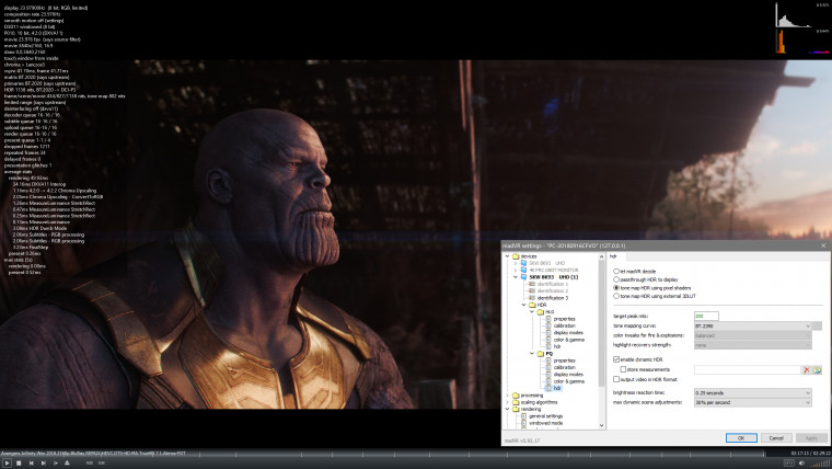

 樓主| 發表於 2018-10-29 21:52:37 | 顯示全部樓層
本帖最後由 6hzzz 於 2018-10-29 09:55 PM 編輯

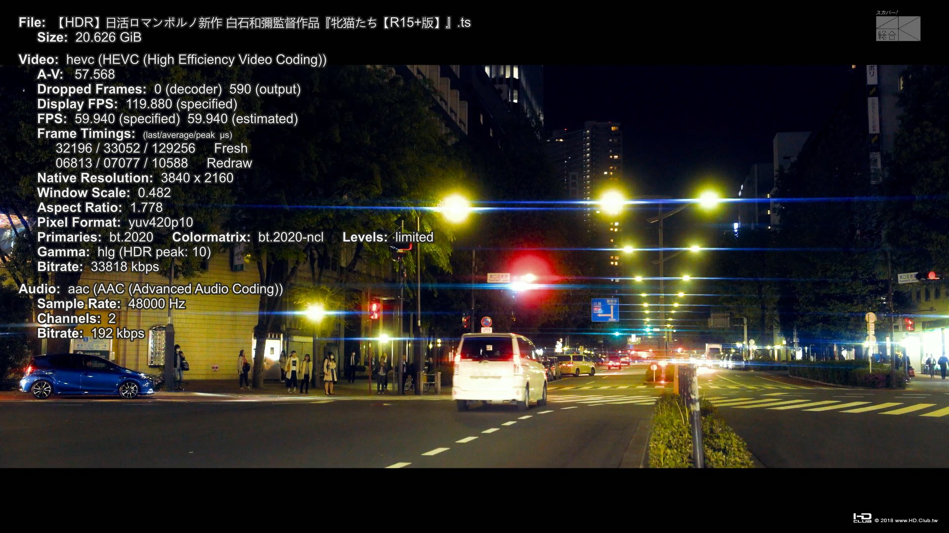

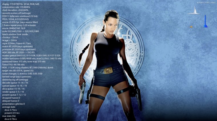

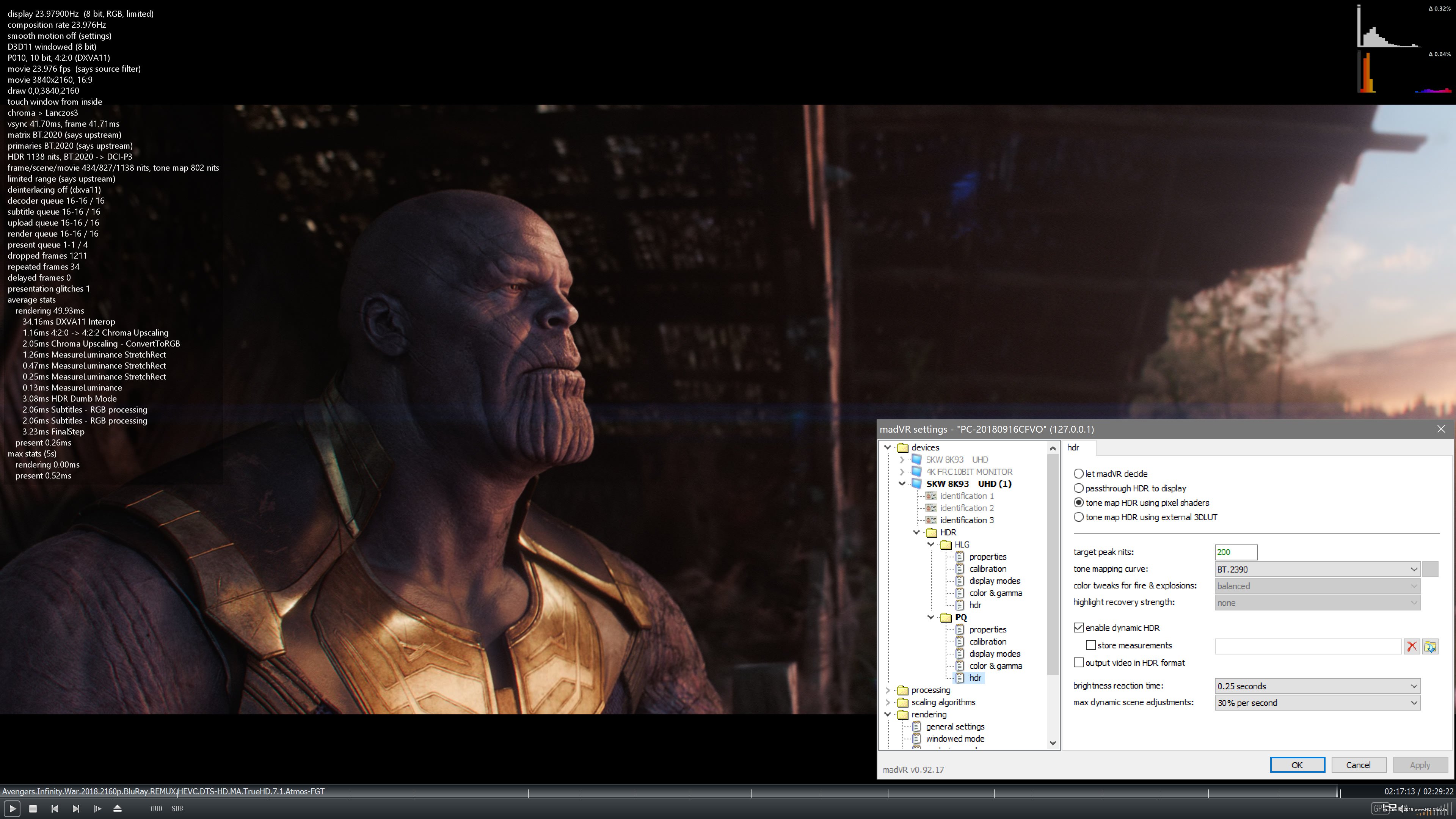

開啟動態映射模式
New test build:
http://madshi.net/madVRhdrMeasure24.zip
Sorry, guys, due to the bugs, you have to redo all measurements. Because of that I've now also taken the "opportunity" to modify the file format once more. I'm now storing almost all information I measure, including the measured peak and histogram for every frame. I'm currently not making use of the histogram in madVR (other than for the OSD). But having all information in the measurement file means we hopefully may not have to re-measure in the future (unless the resolution of the histogram isn't high enough for some reason).
The new measurements files get much bigger now, because I'm storing the histograms. Is that a problem for anyone?
There's a new option called "max dynamic scene adjustments". If you disable it, madVR will use an optimized but constant tone mapping curve for each scene, similar to how HDR10+ will work, and exactly the same as the previous madVR test builds behaved. If you enable the "max dynamic scene adjustments" option, madVR will dynamically adjust the tone mapping parameters within each scene in such a way, that darker time periods in each scene will be compressed less than brigher time periods. This is done in such a way that there will never ever be clipped highlights. The only possible disadvantages of this new algorithm compared to disabling it is that you might be able to see the change in tone mapping parameters. However, if you choose a relatively low % number, it should be pretty much invisible, but provide a fair brightness and pop boost, for long scenes that vary a lot in peak brightness. This new algo is something that HDR10+ will (as far as I understand it) *not* be able to do. So we may actually have a solution now which is better than HDR10+.
Of course the new algo needs serious testing to make sure there are no unexpected bugs. And we need to decide which config for the new algo is the "best". Let me know what you think!
A good scene for a quick test would be the "Mother" scene (posted earlier in this thread, IIRC) where Jennifer turns on a lamp in a dark zoom. The same scene starts at 6nits, but then goes up to almost 1,000nits, *without* a scene change. With the new option disabled, madVR tone maps the whole scene to nearly 1,000nits. With the new algo enabled, the beginning of the scene is rendered without any compression, and tone mapping then ramps up slowly (depending on the config) and smoothly, and early enough so that when the lamp is turned on, the tone mapping is already at 1,000nits, so there's zero clipped highlights.
原帖地址:
https://www.avsforum.com/forum/2 ... 3.html#post57028034

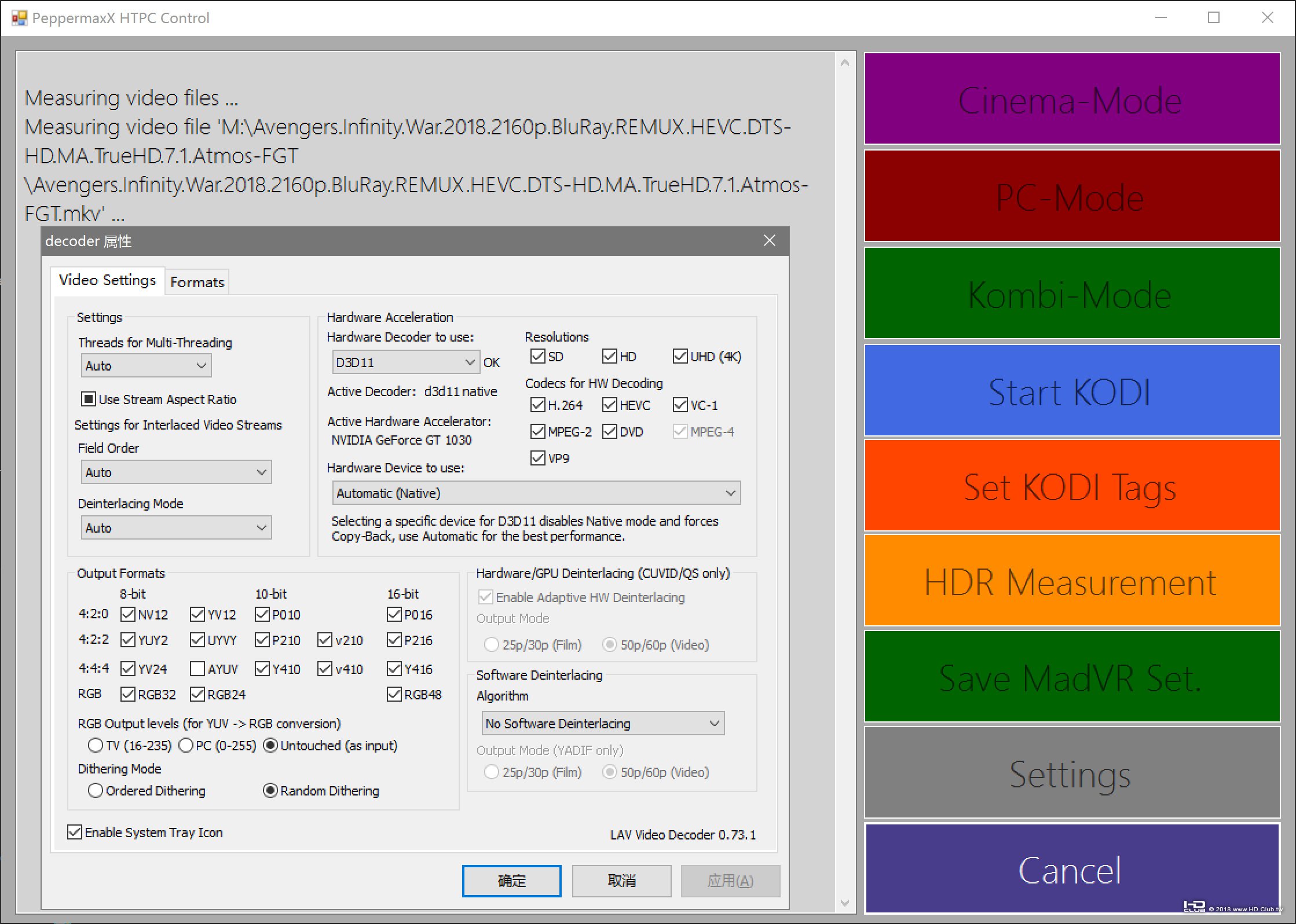

 樓主| 發表於 2018-10-30 14:14:57 | 顯示全部樓層
本文最後由 6hzzz 於 2019-6-25 05:41 PM 編輯

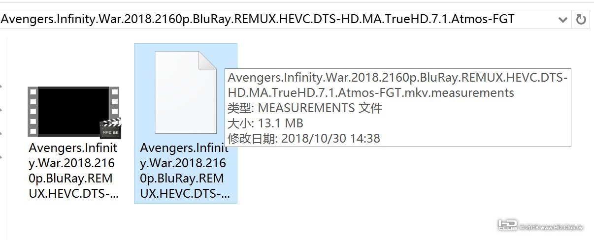

過程簡要
對HDR檔進行測量,得到HDR測量檔。測量速度與PC配置成正比。
有了測量檔,播放時可減輕做實時映射的壓力。

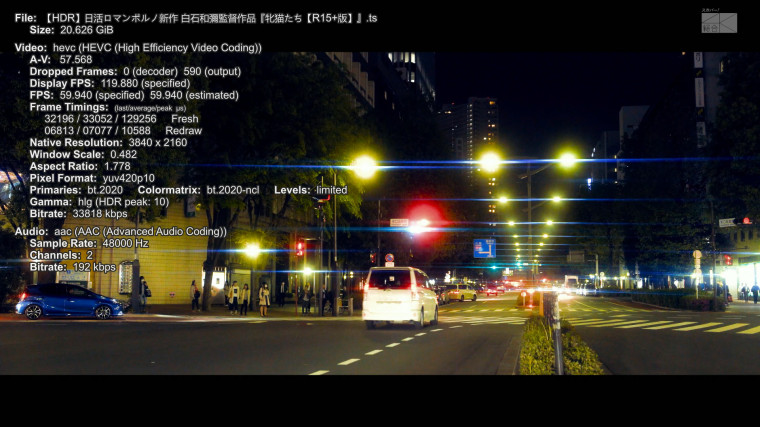

播放時的OSD
更新:
http://download.seven-c.de/files/madvr/htpccontrol.zip
 樓主| 發表於 2018-11-2 15:54:51 | 顯示全部樓層
New test build:
http://madshi.net/madVRhdrMeasure27.zip
1) Added some workarounds/improvements for incomplete measurement files. Will not solve all problems! But maybe some.
2) Incomplete measurements files are still created, but now get the file name extension ".measurements.incomplete", and are ignored by madVR.
3) madVR no longer stores/remembers measurements during playback, because those were often incomplete, anyway.
4) Simplified settings dialog.
5) Dynamic intra-scene optimizations are now always active, if a (complete) measurement file is available.
6) Dynamic intra-scene optimizations now vary between min 4% and max 20%, depending on the situation.
7) Dynamic intra-scene optimizations are now carefully post processed / smoothed.
8) Dynamic intra-scene optimizations are now only done for 4+ second scenes. Shorter scenes are tone mapped to the scene's peak. 9) Fixed problem with histogram adding up to 106.67% instead of 100%. 10) Live algo: Added 3rd percentage value to histogram "flicker risk".
發表於 2018-11-5 11:36:08 | 顯示全部樓層
6hzzz 發表於 2018-10-30 02:14 PM
過程簡要
先對HDR檔進行測量,得到HDR測量檔。測量速度與PC配置成正比。
先對HDR檔進行測量,得到HDR測量檔。測量速度與PC配置成正比。使用HtpcControl對hdr檔進行測量是否支持BDMV文件夾?壹般壹部影片的測量時間大致是多少呢?我這試了下10分鐘測量不出結果,也不報錯,只能点cancel终止了。
發表於 2018-11-5 12:11:00 | 顯示全部樓層
過程簡要
htpc control setting設置成如下
madvr path    C:\Program Files (x86)\Pure Codec\madVR\
R:\Transformers.The.Last.Knight.2017.2160p.UHD.IMAX.Blu-ray.HEVC.TrueHD7.1.Atmos-FiNalHD@HDSky
直接失敗,請問這是什麽原因?
Measuring video files ...
0 Measurement files deleted
0 File(s) : No HDR
0 File(s) : Measurement File Created
0 File(s) : Not Completed
 樓主| 發表於 2018-11-5 12:16:48 | 顯示全部樓層
ejizhan1978 發表於 2018-11-5 12:11 PM
R:\Transform ...
片源是MKV還是原盤?
mkv文檔支持很好,可直接測量,原盤m2ts檔我是改成ts後可以進行測量,測量完成後再改回m2ts,測量檔名稱也一併改之.復聯3我這大概用了不到20分鐘吧.
發表於 2018-11-5 12:43:10 | 顯示全部樓層
6hzzz 發表於 2018-11-5 12:16 PM
片源是MKV還是原盤?
mkv文檔支持很好,可直接測量,原盤m2ts檔我是改成ts後可以進行測量,測量完成後再改回 ...
感謝,我稍後改改ts後綴試試。
 樓主| 發表於 2018-11-5 12:55:41 | 顯示全部樓層
ejizhan1978 發表於 2018-11-5 12:43 PM
感謝,我稍後改改ts後綴試試。
測量用時我記錯了,應該是不到30分鐘,剛測量了一部Ghost.in.the.Shell.1995.2160p.mkv用時28分鐘.
