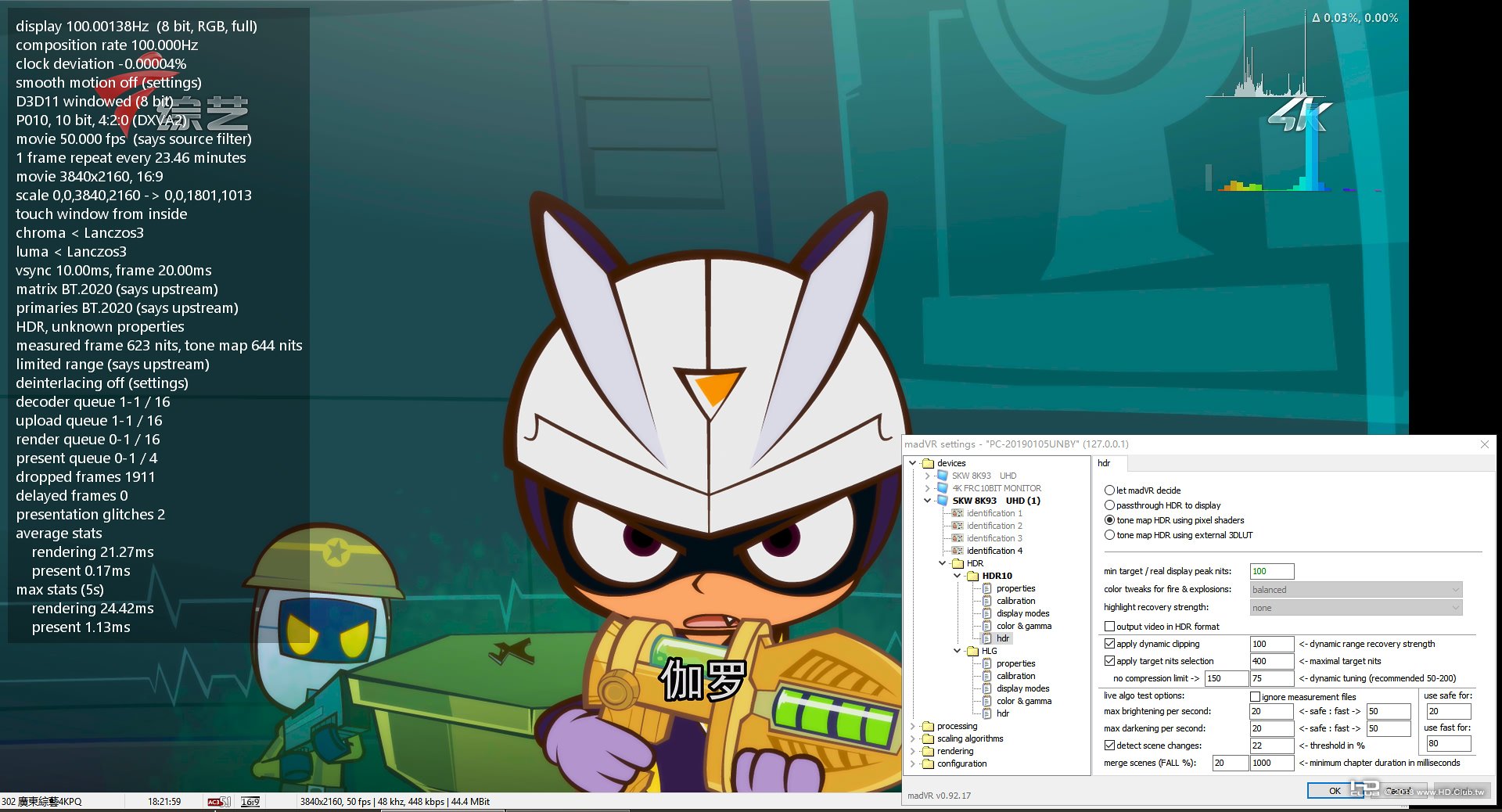

Here comes the next test build:
http://madshi.net/madVRhdrMeasure44.zip
Changes:
1) Changed defaults to safe: 30; fast: 1000; threshold: 26.
2) Added options that let you specify when to use "safe" vs "fast" exactly. Defaults are 20 and 80 (which means a 2.0x and 8.0x target nits difference), which are identical to build 43. It might make sense to use a lower values than 20 to define the "safe" starting point, and then to lower the "safe" speed to something less than 30.
3) Added the following line to the OSD: e.g. "target nits dif: 2.00, speed: 30.0". Or e.g. "target nits dif: 8.00, speed: 1000.0". This lets you see which "safe" vs "fast" speed madVR selected for each scene and why.
4) I copied the "merge scenes (FALL change in %)" feature from Anna&Flo's tool to the live algo. So now there are 2 thresholds which both have to be fulfilled to trigger a scene/chapter change: There's the scene detection threshold, with a current default of 26%. And then there's the FALL change in %, which currently defaults to 20%. The default for the FALL change in Anna&Flo's tool is set to 100. But that's far to high for my math. I'm not sure where the difference is coming from, to be honest, but it shouldn't matter. In any case, you will probably have to use different values for this setting in madVR, compared to Anna&Flo's tool.
I'm not actually sure if the new "merge scenes (FALL in %)" feature is a useful addition to the live algo or not. Please give it a try and let me know. You should be able to disable this by entering a 0 value to go back to the previous behaviour to only look at the scene change threshold.
5) I've added the detected FALL % change to the luminance histogram (the 2nd number), for your information.
Sorry to add even more options than before! I know it makes testing even more complicated and time consuming. But I guess it can't be avoided if we want to optimize the sh** out of the live algo.
串流測試
