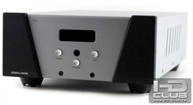

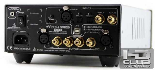

Wyred 4 Sound的DAC-2:
美金定價:$1.499
DAC-2內部採用ESS的32bit DAC晶片,32bit的音量控制器,分砌式類比輸出級,全平衡架構,24/192非同步USB輸入端....
W4S DAC-2 Features:
ESS Reference audio (ES9018) 32 bit DAC
W4S proprietary discrete output stages for optimum sonics
ESS Time Domain Jitter EliminatorR
Automatic oversampling for precise output filtering
Fully balanced design with balanced and unbalanced outputs
Upgradable Digital, Output, and USB boards (designed for future improvements)
Oversized toroidal transformer for solid and noise-free power
88,000uF of filtering with W4S low ESR "super-cap" (same as used in the STP-SE)
VFD display for input, sample rate, volume control, and configuration viewing
Remote control
Defeatable - 32 bit volume control
HT Bypass inputs (selectable via DC trigger)
2x Coax inputs
2x Toslink inputs
1x AES/EBU input
1x Balanced I2S input via HDMI cable (not standard HDMI cable format)
24-bit 192kHz Asynchronous USB input
Proprietary drivers for 32/64 bit Windows XP, Vista, 7 and Mac OS 10.4, 10.5 ,10.6
Factory selectable mains  115/230VAC
Compact size (8.5"W x 4.125"H x 13.5"D)
16 lbs.
Covered by a 3 YEAR WARRANTY
原廠介紹:
http://www.wyred4sound.com/webap ... ;find_groupid=18157

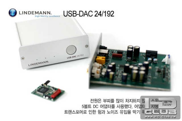

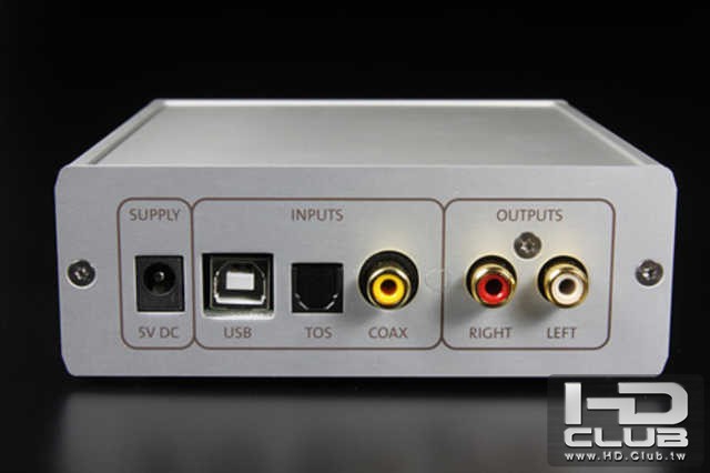

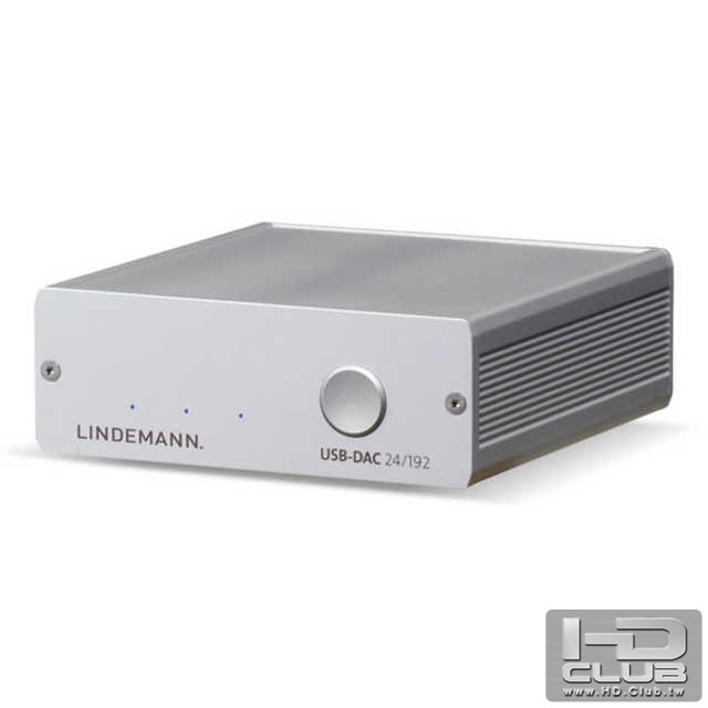

Lindemann USB-DAC 24/192:
器材規格:
Digital inputs         USB-B / TOSLINK / COAX
Supported sample-rates TOS/COAX        32 / 44.1 / 48 / 88.2 / 96 / 176.4 / 192 kHzSupported sample-rates USB        44.1 / 48 / 88.2 / 96 / 176.4 / 192 kHz
Resolution         16 or 24 bit
Analog
Output voltage         1.4 V @ 0 dBFS
Output impedance         100 Ω
S/N (A-weighted)         -108 dB
THD (0 dBFS)         < 0.02 %
THD (-10 dBFS)         < 0.001 %
Dynamic range         120 dB
Frequency response         1Hz-22kHz (-3dB)
Dimensions         120 x 45 x 133mm (W x H x D)
Weight         395 g
Power consumption         5V/500 mA maximum

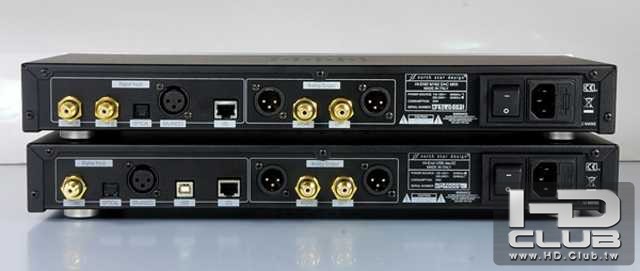

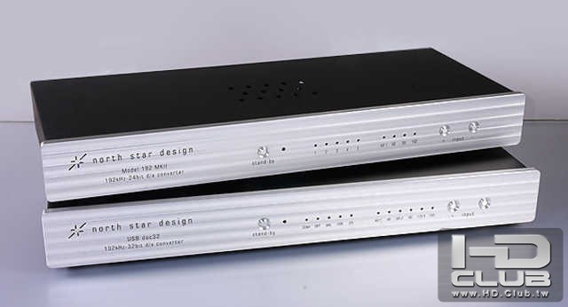

North Star Design Dac 32
器材規格:
數位輸入規格:32-192kHz,最高32bit。
動態範圍:126dB(24bit輸入時)
訊噪比:112dB
輸入端子:同軸×1、光纖×1、AES/EBU×1、I2S×1、USB 2.0×1
輸出端子:非平衡式(RCA)×1組、平衡式(XLR)×1組
尺寸:43.3×17×6cm(W×D×H)
重量:5公斤
 樓主| 發表於 2011-2-2 09:36:19 | 顯示全部樓層

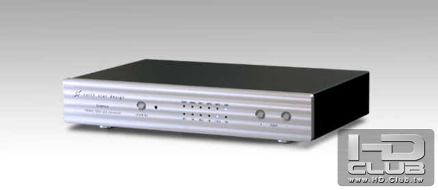

North Star Design essensio規格:
North Star Design essensio是簡化版,拿掉XLR、剩下一顆變壓器.
輸入取樣頻率:32kHz - 192kHz,up to 32 bit
動態範圍:123dB(24 bit input)
訊噪比:109dB
數位輸入端:二組S/PDIF(二組RCA同軸,三組Toslink光纖),
一組USB 2.0埠
類比輸出端:一組RCA鍍金端子
電源:115V,60Hz,15VA
尺寸:30(寬) x 17(深) x 6(高) cm
重量:3.0 Kg
 樓主| 發表於 2011-2-2 09:40:21 | 顯示全部樓層

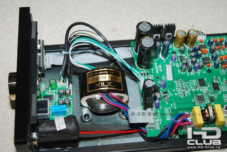

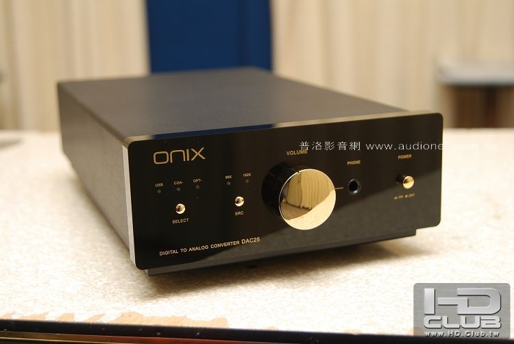

ONIX DAC25規格:似乎USB部分只能到16Bit/48kHz...
這台的好處是,電源的部分用上了高品質雙C-Core變壓器,數位、類比及控制電路採獨立供電,每聲道用上了兩只雙OP,電路是標準的真平衡設計,看得出用心.
Features:
1. Use 24bit/192KHz high precision DAC chip
2. Use asynchronous sampling chip to raising frequency at 192KHz with lower jitter
3. High precision clock system, it has Reclock function and reduce error code efficiently
4. USB input connect to the PC and realize the hi-fi sound through PC
5. Digital input plus pulse transformer as a good separation
6. Analog balance output
7. Headphone amplifier monitor
Specifications:
1. Dynamic range: (24bit) > 120dB
2. Signal noise rate: > 112dB(RCA); > 125dB(XLR)
3. THD+N: < 0.001%(20Hz-20KHz)
4. Output amplitude: 2VRMS
Main materials:
1. PCM2704 as USB sound card chip
2. PCM1792 24bit/192KHz DAC chip
3. SRC4192 upsamping chip
4. 3pcs OPA2134 op-amps
5. CS8416 digital receiver chip
6. R style transformer

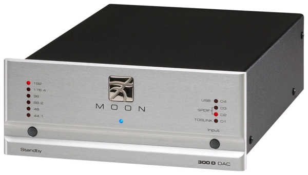

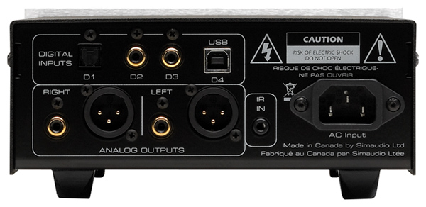

Moon 300D器材規格:
USB端子最高僅支援16bit/48kHz,數位同軸或光纖支援24bit/192kHz
型式:USB DAC
數位輸入:RCA同軸×2、光纖×1、USB(Type B)×1
數類轉換晶片:BurrBrown PCM1793
類比輸出:RCA×1、XLR×1
支援取樣頻率(光纖、同軸):44.1、48、88.2、96、176.4、192kHz
支援取樣頻率(USB):44.1、48kHz
頻率響應:2Hz~72kHz(+0/-3dB)
動態範圍:大於116dB
訊噪比:大於115dB
待機耗電量:5W
尺寸:190×80×280mm(W×H×D)
重量:3公斤

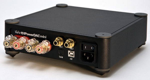

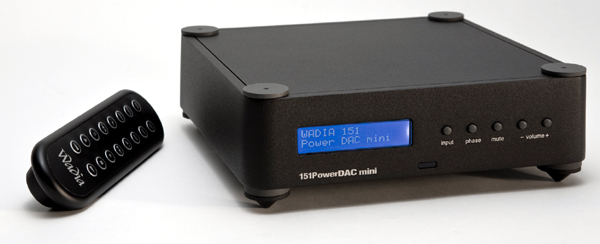

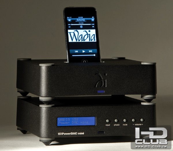

Wadia 151PowerDAC mini:不儘是DAC,更是部50W(4Ω)擴大機...
PRICE:
151PowerDAC mini: $1,195
Power: 25Wpc @ 8 ohms, 50Wpc @ 4 ohms
Inputs: four digital audio (USB, 2xSP/DIF-coax, Toslink-optical)
DAC Maximum Data Rate: USB—24-bit/96kHz, other inputs can accept up to a 24-bit/192kHz
Signal-to-noise: 103dB
Outputs: main speaker taps
Dimensions (H x W x D): 2.7” x 8” x 8”
Weight: 6 lbs.

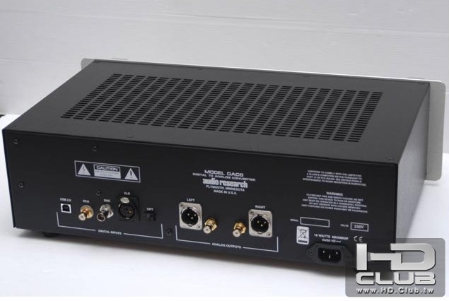

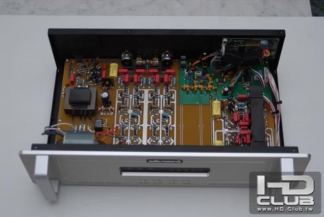

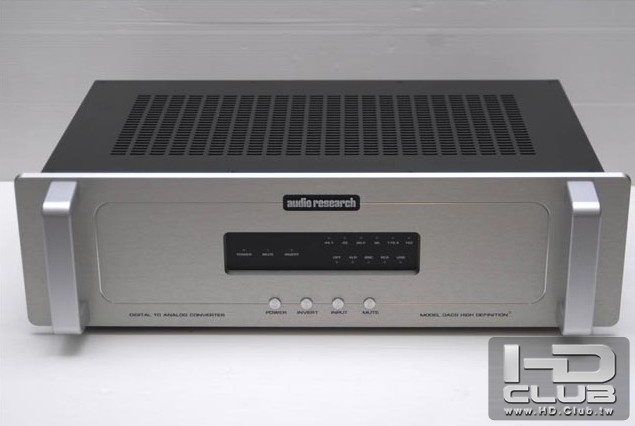

audio research DAC8: HiEnd大廠的正規軍
USB DAC支援24/192,全平衡架構、無負迴授、純晶體設計.
可惜沒用上真空管....
Frequency response        0.5Hz – 90kHz, +0 -3dB
20Hz – 20kHz, +0 -.15dB
Distortion        Total harmonic distortion: 0.015%
IMD + noise: 0.013%
S/N ratio        >114dB
Phase linearity
Channel separation        105dB
Resolution        24 bits each (quad DAC)
Output impedance        500 Ohms Bal, 250 Ohms SE
Analog outputs        Balanced XLR 6.6V RMS (16.4dBV) max.
Single-Ended RCA 3.3V RMS (10.4dBV) max.
Digital outputs
Digital inputs        USB 2.0 HS (480Mbps) 44.1 to 192kHz
RCA 75Ohms SPDIF, 44.1 to 192kHz
BNC 75Ohms SPDIF, 44.1 to 192kHz
XLR 110Ohms SPDIF, AES/EBU 44.1 to 192kHz
OPT 660nM Toslink Fiber 44.1 to 96kHz
Power requirements        100-125VAC 60Hz (200-250VAC 50/60Hz) 18W max, Sleep Mode 4W
Other
Master oscillator: 22.579mHz ±20Hz, for 44.1, 88.2 & 176.4kHz 24.576mHz±20Hz, for 48, 96 & 192kHz
Intrinsic jitter: <10pS
Power supply: 2 Transformers, 7 Regulators
Dimensions        19” (48cm) W x 5.25” (13.4cm) H x 10” (25.4cm) D. Handles extend 1.5” (3.8cm) forward of the front panel. Rear connectors extend .75” (1.9cm)
Weight        11.5lbs. (5.2kg) Net; 18lbs. (8.2kg) Shipping

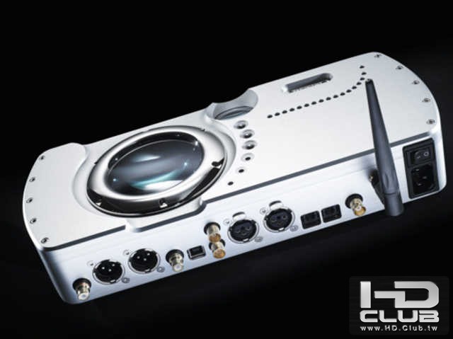

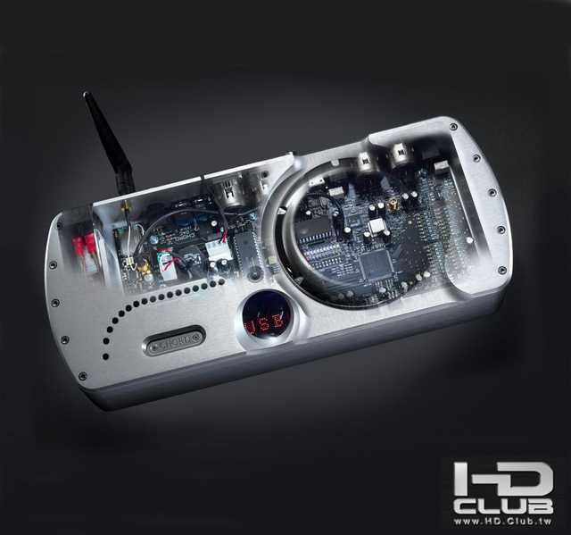

Chord QBD76:
聽說聲音表現相當狠毒,各國評論也是好評連連,不曉得透過USB的聲音又是如何?
規格
HARMONIC DISTORTION
< -103 dB (1kHz, 24-Bit @ 44.1KHz Sample Frequency)
< -110dB (100Hz, 24-Bit @ 44.1KHz Sample Frequency)
SIGNAL TO NOISE RATIO > 120dB
CHANNEL SEPARATION > 125dB @ 1KHz
DYNAMIC RANGE 122dB
SWITCHABLE DIGITAL
INPUTS
2 x 75 SP/DIF BNC Coax
2 x AES Balanced XLR Input
2 x Plastic fibre optic ( TOSlink )
1 x USB ( B type )
1 x Bluetooth supporting A2DP Stereo Audio ANALOGUE OUTPUTS
2 X RCA Phono
2 X BALANCED XLR
RAM BUFFER 3 Settings – off, minimum & maximum
PHASE SWITCH 2 Settings – Positive or Negative output phase
SAMPLE FREQUENCIES 32KHz – 96KHz Single Cable,176KHz & 192KHz Dual Cable ( Dual data mode )
OUTPUT MAX 6V rms. Balanced. 3V rms. unbalanced
OUTPUT IMPEDANCE 75 (short circuit protected)
DIMENSIONS IN MM 338 x 60 x 145mm (Width x Height x Depth)
WEIGHT 7 Kg

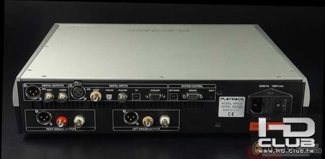

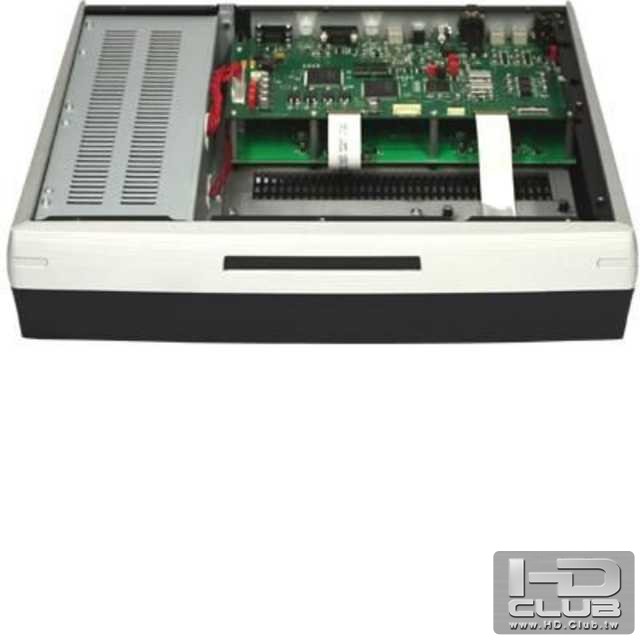

Playback Designs MPS-5的USB不能支緩24/192, 稍後該公司會推出一個硬件upgrade :
原本Playback Designs的5系列(MPS-5 SACD/CD唱盤與)MPD-5數位類比轉換器,它們的USB數位輸入僅能接受標準的48kHz/16bit音樂信號,如此一來不就被新推出且價位僅約一半的3系列比下去了嗎?別擔心,因應3系列的上市,Playback Designs也會推出5系列的「升級轉換盒」,透過它5系列的USB輸入就能提升為384kHz/24bit PCM與6.1MHz DSD聲音信號對應!
(自影音部落)
The USB add on will be available in April. We have not set the price yet, but we should know in the next few weeks. It is a 4 x 6 x 1 box that will use a proprietary connection which will only work with Playback Designs products.
~ Playback Design

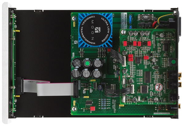

我聽過第一台W4S~~MOON 300D!!
但這次是發300D的弟弟100D的使用心得
Moon 100D,規格就是300D的簡化!
ㄧ個同軸輸入,ㄧ個光纖輸入,ㄧ個USB輸入,ㄧ對類比輸出!!
晶片與300D是用相同的!!USB缺點也是相同!!
電源使用上是最大可惜,是AC電源!!
大小約一個男生的手掌大小!!(有黑色和銀色)
這台網路資訊較少!!
因此PO一下小弟的不才心得
跟某老闆借來使用心得如下:
用文聲CDP同軸輸出至100D,100D拉類比至文聲擴大機,喇叭SA 505!!
線材除了同軸線外都是用銀線材!!
使用Moon 100D搭配文聲後,加強了文聲的厚度!!空間包覆感也增加了!!
高音部份個人感覺沒有很大的差異,主要還是空間感和厚度的增加!!
這是個人小小心得!!
